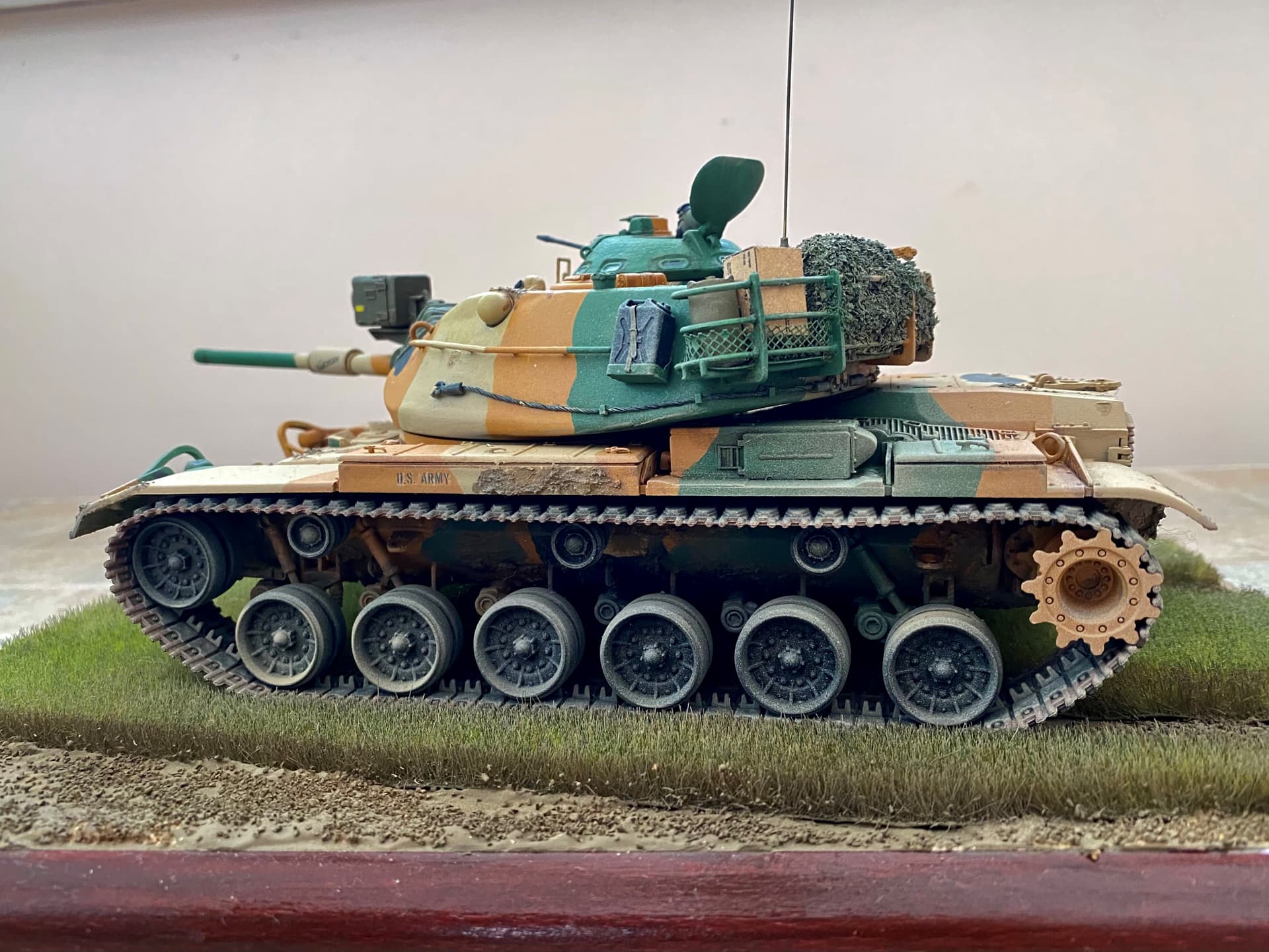

I had a go at replicating this vehicle some considerable time ago and here’s a few pics:
I am not suggesting that I necessarily have it right but it was a fair match for both the Squadron/Signal pic and the images I found on the www. I still, mostly major in enamels and think the colours I used were:
Base colour of sand for which I used a Tamiya rattle-can “Deck Tan” then painted the other colours using Humbrol enamels, 88 Deck Green, and for the “orange” Humbrol 62 leather. Black of course, was just black(!)

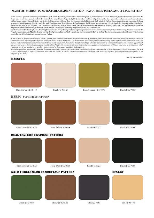

Most applications of MASSTER – which were normally hand-painted on the real thing, were less garish, and there is a very good Tankograd publication on several US colour schemes:
The Tankograd book also conatins a colour chart and for what it’s worth I’ve copied it here:
'Hope this helps; I must just stress I’m not suggesting you need to purchase the Tankograd book, or even change whatever paints you have, but it might help clear up the question of “orange”.

Thank you, Brian, for all of the great info. One – I hadn’t noticed that the kit markings are those of the tank on the cover of the In Action book. Two – I don’t have that Tankograd book in my ref. library, but now have it on the way from BNA Model World, who have good prices and reasonable shipping here to the States.
As the color chart you provided shows, that MOL color AFV Models calls-out is actually Rust Brown, and I agree that Humbrol 62 Leather is a pretty close match (I too have that in my stock). I didn’t mention earlier that the kit paint chart also calls-out Humbrol 82 which actually is named “Matt Orange Lining”, but again is, IMO, way off.

I was unaware at the time of my build that Humbrol Orange Lining existed - perhaps it didn’t back then; however, for most MASSTER-finished models (ie those not quite so garish as “Smokin”) I’ve used (again enamels) Humbrol Forest Green, which I think is 150, and their matt Rust 113 again using the Tamiya Deck Tan as a base.

No need to apologize! I appreciate finding new relevant ref material. And I also have Humbrol 113 and agree that it’s right in there with the subject Rust Brown / Errant MOL.
