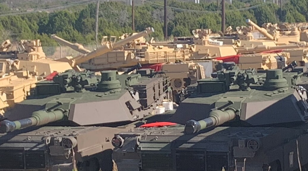

Not to be a jerk, but the color that looks right to you is the right color. You will go crazy trying to figure out what is right by asking everyone on here. OD is the chameleon of colors. If all of us, say 20 , built an OD tank, or the same jeep as you , there would be 20 different OD greens represented. WHo would be right? all of us probably in some aspect.
I don’t think you’re being a jerk. In the end, what you say is true and it’s up to the individual to say what’s right for them. Old photos from Nam show a wide variety of colors in the same shot, due to paint batches and time in fading light. For me, I know the color I’m looking for and I want to get as close to that as I can. My models will never be entered in any competitions let alone be judged so I’m only pleasing myself. My full-sized M-37 was in a few competitions and not one judge ever commented on the color. That could mean the color was correct or it could also mean it was close enough not to matter. It didn’t matter to me, I took 1st place and I was happy with the way the color presented.
That is pretty cool dude. You would have to be close enough or correct. Like you said there are so many pictures with each one looking a little different. I wonder how much is our eyes themselves, as we all see colors differently…

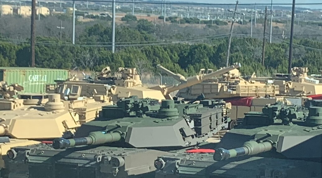

Indeed. May as well use these photos one more time, taken seconds apart:
