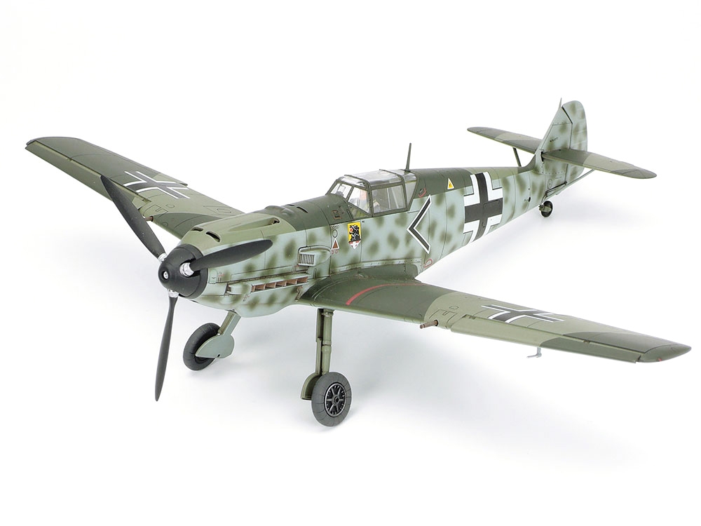

Surprisingly it’s also recommended for the exhaust tips on a BF109, when every pic I see shows those as rusty/oxidized steel, like any exhaust that’s not fresh out of the factory.
Here’s their own pic - for that exhaust I’m assuming the gunmetal base was applied then a thick rust enamel wash? Almost seems just as efficient to paint it rusty the dry brush it gunmetal?

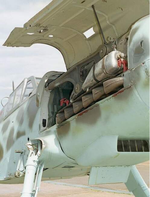

Most of the museum pics and running models seem to have just a bronzish/rusty sheen or just sooty

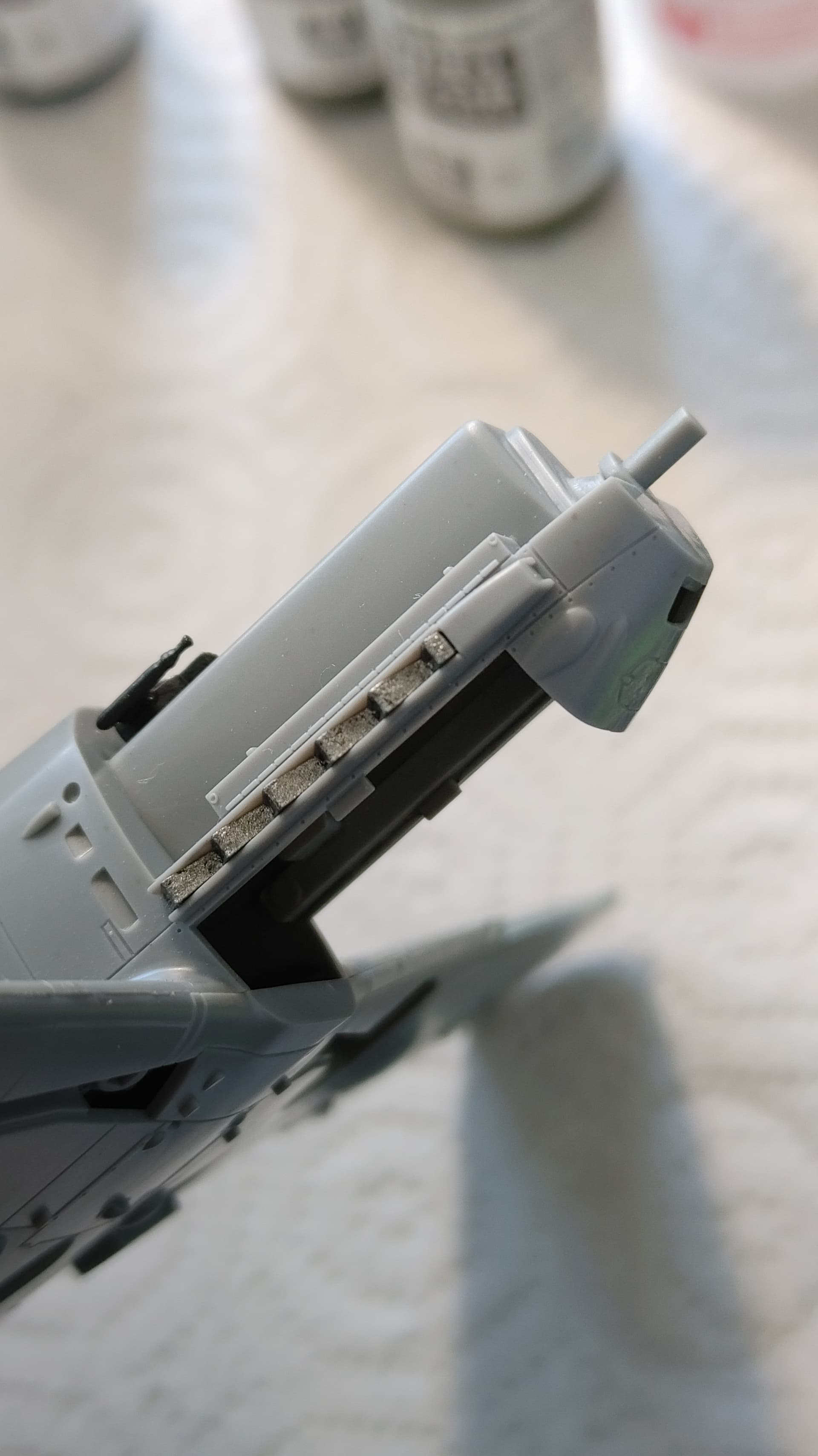

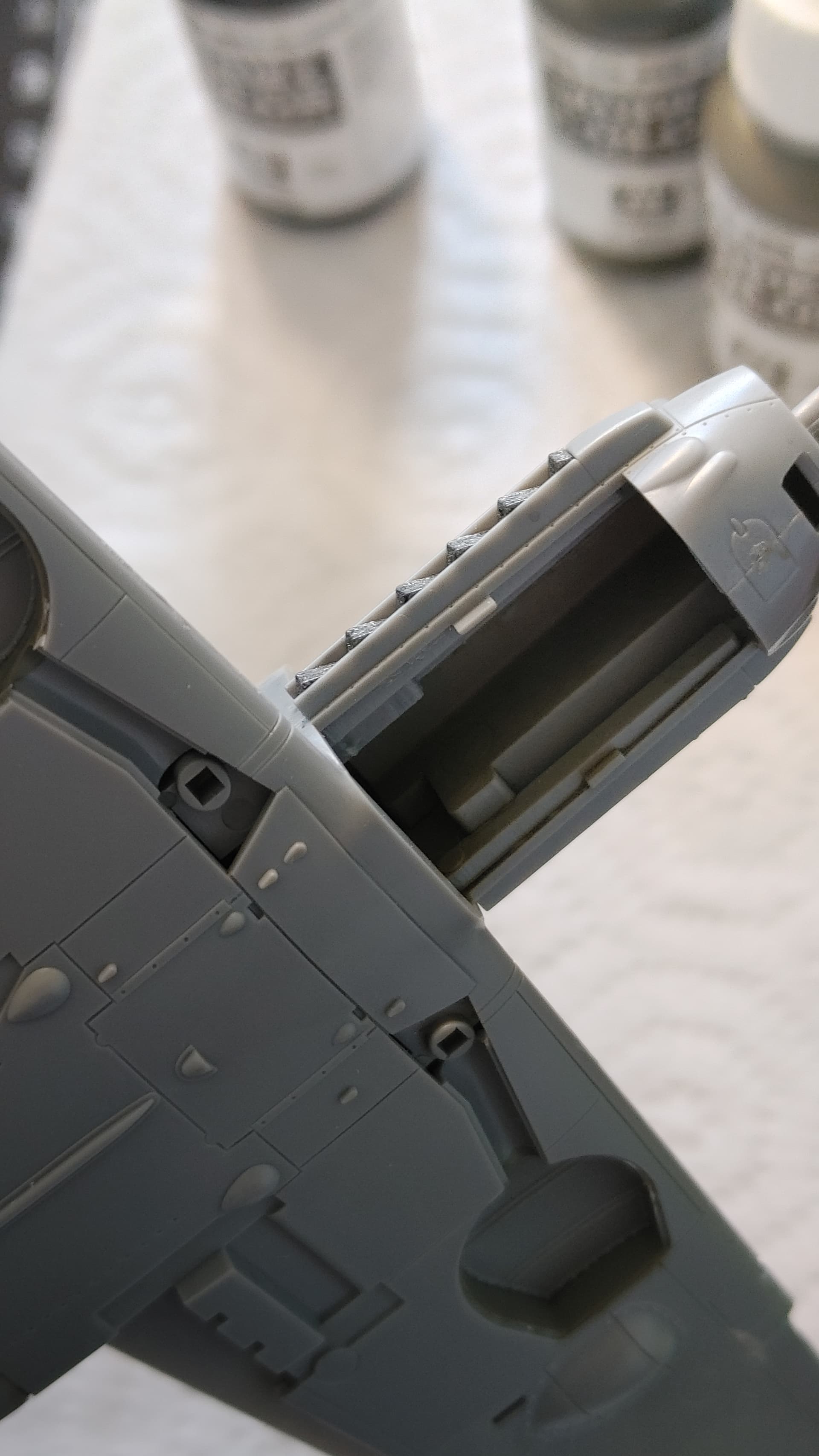

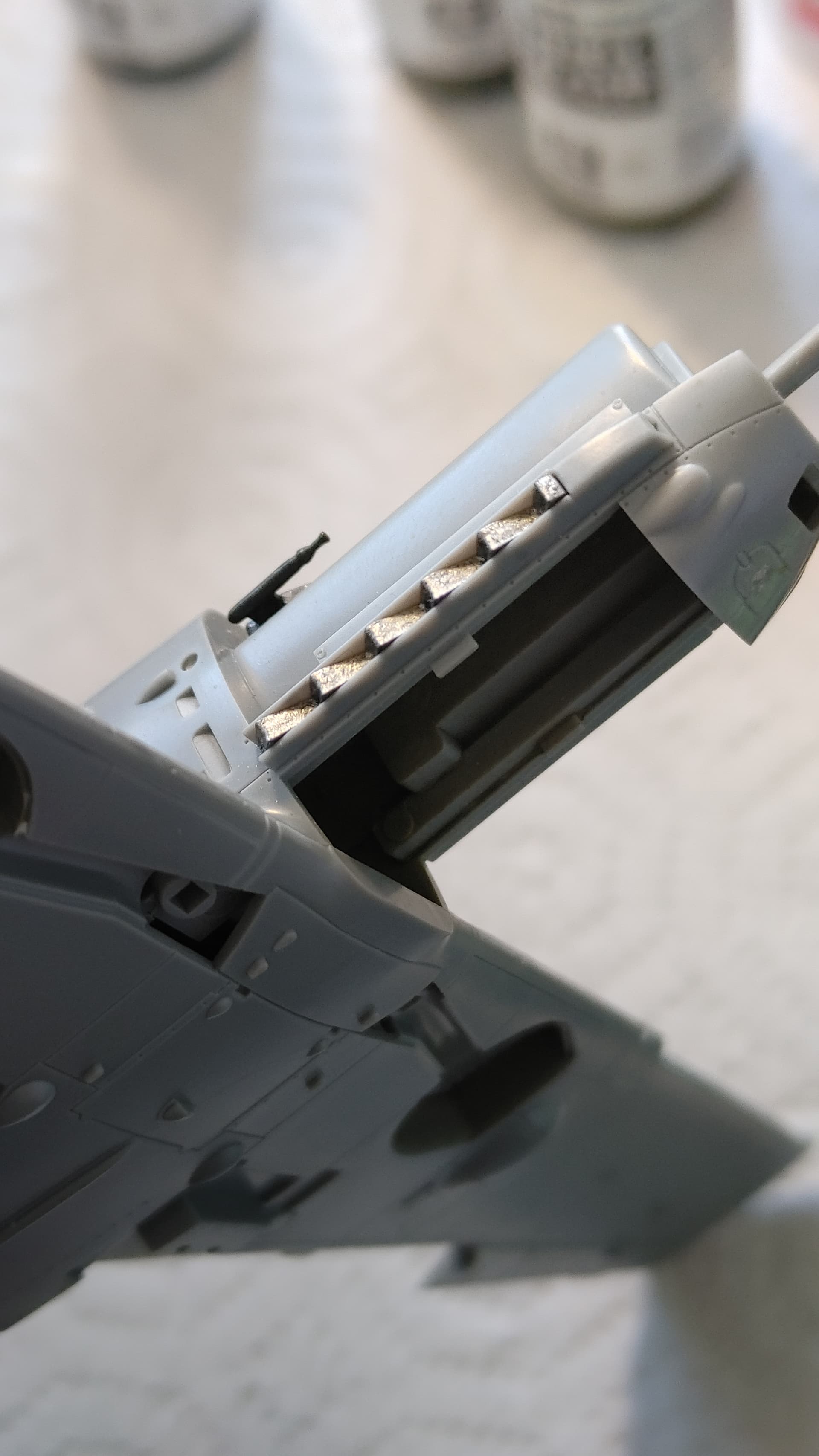

Here are some I recently did with Vallejo black primer then X-10 Gunmetal
