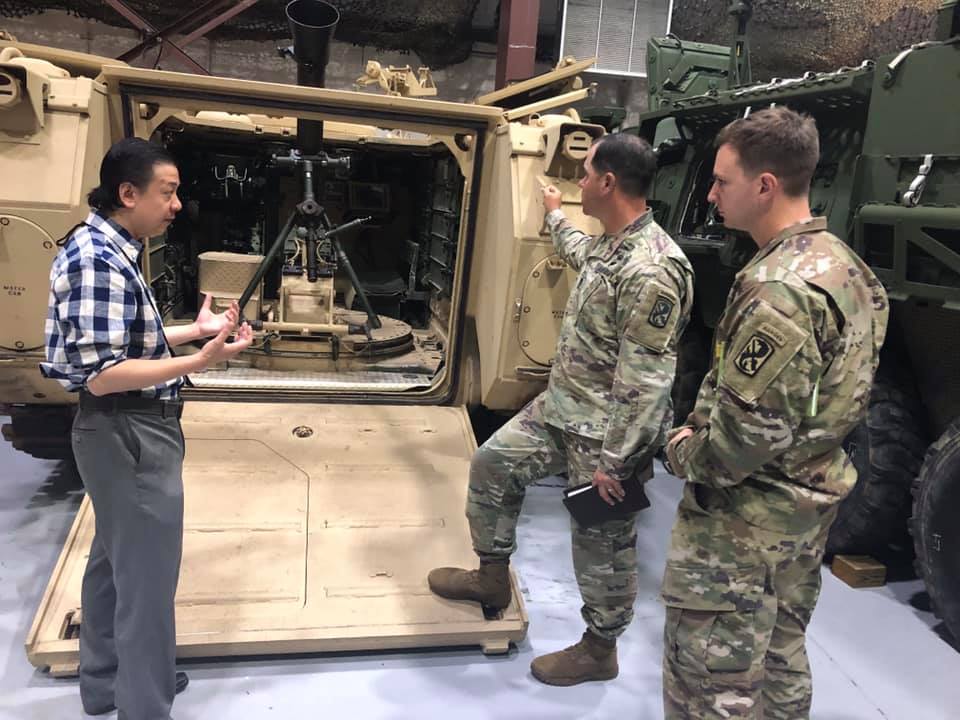

It look like the same set up as in the M1129 stryker mortar carrier
It is in fact the same one.
That will make things easy except having to by a Trumpeter M1129 just for the mortar assembly

Yes, read up further in the thread (Frenchy’s post a few up). They use the same mortar that is in the Stryker Mortar Carrier, different than what is in an M1064A3.
AFAIK, all the pictured mortars are based on the Soltam K-6 but the mount differs from one vehicle to another

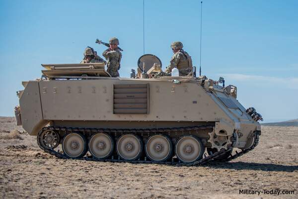

Here’s what it looks like in the M1064A3
https://en.wikipedia.org/wiki/M1064_mortar_carrier
https://en.wikipedia.org/wiki/Soltam_K6
