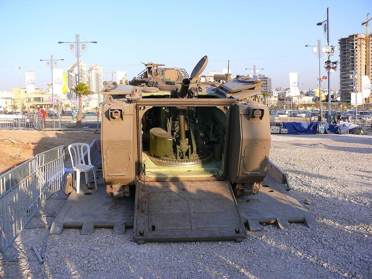

If I were to build a IDF M106A3 what mortar would I need the kit supplied 4.2 in or does the IDF use a 120mm?
Looks to be a 120mm, basically an M1064A3 Mortar Carrier.
120mm, like Gino stated.
The mortar is the Cardom (Hatchet) which is a heavily-modified Soltam K-6 120mm mortar. Here’s one belonging to the Philippine Army
Mere info here.
