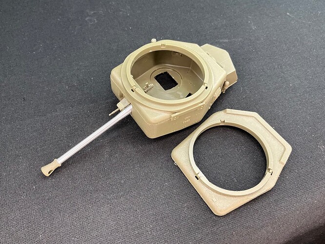

Next to the constructed turret is a second lower part that comes with the kit — namely, one for the Mk. IV. The difference in height between them isn’t that obvious here, but the next photo shows it well:
My first problem was the get the lower turret part off. Happily, the previous owner didn’t use that much glue, so that I could get the right side loose with a heavy-duty knife and some care (both for my fingers and the parts), but I had to saw through the left-hand side. More stuff broke loose in doing all of this, but that’s not an issue:
This lets me show the difference in height from another angle too:
