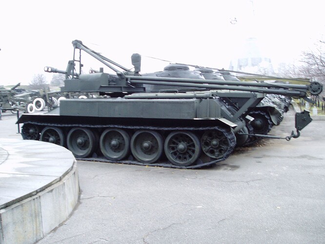

Now this one I didn’t see before - must have been relatively rare… Where was it used?

Caption says its at the Batey ha-Osef Museum Rob ? @Robert_Goldman
The museum closed a couple years back. Most of the armor went to latrun they say but who knows where most of the stuff ended up cause I sure didn’t see it at latrun on my last visit

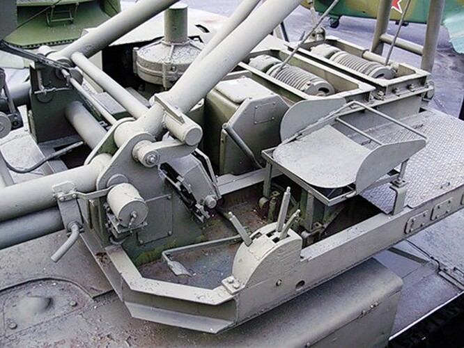

A little bit about your question, this crane tank was used in the repair units for tank technology. It was mainly seen during larger troop movements. Here is a picture of a field repair and of a scrapped SPK-5.
Now for the construction of the model, the platform for the crane was built onto the vehicle. The large gear is firmly connected to the hull and the platform can be rotated 360°. The crane is powered electrically, for this purpose a generator is built into the tank hull. Now for the construction.
