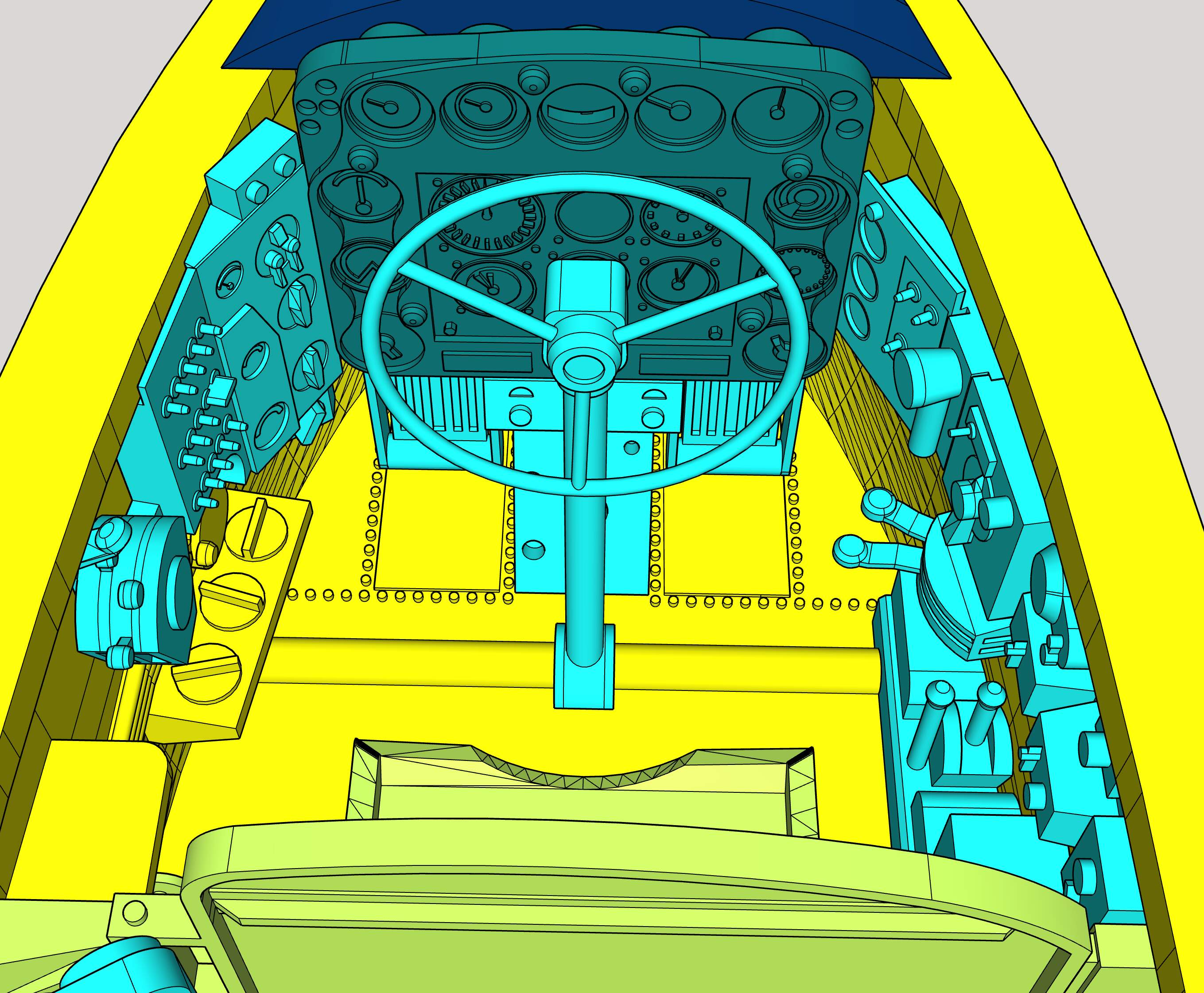

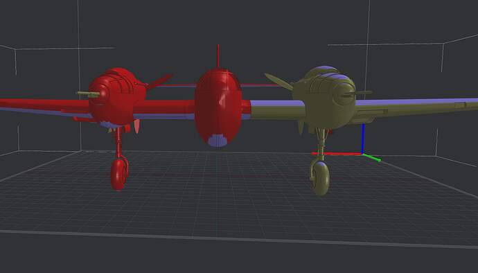

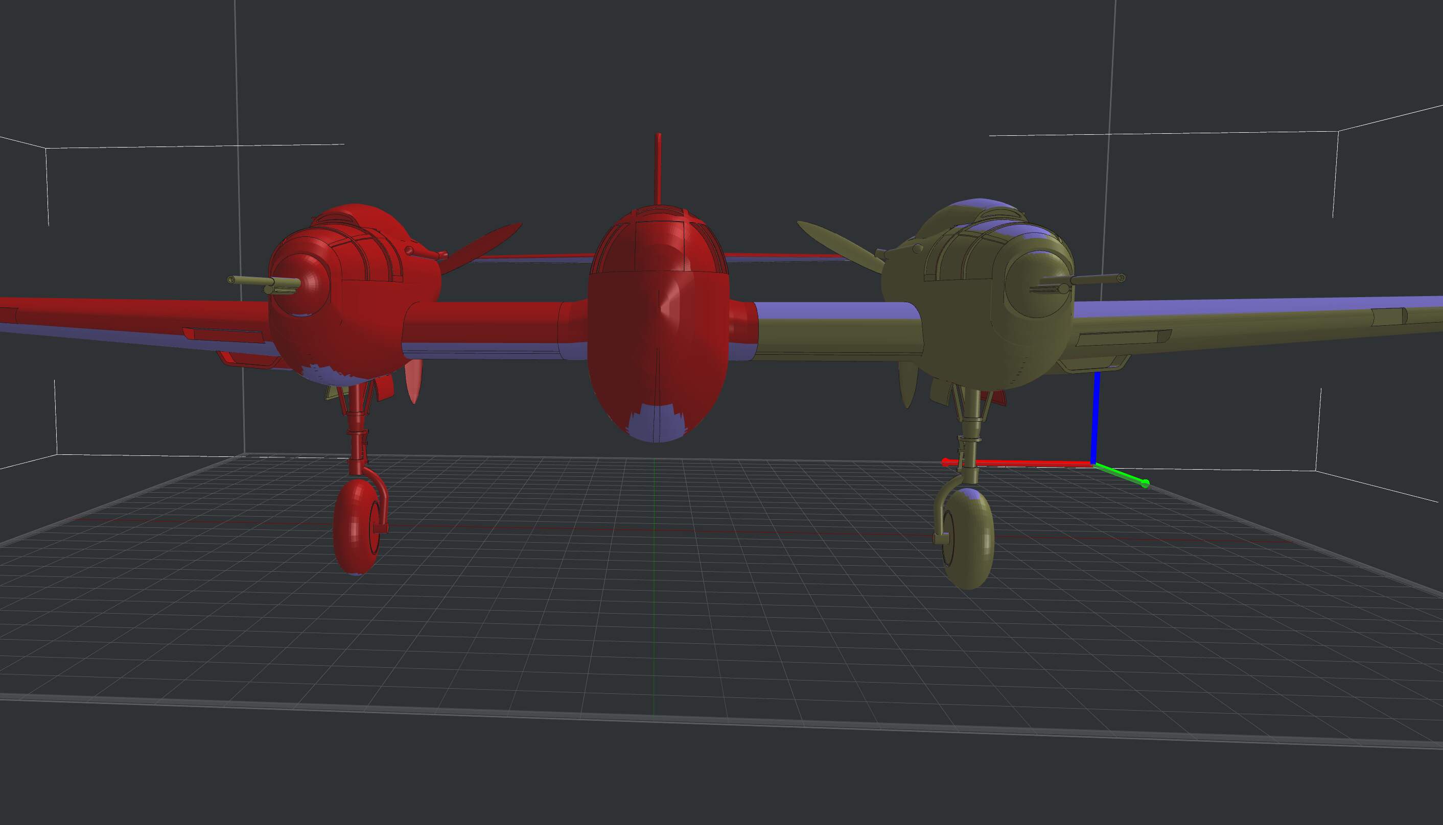

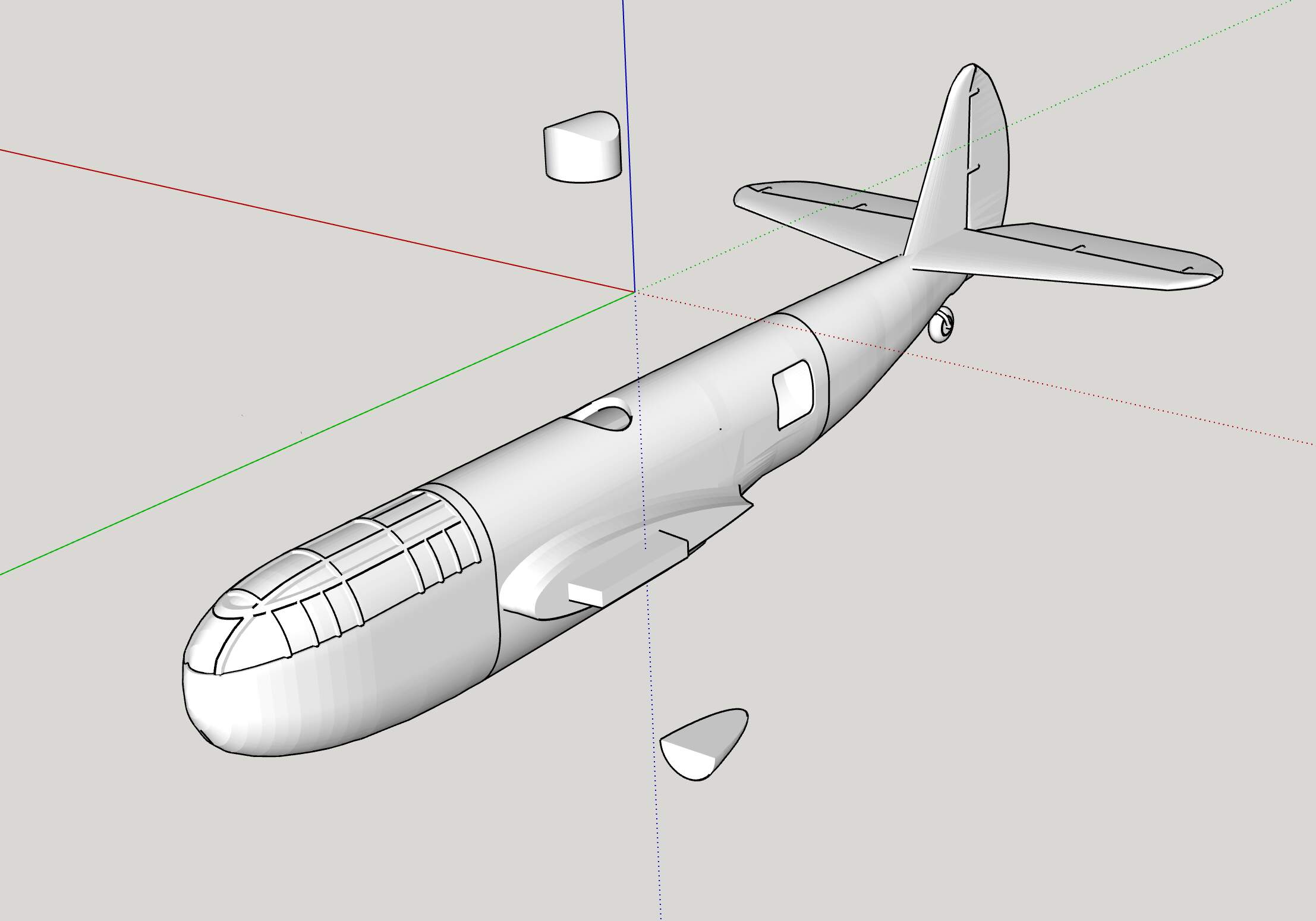

I arrived at the bell airacuda, a great idea if you don’t think about it too much. The last few months I’ve been tinkering on 3D printable model and finally have an end in sight. What better time to share the progress? Just have the gunner positions left to model and it’s off to the liquid goo phase!

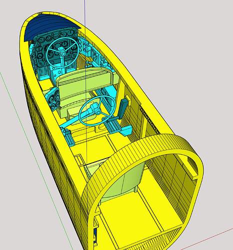

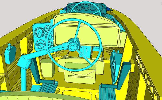

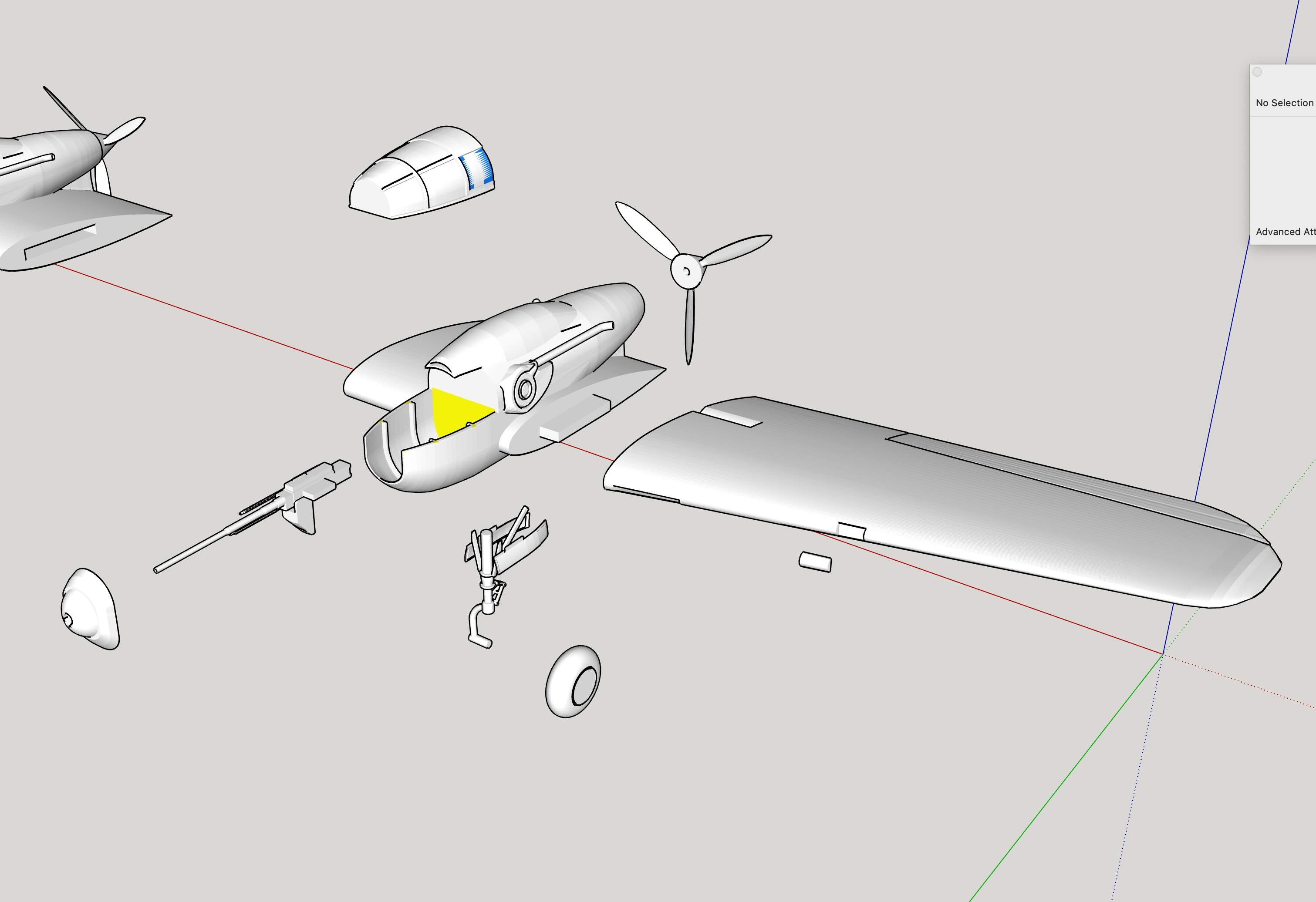

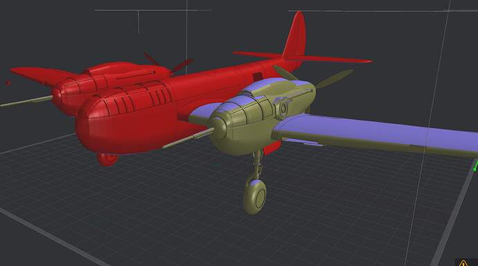

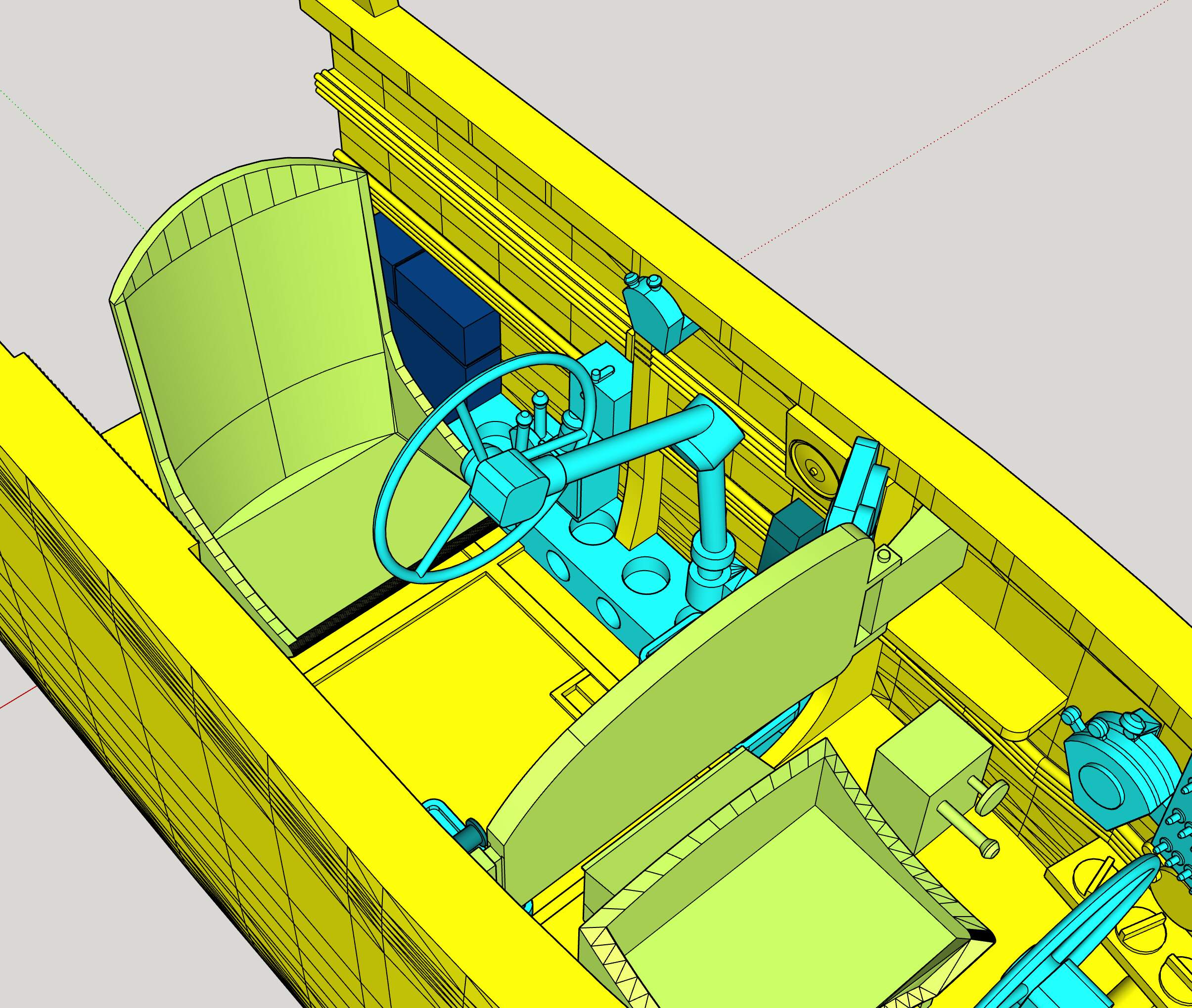

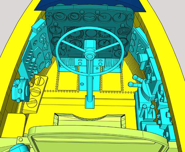

Here’s a few more teasers as I complete the gunner areas. In hind sight, picking a plane with basically 3 cockpits was a bit ambitious.
I am itching to start printing though as the fuselage, landing gear cockpit, molds for vac forming the glass and outer wings are pretty much ready to rock.

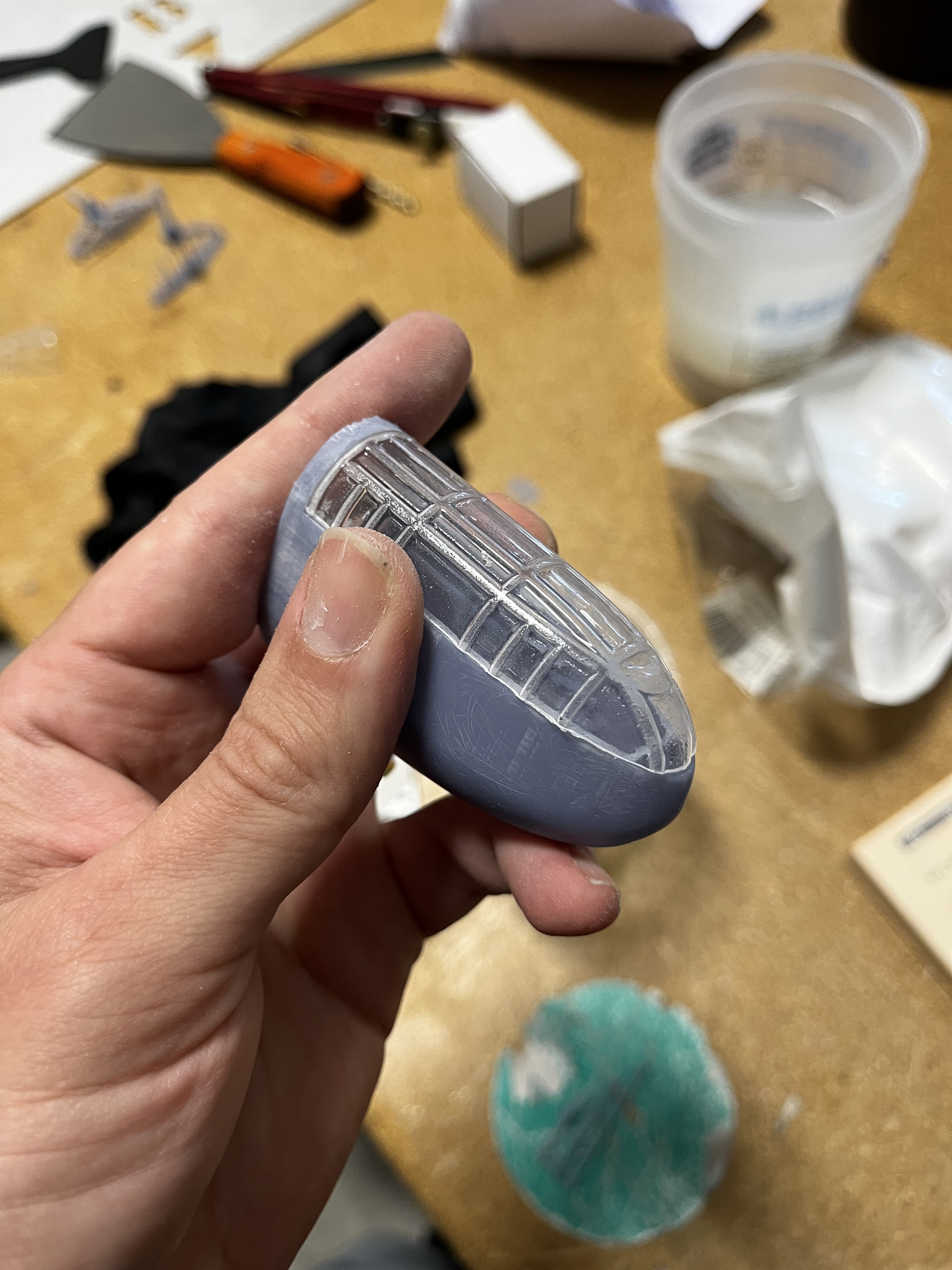

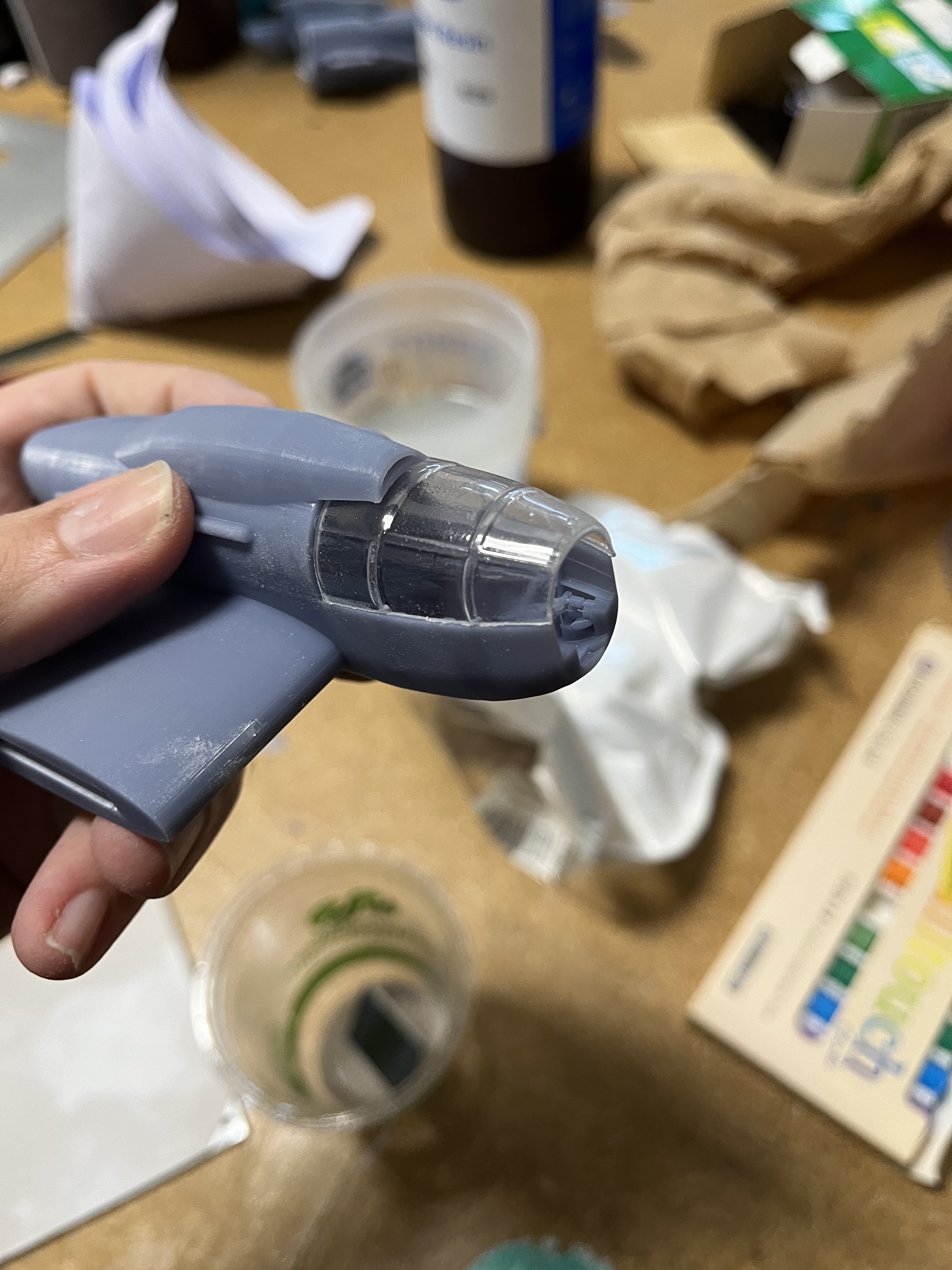

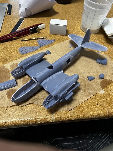

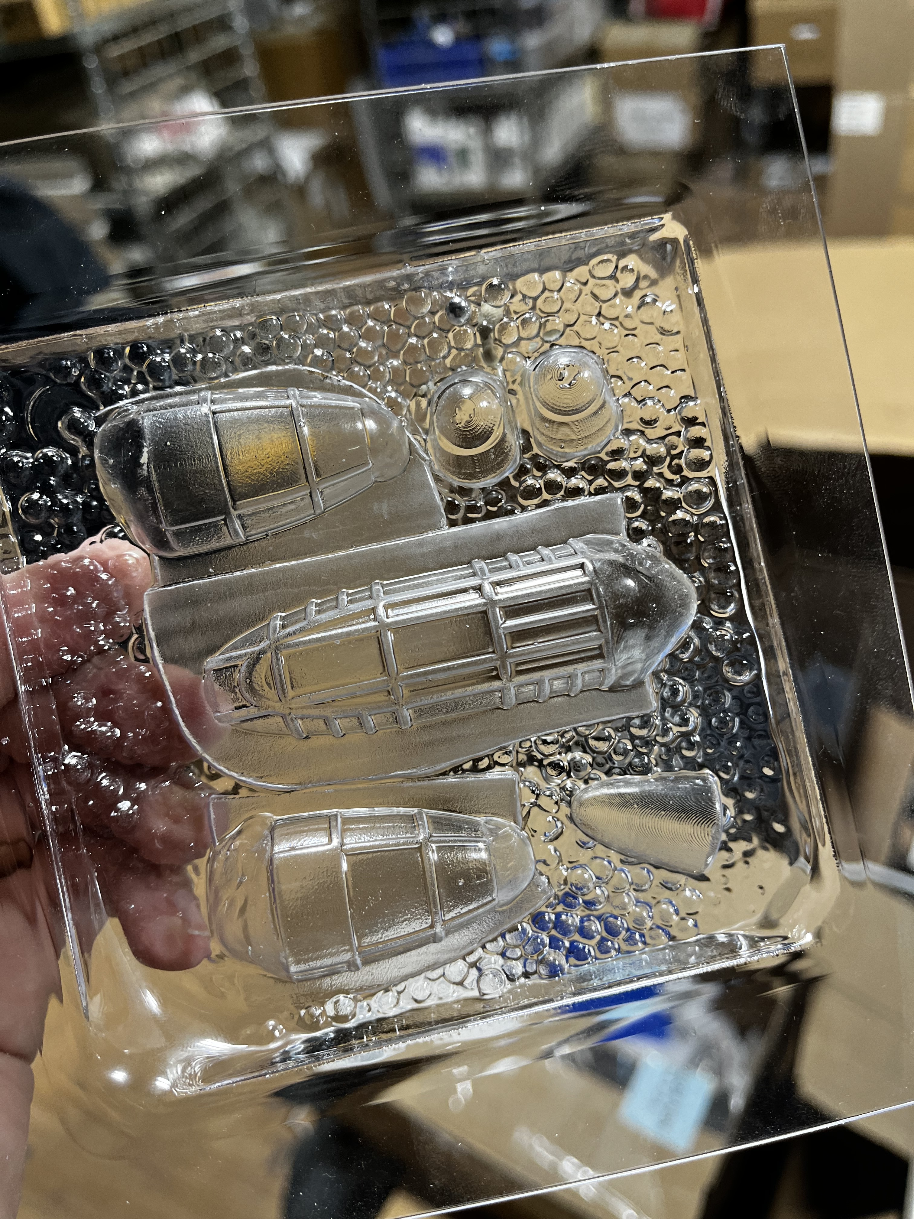

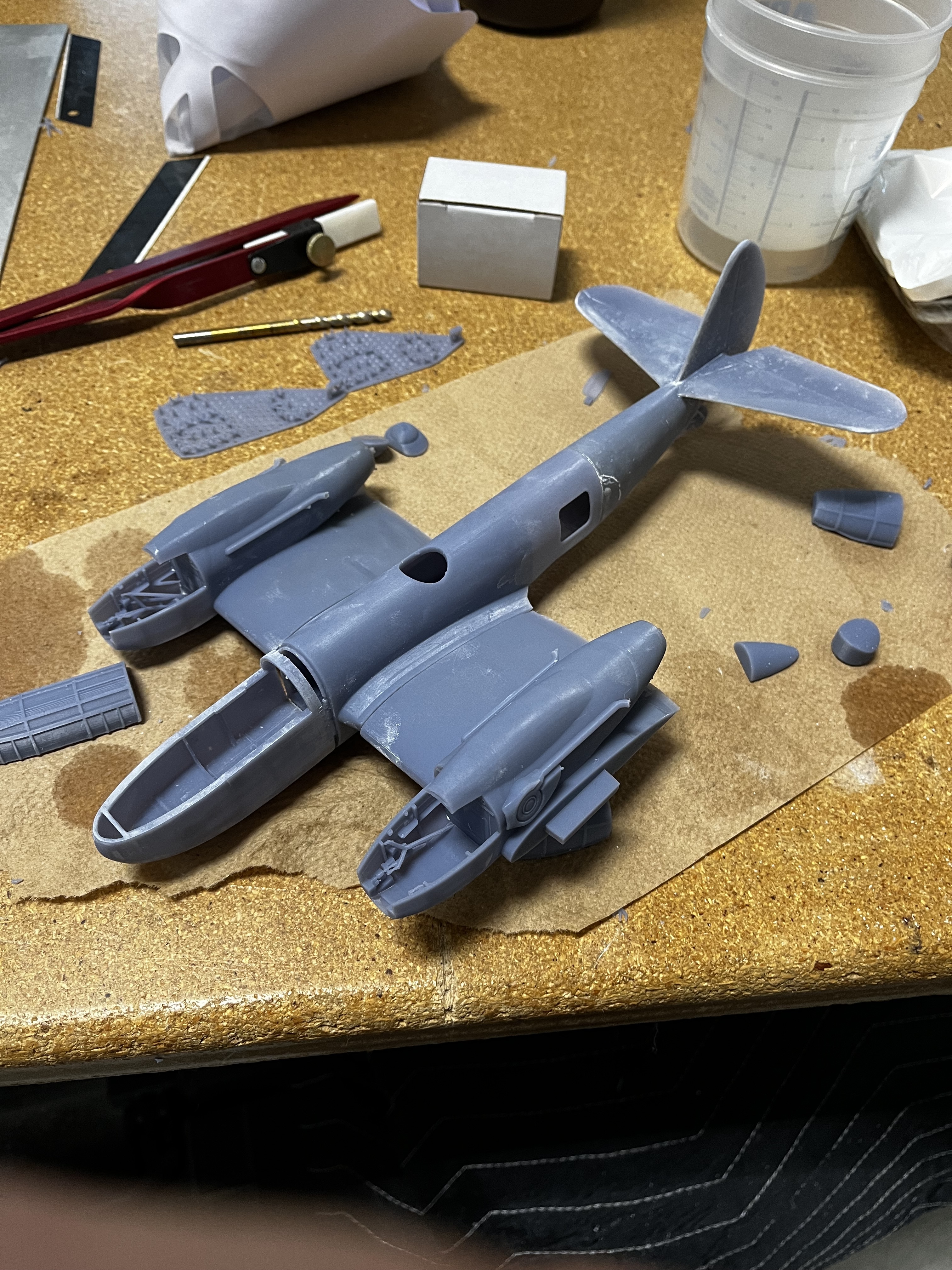

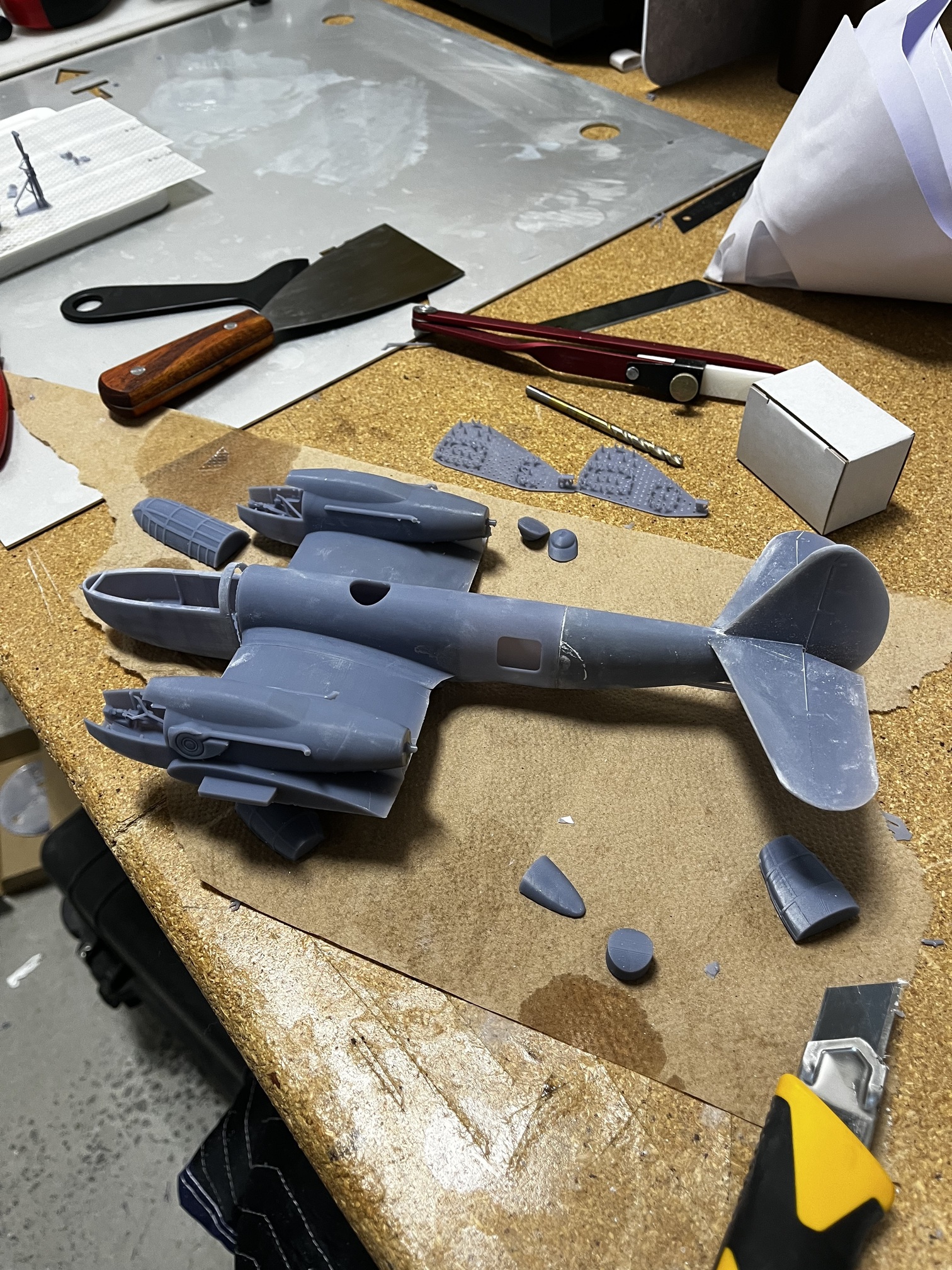

It’s entering the physical world! Got the first round of printing done and did a test pull on the canopy forms. Needs some tuning but pretty happy so far.
Looking pretty impressive so far … Canopy came out nice …
Thanks! Yeah I got another set of canopy bucks printing now for final pulls, gotta polish the heck out of them for maximum clarity. Thing that shocked me was the guess of 0.020” compensation for material thickness was spot on!
Now I’m thinking of printing the whole plane (exterior) in sections that I’ll convert to vac molds. I’ve got a crazy amount of .060” styrene sheets at work from test prints and fudge ups (work at a very large print house) at least that way I can justify to mountain of work that goes into surface details like rivets and panel lines on the resin.
