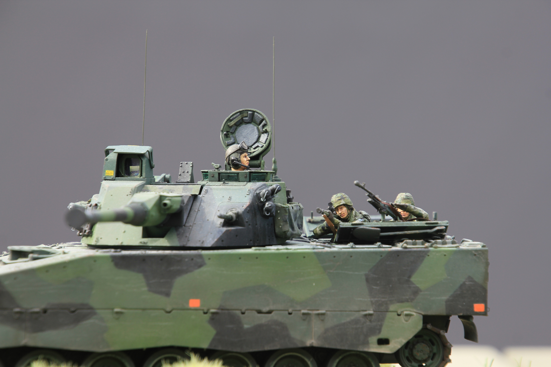

Its time for some Swedish stuff. Here is my attempt to depict an exercise (no live ammo), -an ambush scene where a group, partially on foot is on defence. The kit is a kit bash between the HobbyBoss and Academy offering, both having some drawbacks… -the most obvious being that the turret of the Academy kit is way too small, while having the best detailed hull.

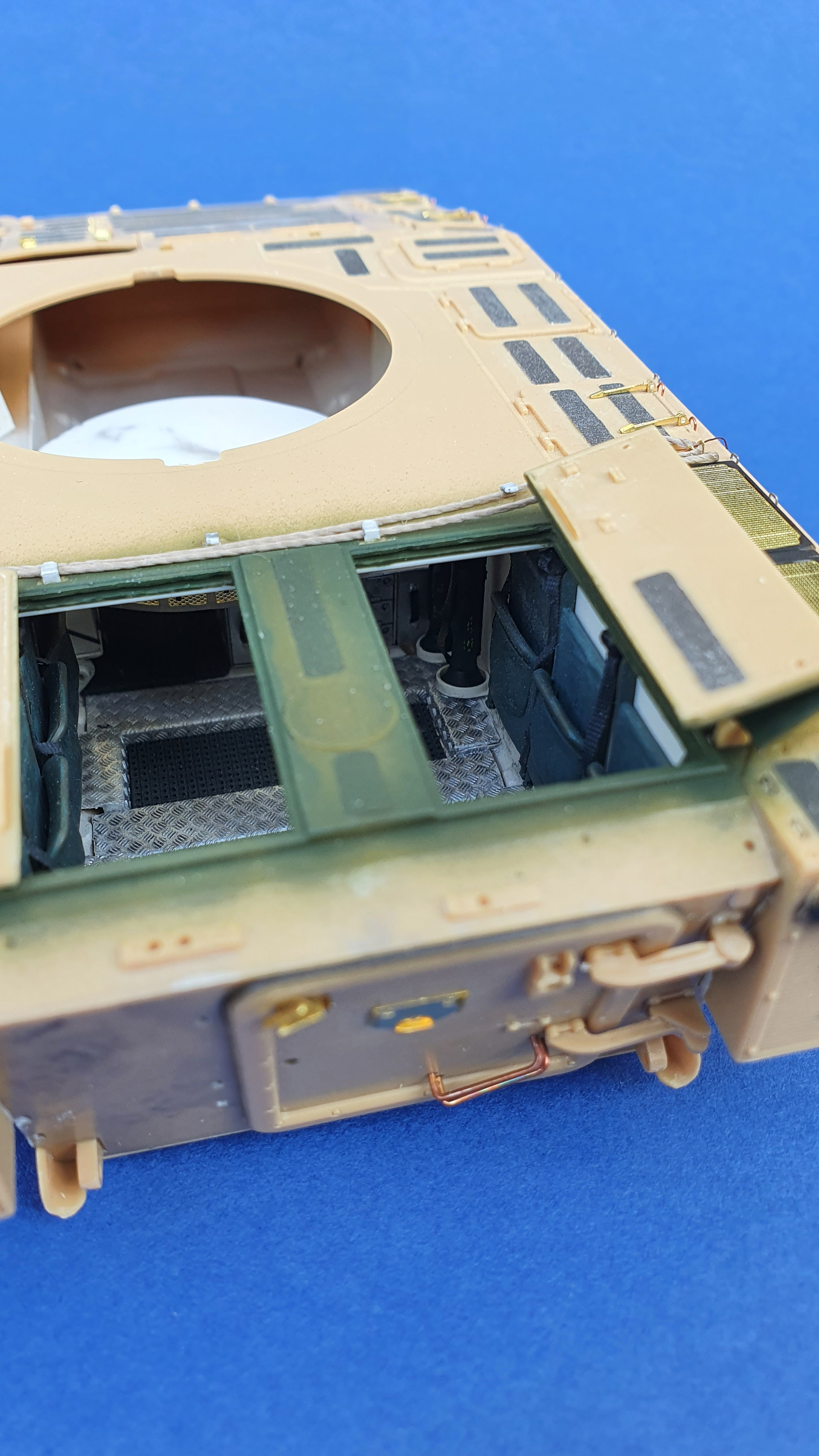

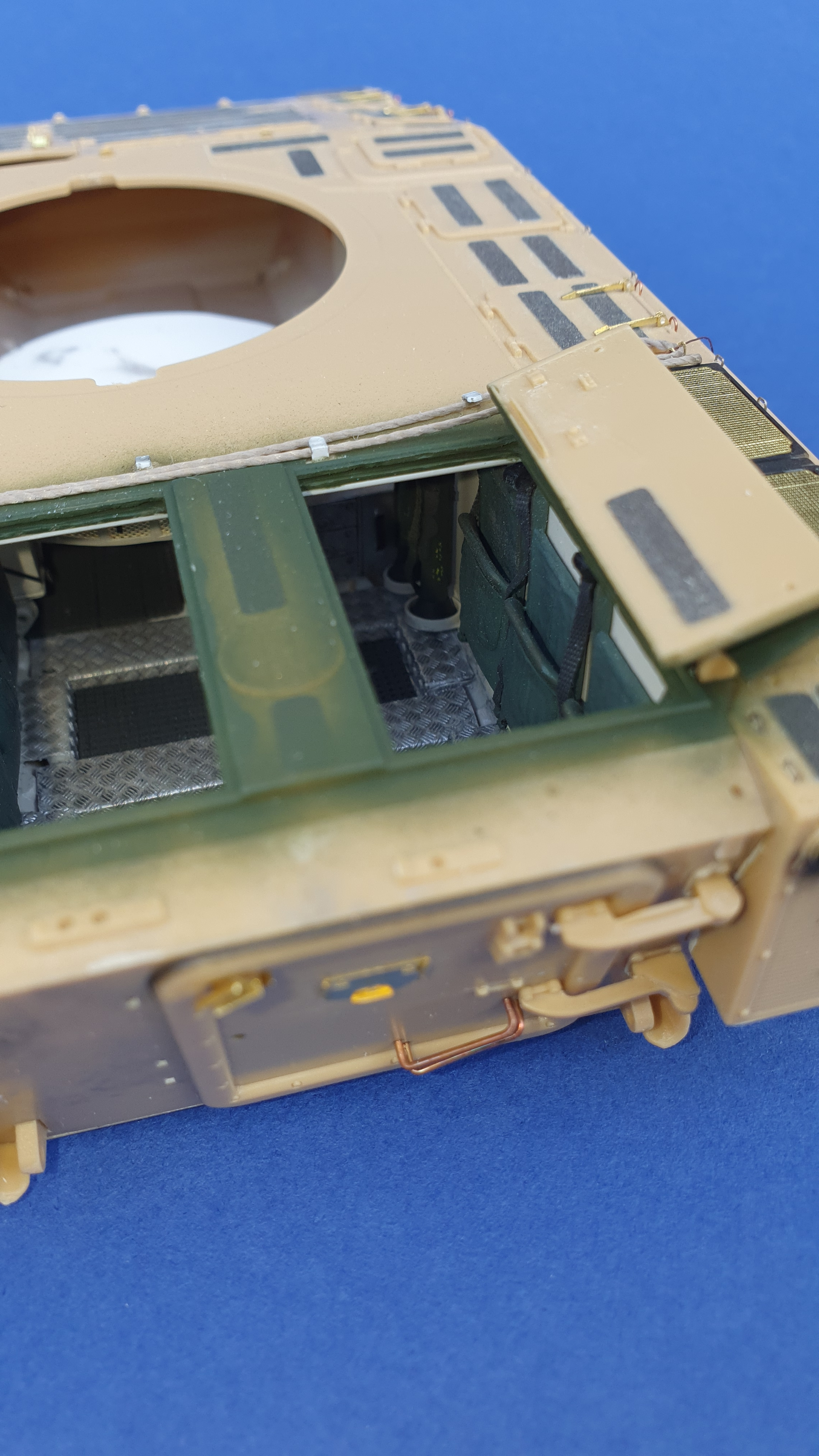

None of the kits have interior so this is scratch built.
-to be continued.

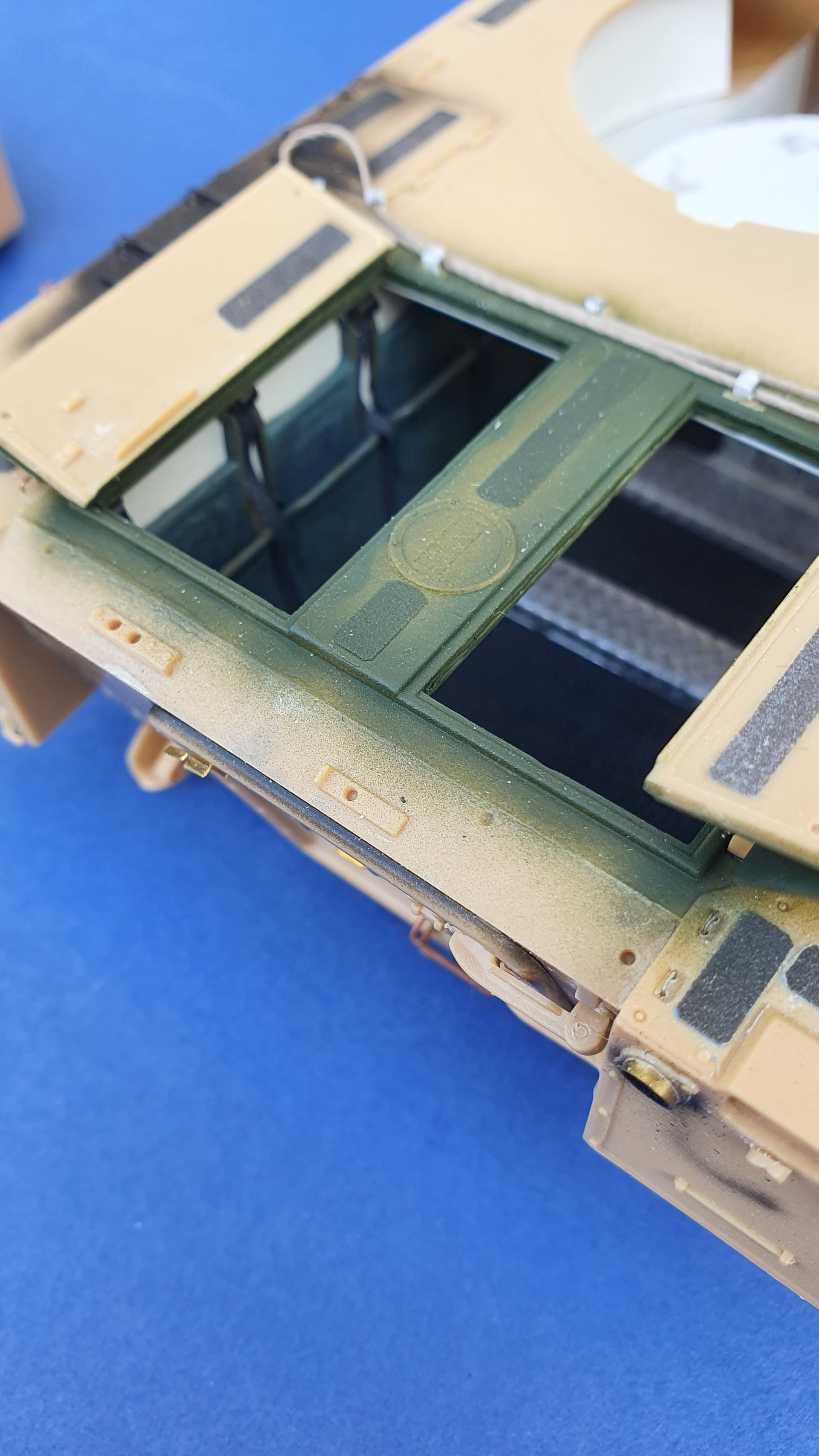

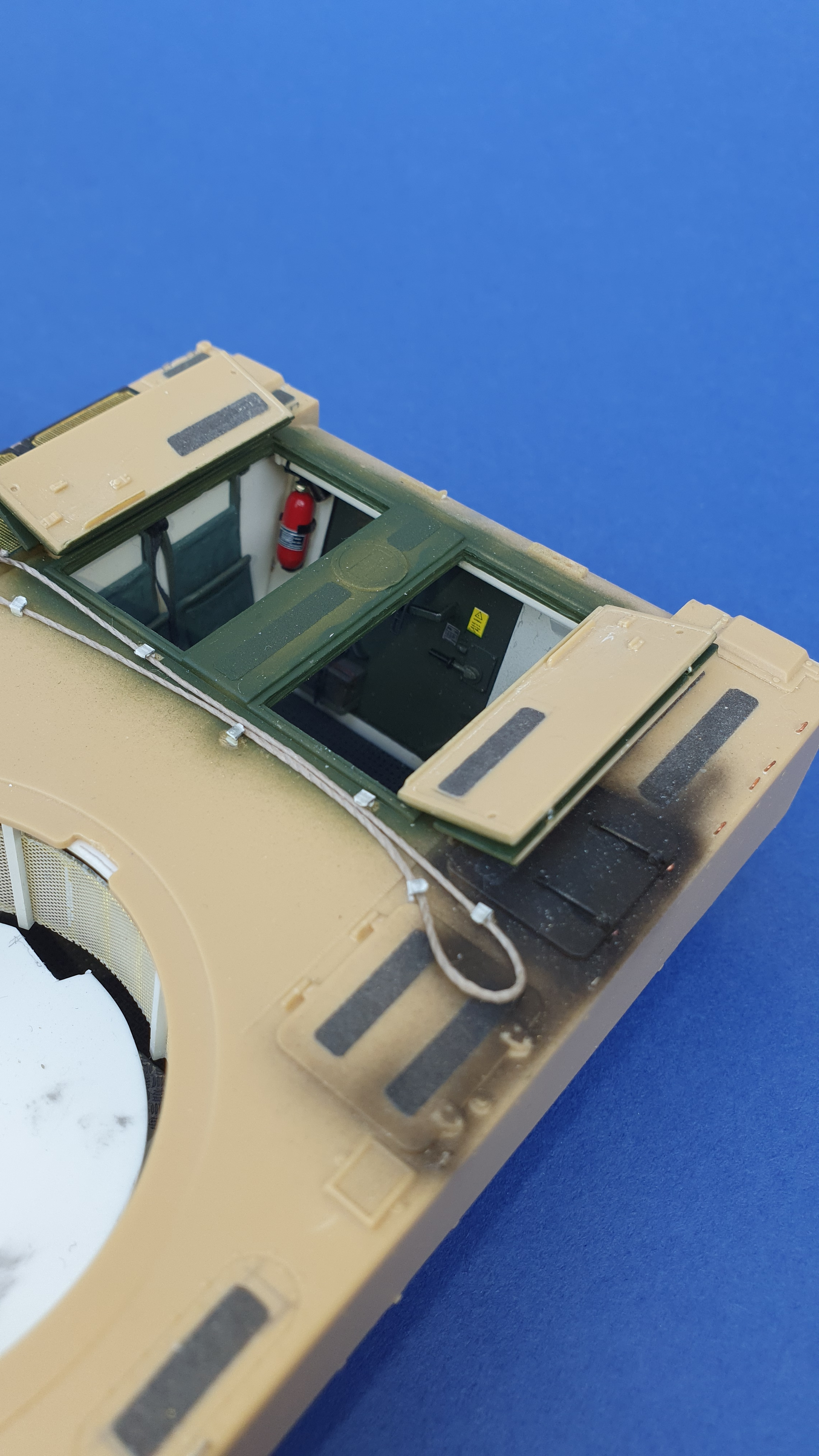

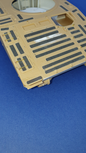

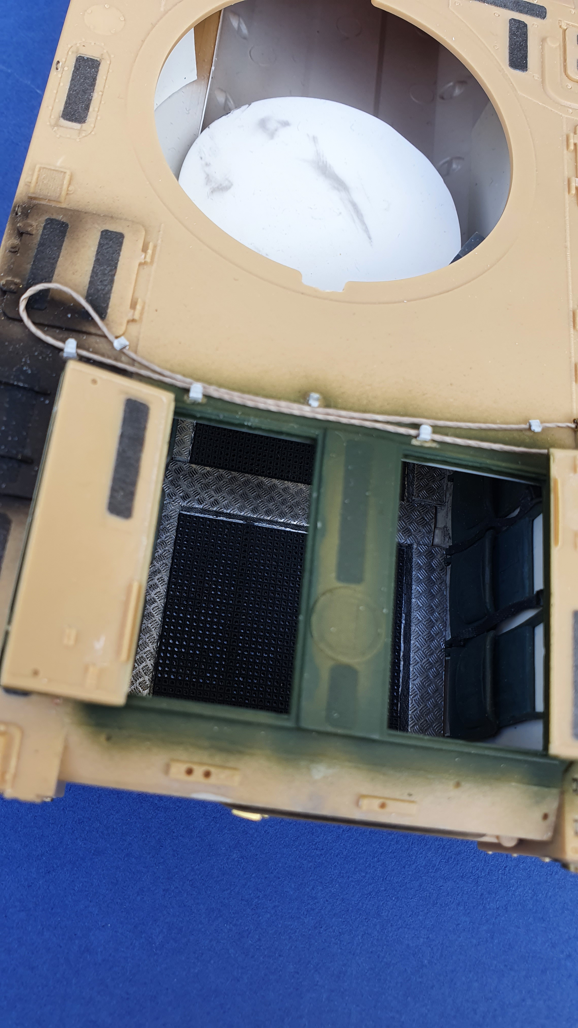

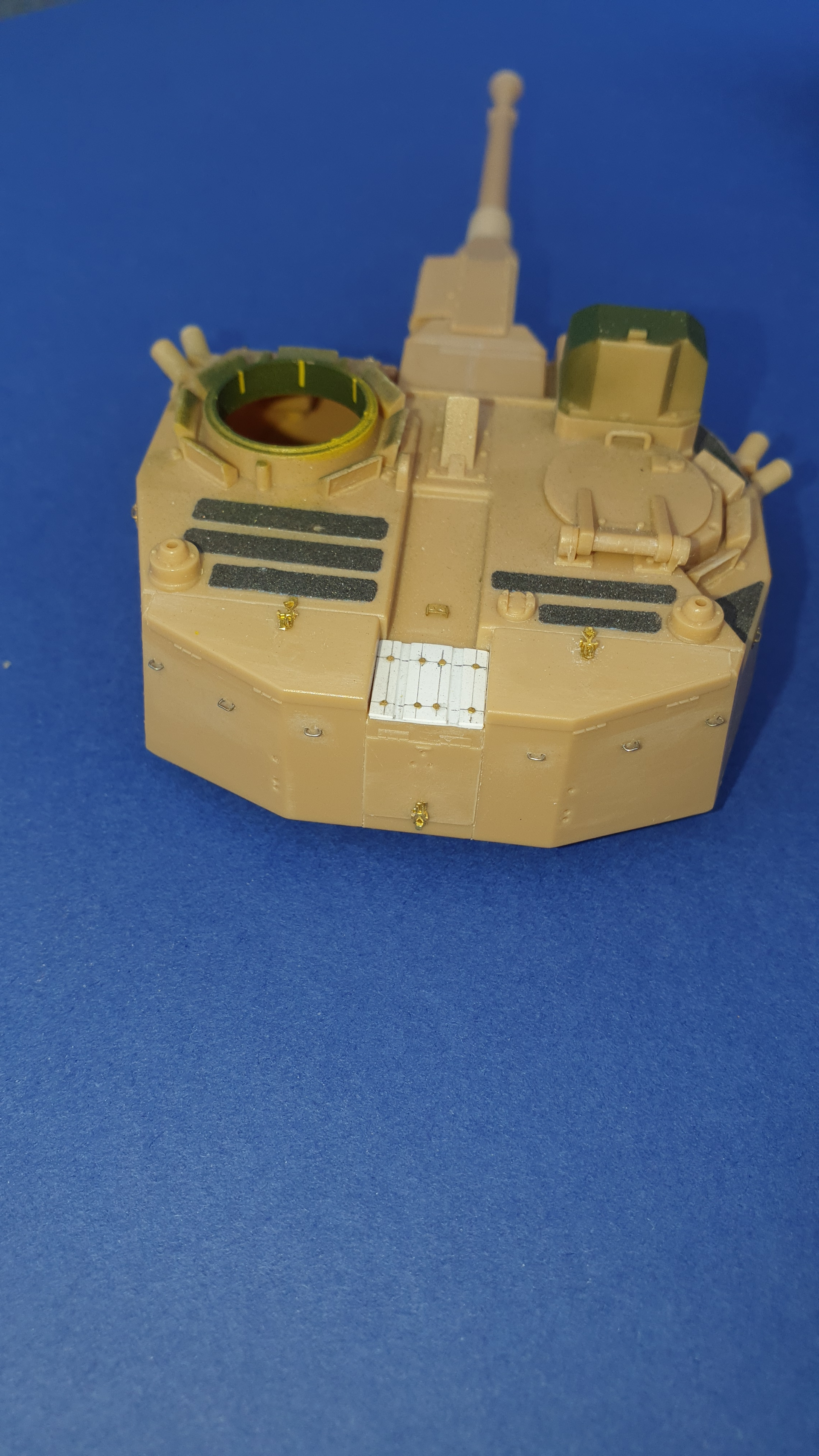

The bonnet / hood is molded with details on the inside resulting in sink marks on the outside. I removed all antislip and replaced it with 400 grit sandpaper with the paperbacking removed.

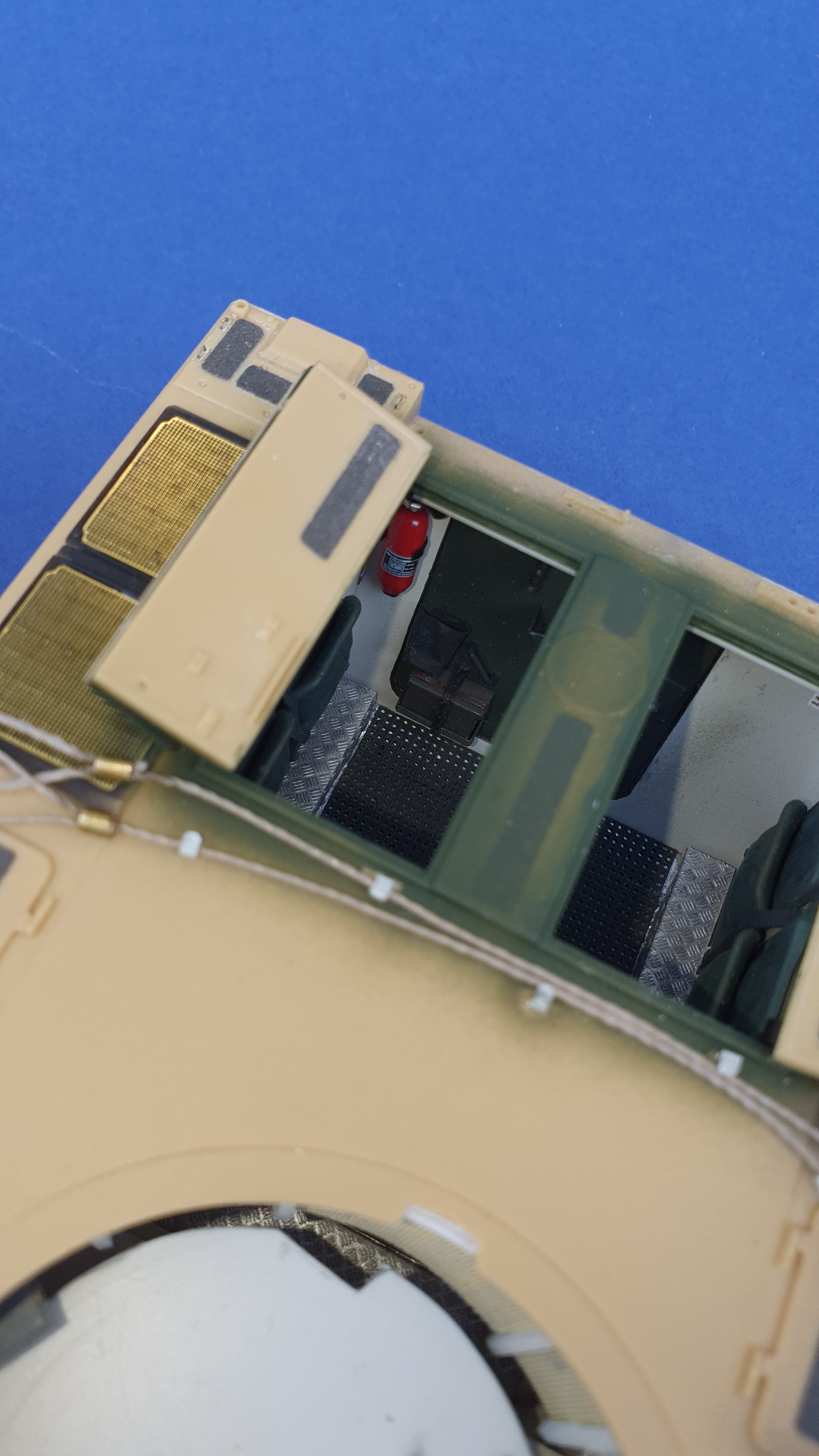

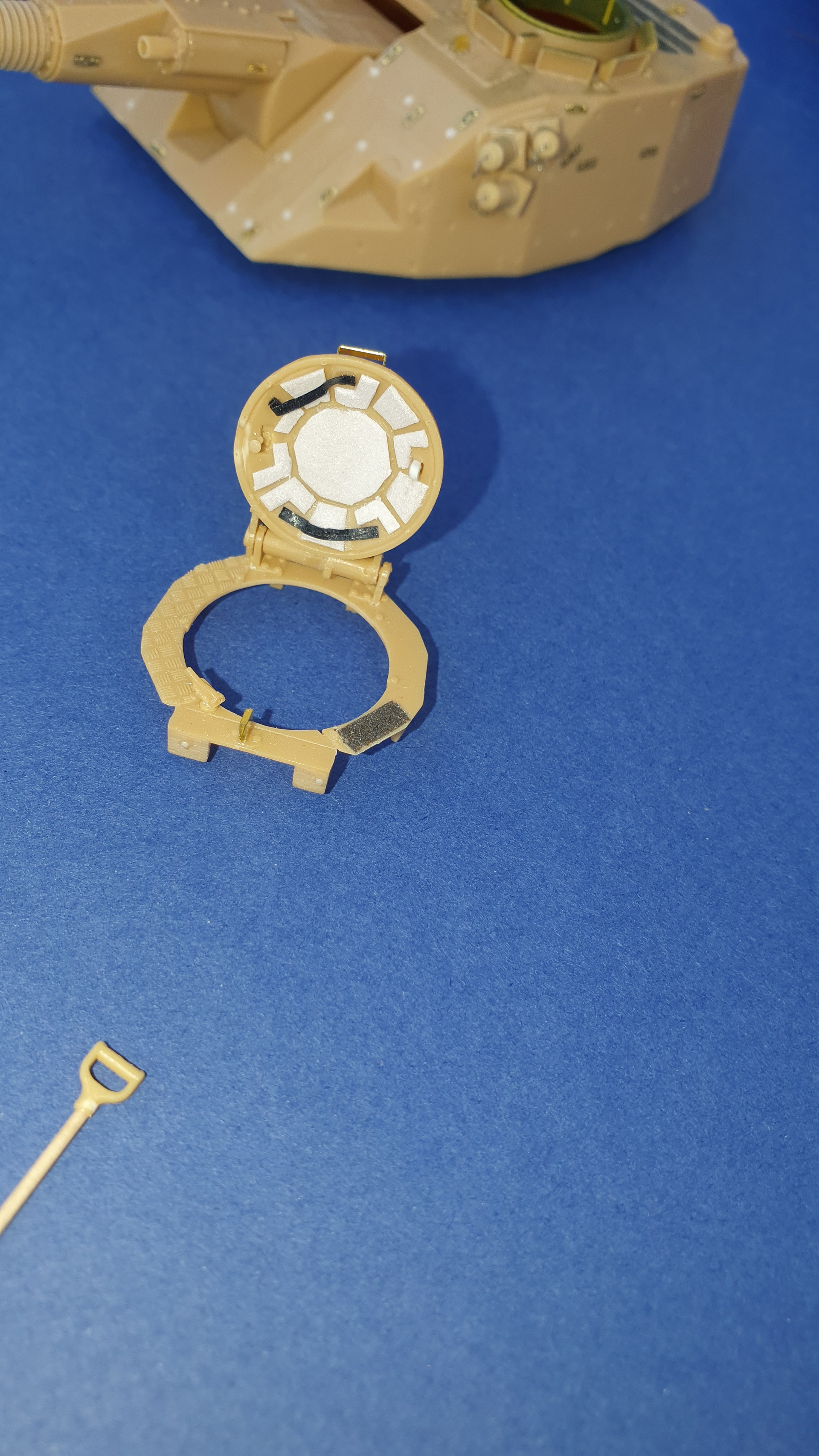

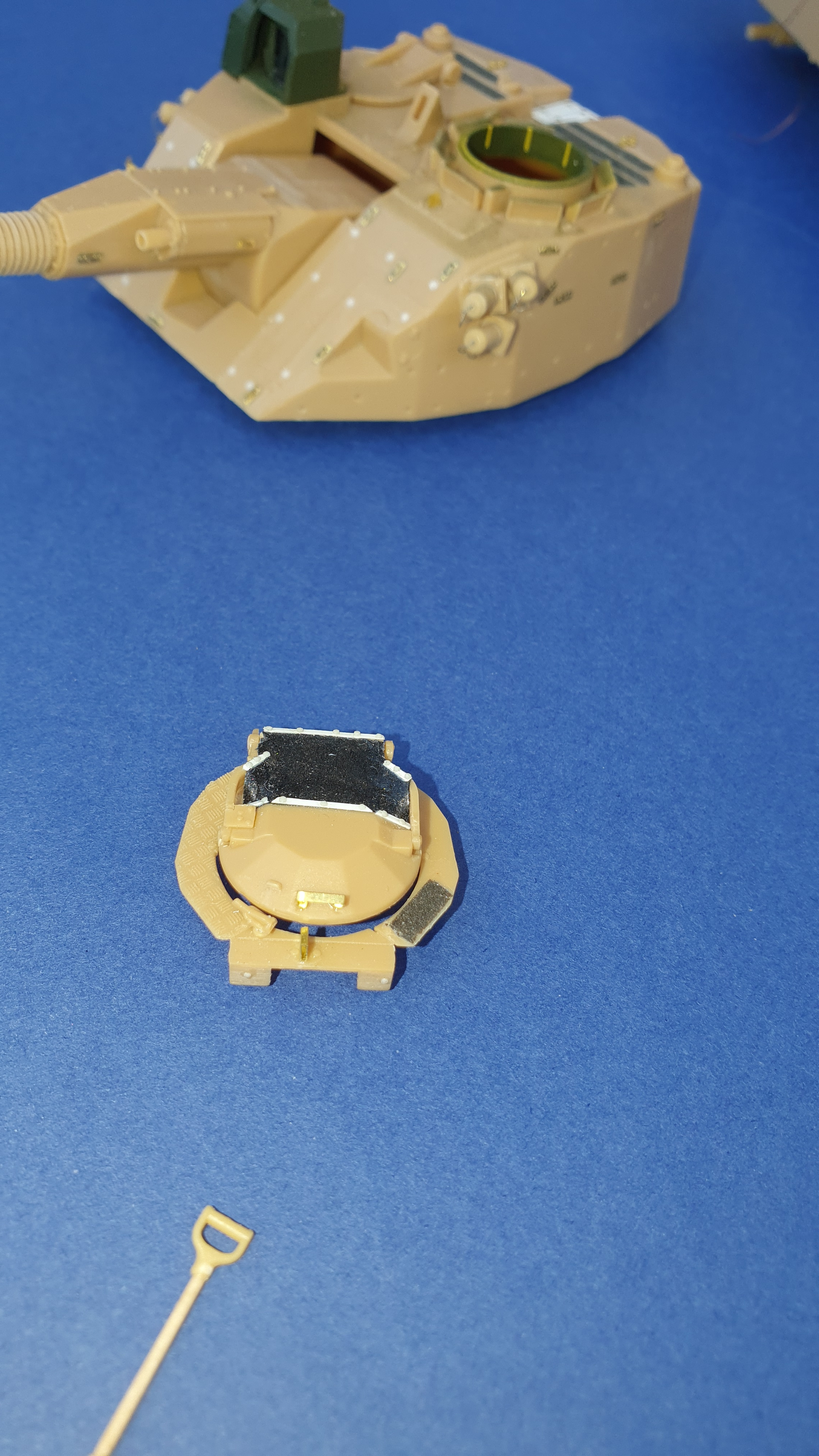

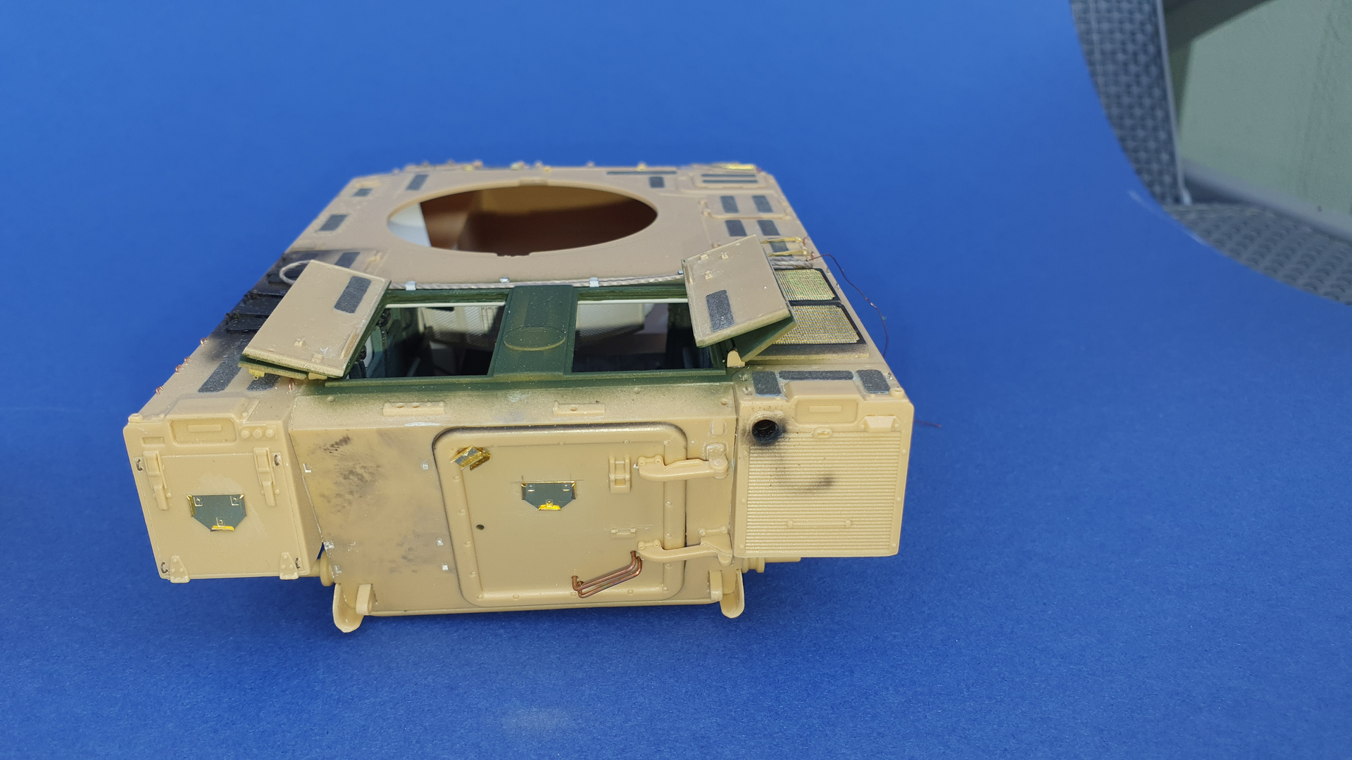

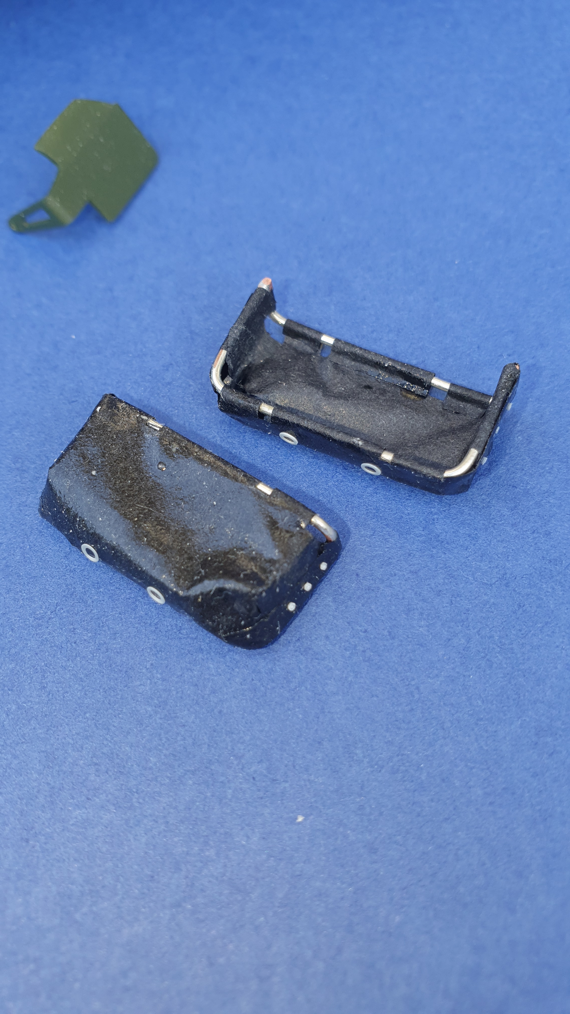

The commander hatch needed some extra detailing on the inside, as well as on the outside.

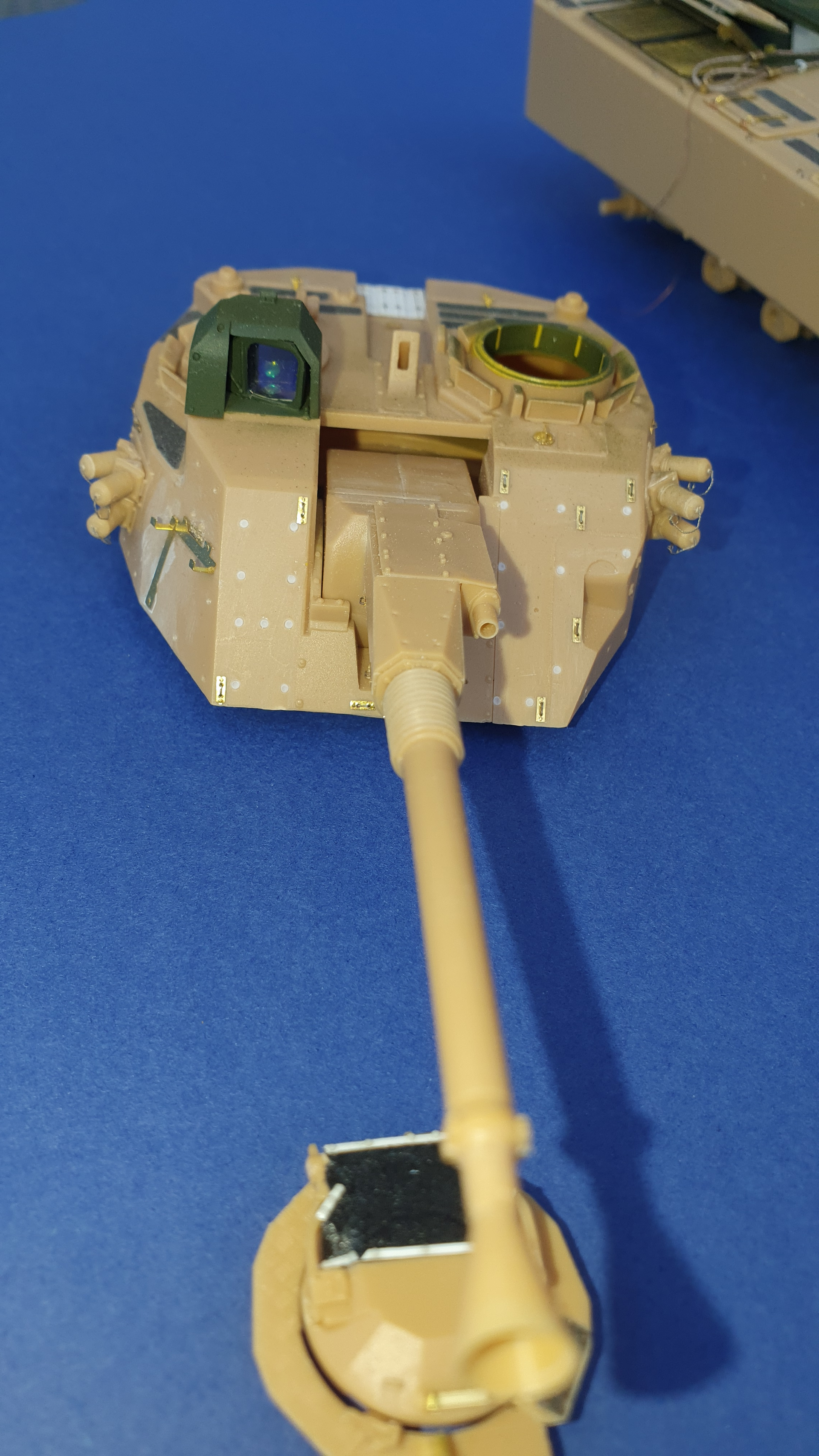

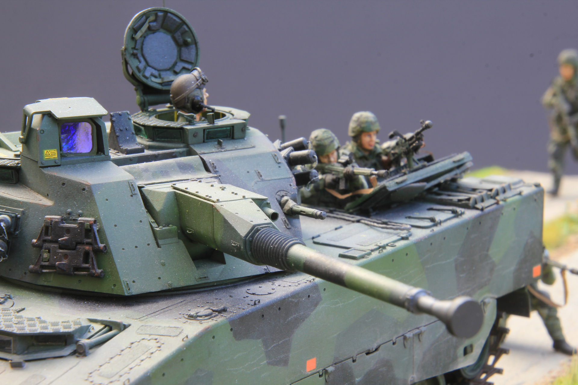

The turret needed some attention as well, some weak toy like details and also some molding related issues, the indentations on the front armor of the turret is supposed to be round, not oval.

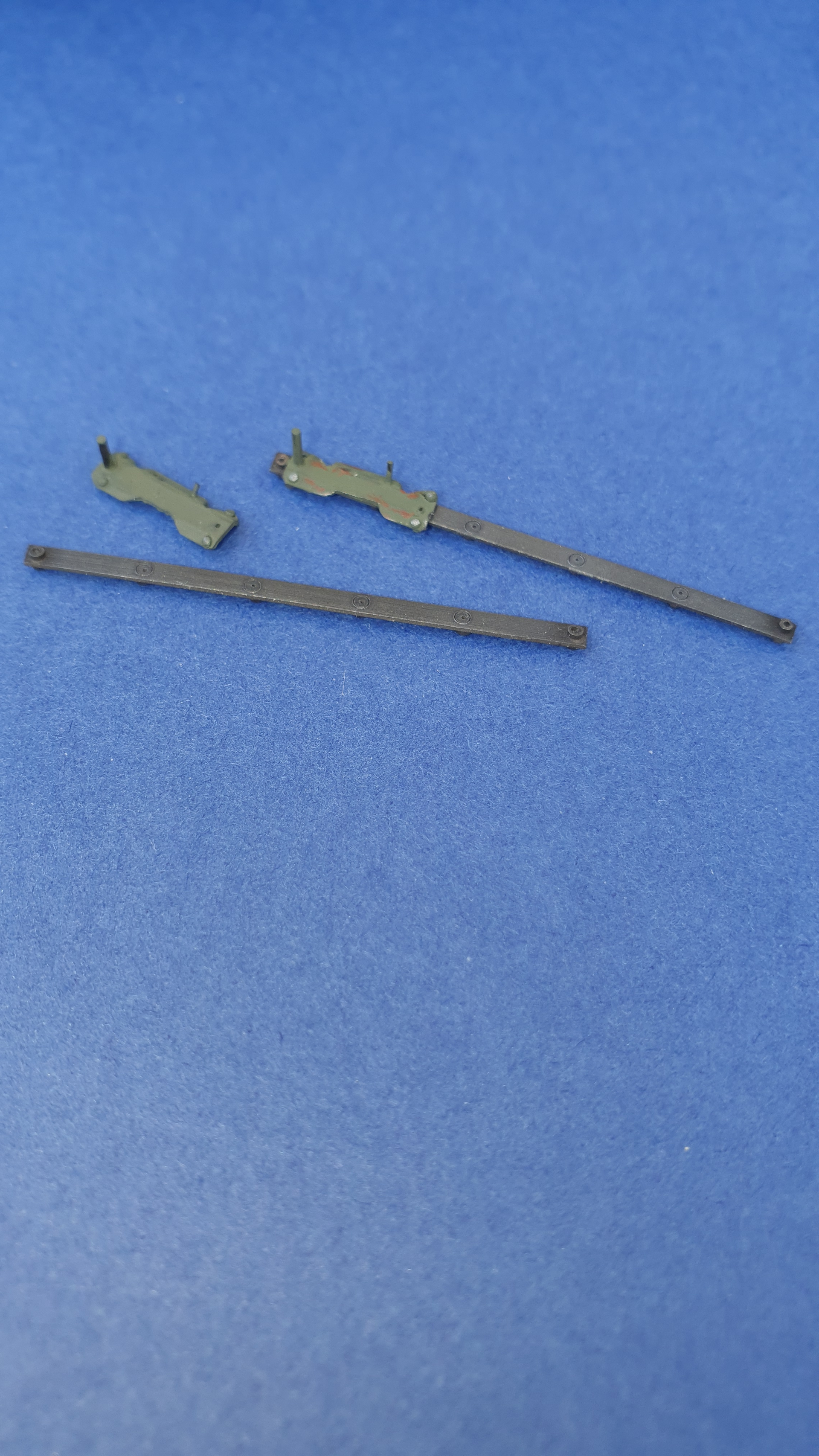

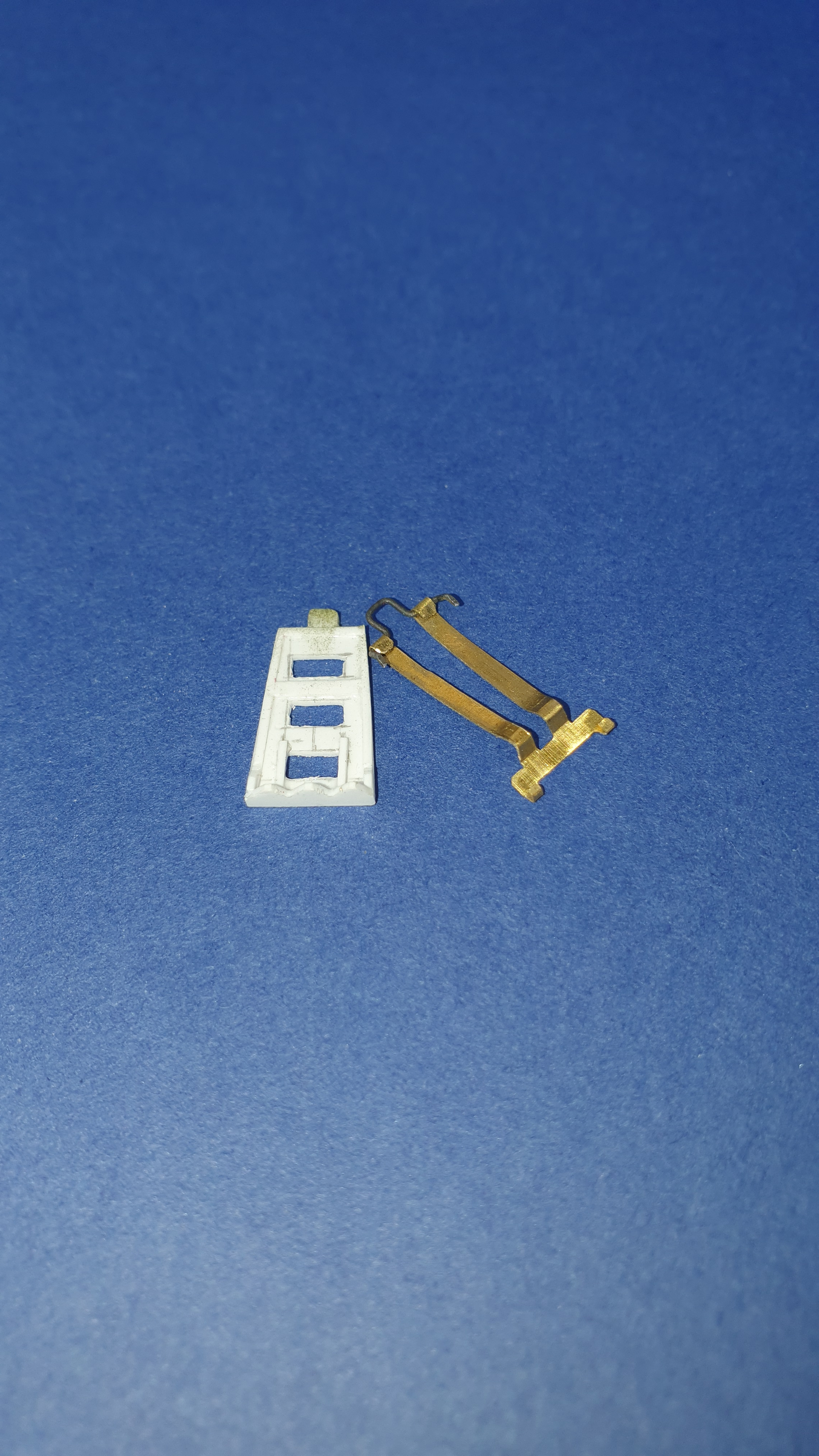

Some scratch built impovement like track ancors normally carried on the left rearmost part of the hull. Also rails for the MGs on the hatches and turret basket where the kit parts are very weak in detail.

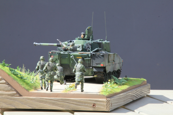

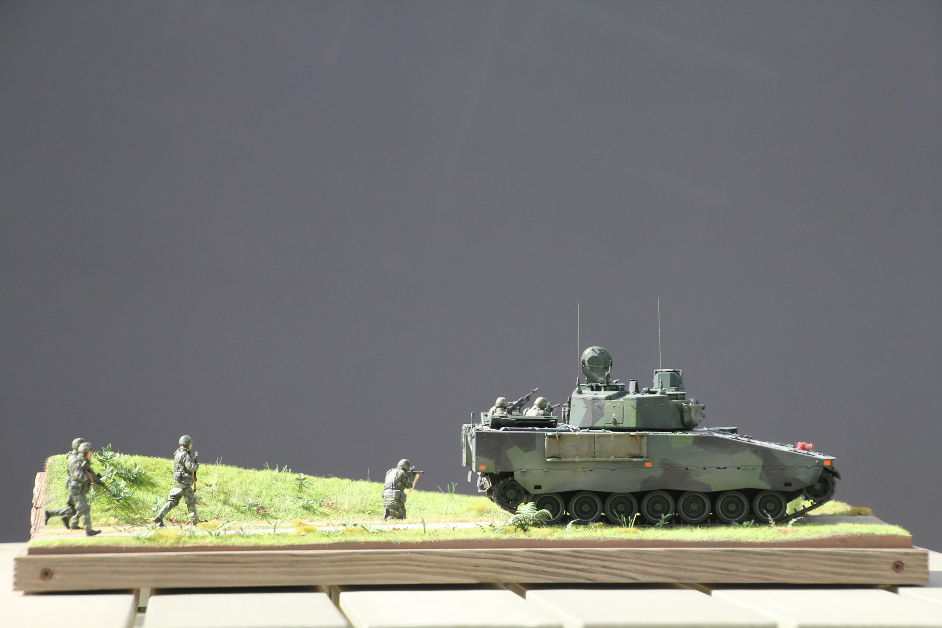

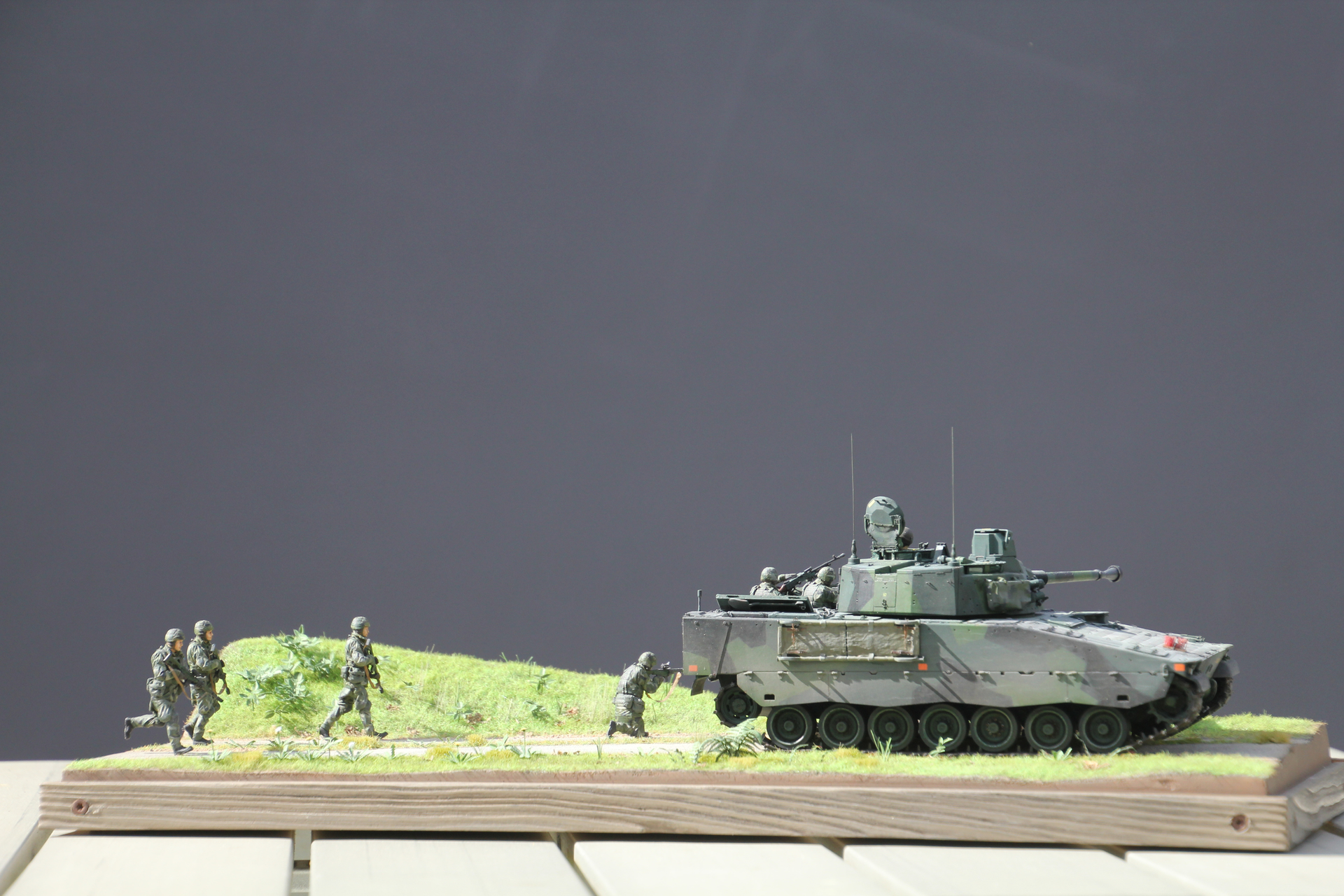

And this is how it turned out. A few very nice 3D printed figures from Speira Miniatures, a bit of diorama work where I tried to depict Swedish nature some time in May.
Thanks for looking, comments are welcome.

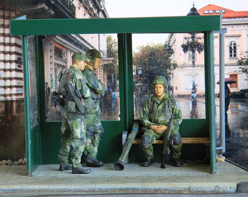

What I liked the most was how well the figures integrated into the diorama. Where did you get them?

Thanks Ricardo. The figures come from the Swedish company Speira Miniatures. They do business by print-on-demand and it works really well. I normally get my orders within 3 - 4 weeks. They do ship also world-wide. The Swedish figures I have used are 3D-scanned from a real person making the fabric look really nice with all creases and such.
Here is three more from their Swedish collection. Three guys taking shelter in a bus stop.

This is exceptional work in every aspect. Excellent scratchbuilding and superior detailing. All that anti-slip is really effective - how did you remove the paper backing? The camo paint and figures are also superb. Great job on all of it - a very impressive scene.

I remove the paper backing by placing the sandpaper backing upwards on a really flat surface and scrape the paper with a diecent piece of a break blade knife. Different direction, sharpen it on a wet-stone every now and then. Hold it up against the light to see the progress. The aim is to almost all paper gone. It takes some time to do, but that is what our hobby is all about; killing time and honing our patience.
