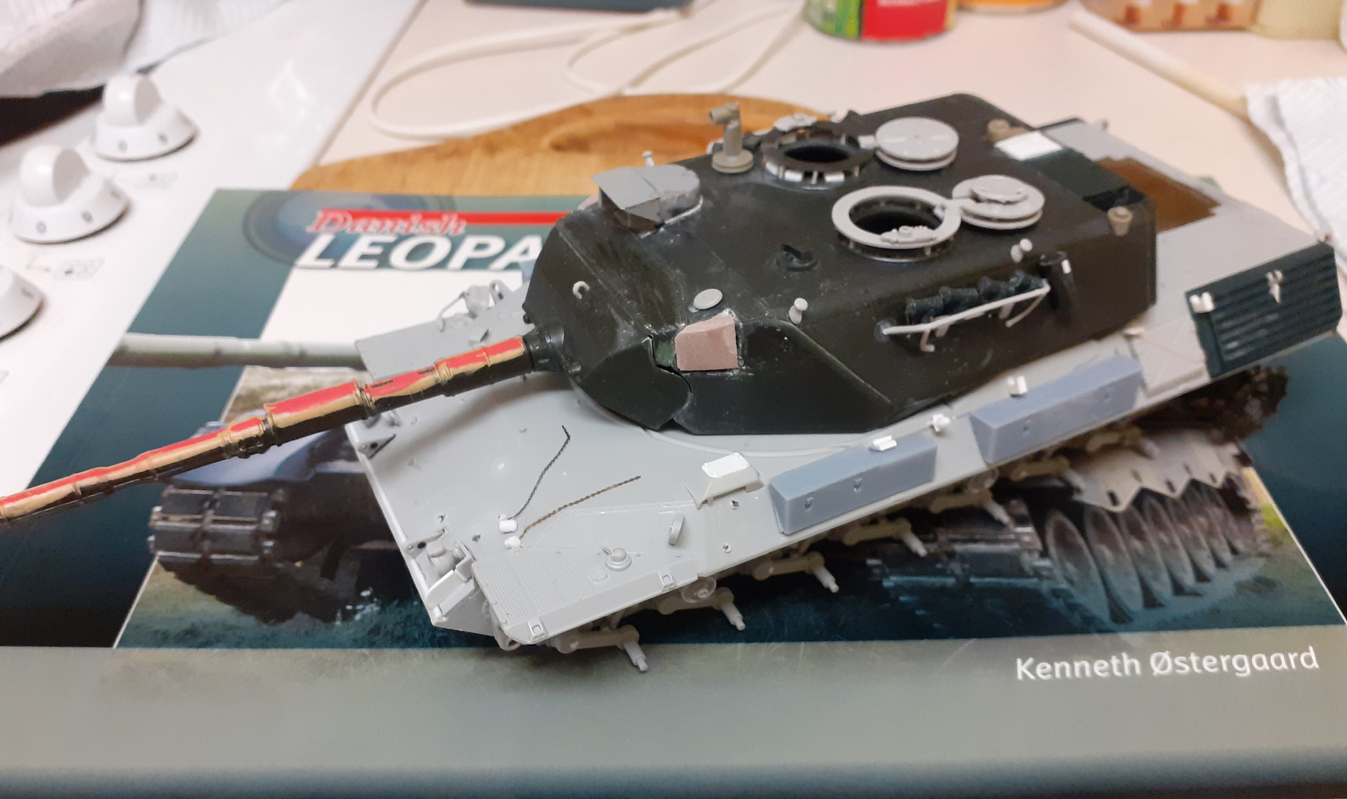

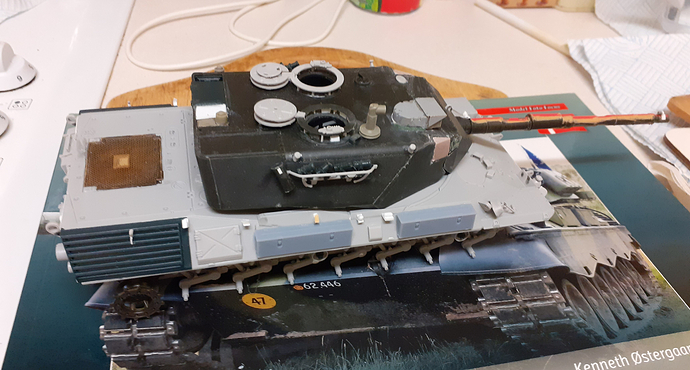

Hi guys.
Still tinkering away with my Leopard Frankentank models.This one is a conversion from an Italeri 1A4 into the Danish 1A5 type.Plenty to change and add to make a Danish version.Luckily i have the old Accurate Armour( Dan scale) Danish conversion.I also have a few oddments in my spares like the Emes sight and a UN leopard set so at least i can make another couple.I altered the commanders periscopes as Italeri give you 6 instead of the 7 on the tank.I made some new scopes from plastic beam filed to shape.Today ive been blanking off the range finders and need to refine them with some filling and sanding and add the weld beads from Epoxy putty to match pictures.The EMES sight wasnt too bad to do.Gingerly cut a square in the turret top to add the shelf for the sight to sit on.Its passable at a distance and added a bead of Greenstuff putty around it to depict the weldbead around the bottom of the sight

Looking good Richard ; a lot of work gone into that clearly.
Keep at it - the Cold War Modellers are depending on you(!)
That’s looking pretty good, though are you sure you didn’t glue the turret lifting lugs upside down? :slight_smile:
Bugger.Thats what you get when you dont put your glasses on.Well spotted Jakko.

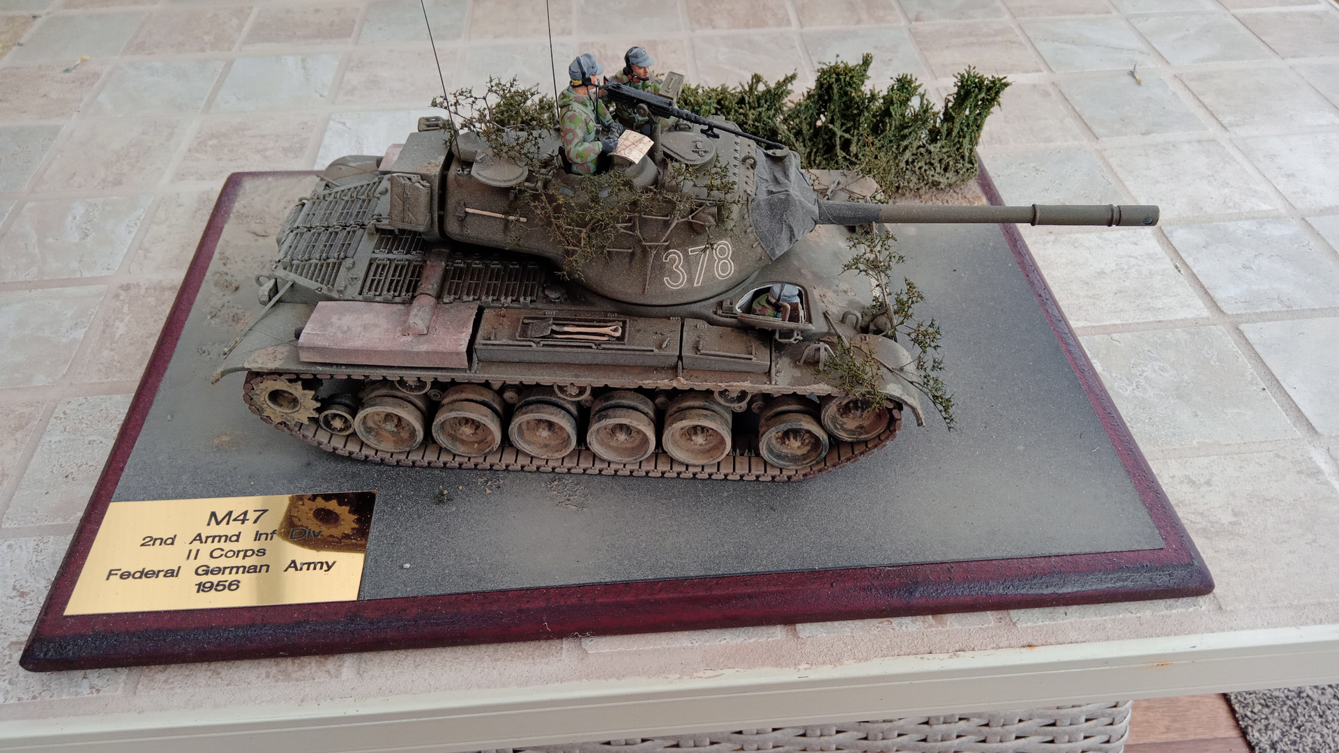

I don’t think the Panda Abrams is anything to worry about - I think it’s a pretty good kit. I started it some while ago, and there it languishes, on the shelf of no hope but I can’t remember what stalled me. Probably a tangent involving a Leopard(!) My first Bundeswehr build - if you ignore the ancient Tamiya Leo I tackled when in barracks (not a success) - back in the mid 70s, was the excellent Italeri M47. I did it some years ago, and can’t quite remember when. I passed it on to my local model shop fairly recently but have no idea what he did with it. There’s a few errors in the uniforms but I always like the juxtaposition of early Bundeswehr uniforms, so redolent of the Wehrmacht, with more modern kit; any way, here it is:

Not of course, from the 1960s onwards, but still an important model I feel.
