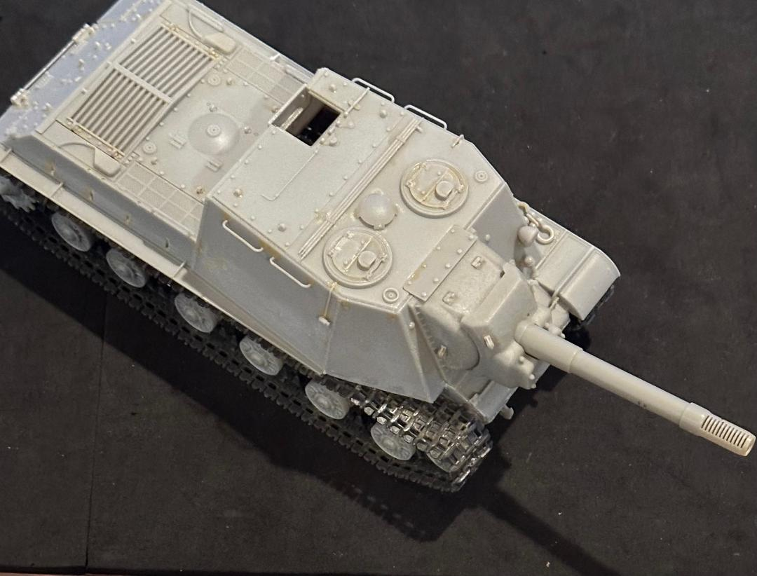

It was a good weekend for building. Other than having to do a 5K with my wife in 8 degree weather, the slate was free.

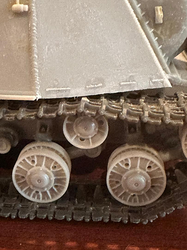

While it looks like I made good progress, the I still have a lot to do. The kit did not come with a DshK, but fortunately I have one from another kit. Still, it needs the pintle mount which will have to be scratch built.
Also, the inside hatch detail is abysmal, so I’ll need to work on that as well. And since I forgot to seal off the sponsons, I’ll have to figure out how to do that after it’s already been assembled.

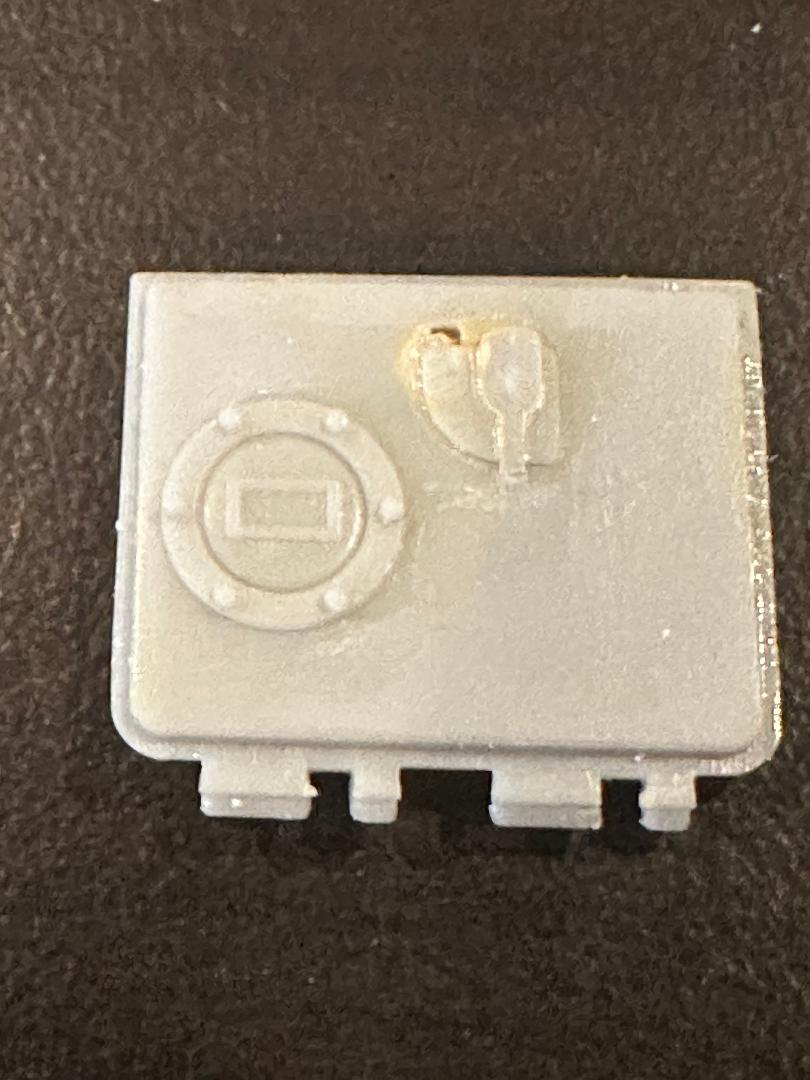

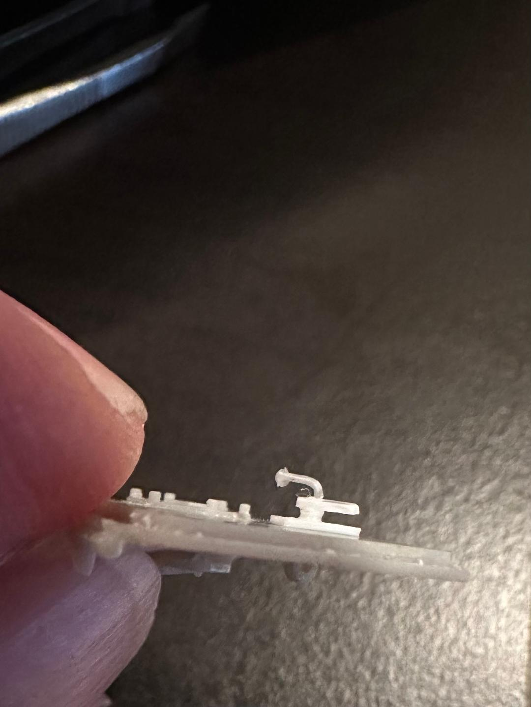

The inside hatch detail was cast on - poorly. And no periscope. I’ll use a periscope from the AFV Club T35/85. I’ve already shaved of the handle, which was two dimensional:
My modest efforts at the latch handle:
The hole is from a lift ring added to the outside. Naturally it had to be filled with CA.
Modest efforts? Looks like pretty dang good details from here :+1:

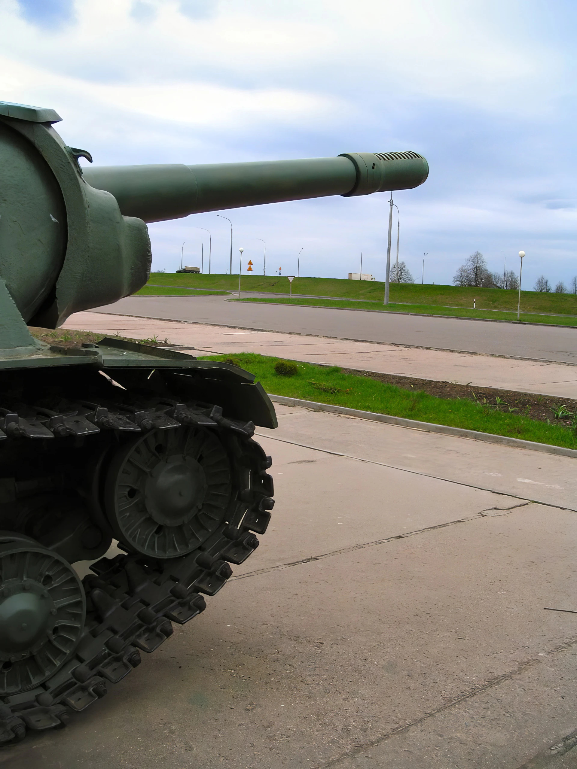

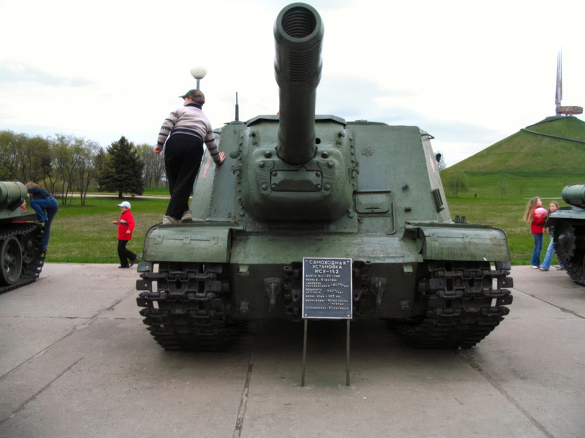

I hate to point this out, but shouldn’t the muzzle brake be rotated 90 degrees to horizontal orientation?
I guess it depends on who you ask. :slight_smile:
This is the same museum vehicle. Note that the muzzle brake is in neither a horizontal nor vertical orientation, but actually at a random orientation, near vertical, but not precisely aligned. I would argue that the muzzle brake has been removed at some point and reinstalled later without regard to proper alinement.
Maybe they’re modeling White 648, which is what I’m doing - complete with penetration hole in the barrel.
The kit’s barrel is keyed to make it go on correctly. I removed the key so that I could orient it as in the photo. Note missing fender:
OK, I see… as Roseanne Roseannadanna would say; “Nevermind”. :speak_no_evil_monkey:

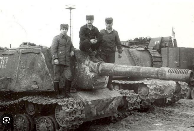

Just to show it wasn’t unheard of…
My guess is with the street fighting in areas like Berlin, they wanted to divert the blast up and down rather than sideways towards nearly troops. Anyone who has ever stood close to a 155 when it fires knows what I mean.
Are muzzle brakes adjustable? I assumed they were welded in place.
No they are removable. Usually by screwing them off/on…
