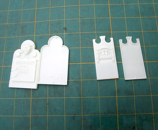

Contents of two bags of parts. Assembly is easy and basic. A lot of seem lines to clean up on the figures but I didn’t work too hard because it was going to be in the dark anyway.

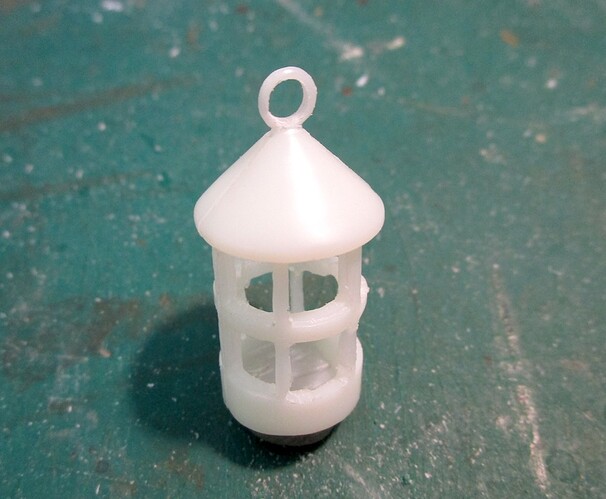

The lamp is just a blank to be painted after completion. I want to add an LED in mine with wires running through the bottom to a power source.
Cutting out the glass parts was quick. Not a lot of concern for perfection because it will be in the dark. Then drilled out the handle ring on top.

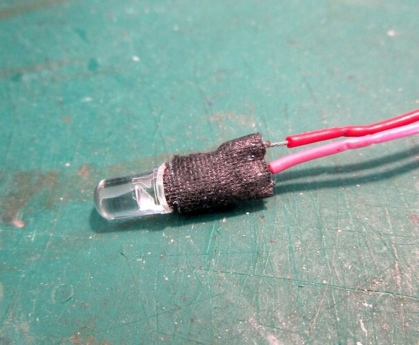

The LED taken from the tea candle is a larger diameter. I enlarged the hole in the bottom of the lantern for this.
Then I soldered wires which will lead to the power supply.
A drop of hot glue between the leads so won’t touch when I’m roughing it into the model.
Test fit then black gaffer’s tape to block any light leaks.
Power supply are the two batteries that were included in the tea candle.
Test.

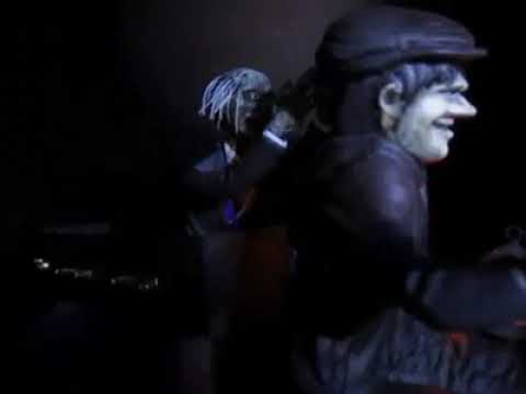

Here is the quick build all finished. I’ve painted only parts and one side intended to be seen in the dark from one angle
Looks great. ![]()
They look outstanding! Love the sickly green color.
@Tank_1812 @SSGToms Thank you for the compliments
