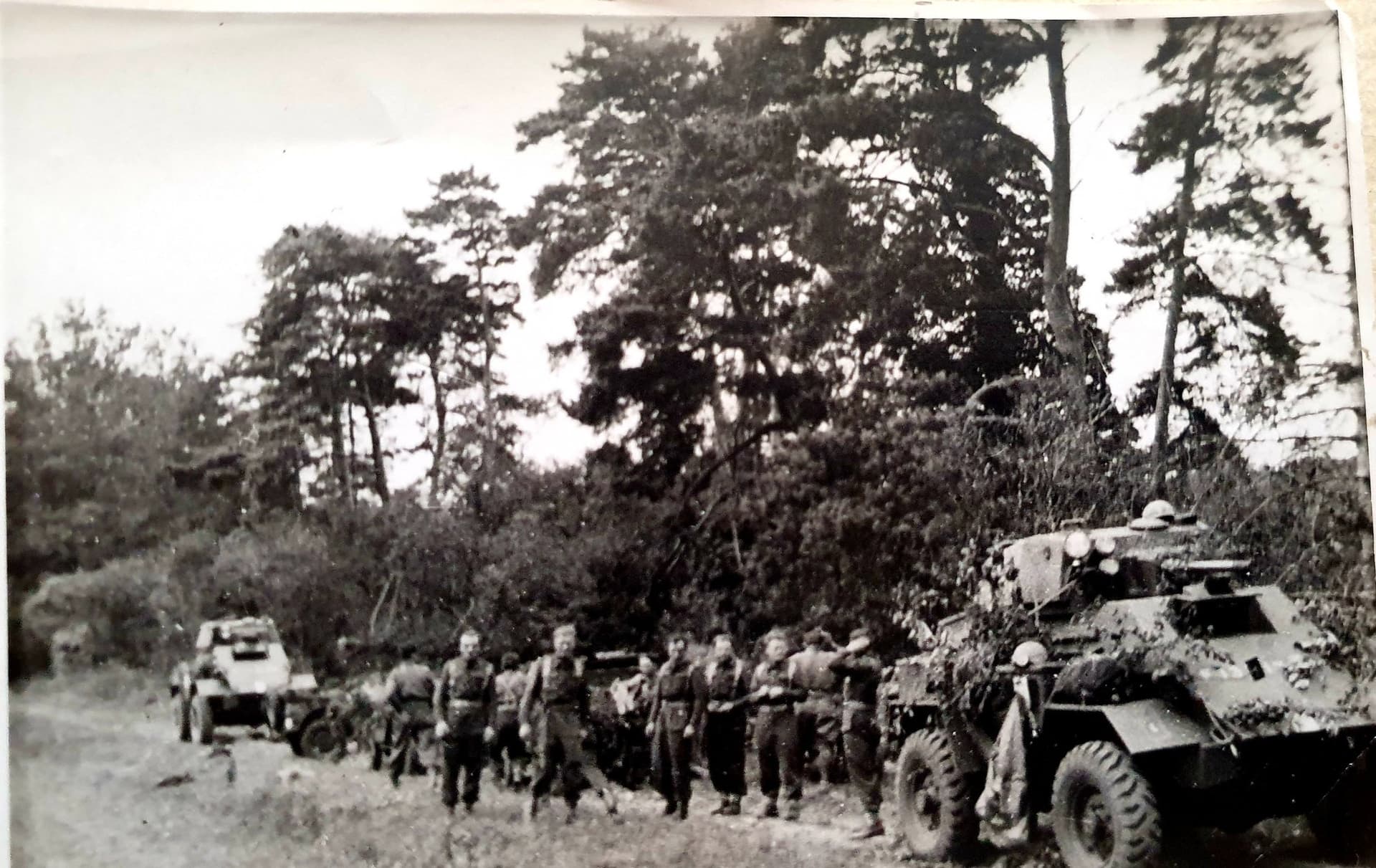

Humber armoured cars of the Polish 10th Mounted Rifles Regiment parked up the grounds of Dalkeith Palace c1941:
Interpret the colours as you will, but for my take on it, G3 overall. Compare the uniforms to the AC’s colour.

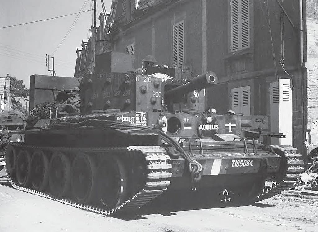

Here is SCC2 Brown: very much a dark colour in B&W pics:
and yes they were SSC2:

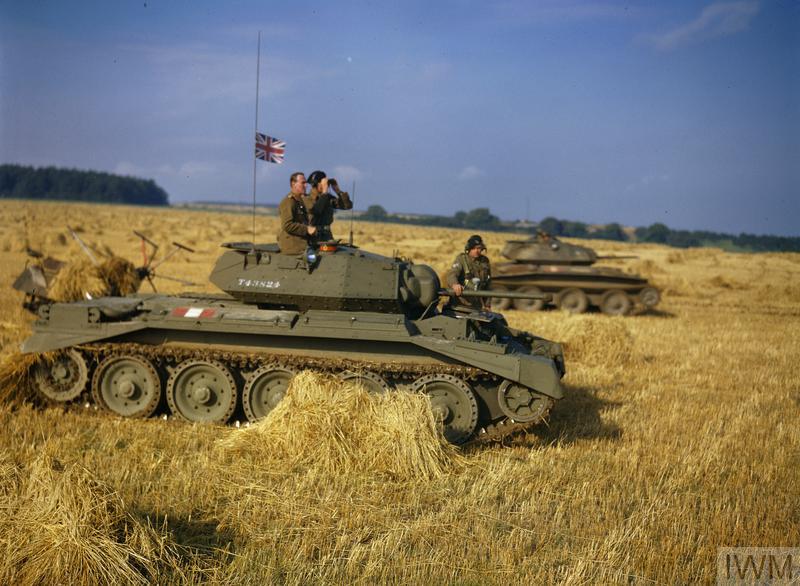

PArt of the color used would be time of manufacture. Cromwell/ Centaurs didnt start production till after the switch to SCC2,if memory serves. So would be SCC-2 until the switch to SCC-15 in 44. (I read somwhere, in Normandy there was a mix of SCC-2, factory SCC-15 factory paint. and SCC-15 repainted vehicles.) I’d imagine the Dingo/ Humbers were the same. Wonder if the Poles (and other exiles.) got new built equipment or if they got “used” while the new built went to British units … and to North Africa.

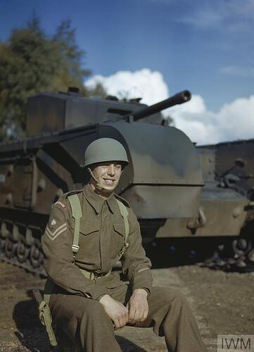

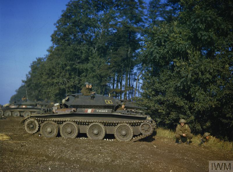

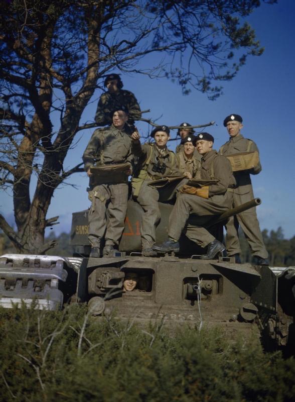

Some good quality photos of colors in the UK during the ‘42/‘43 timeframe… not computer colorized.

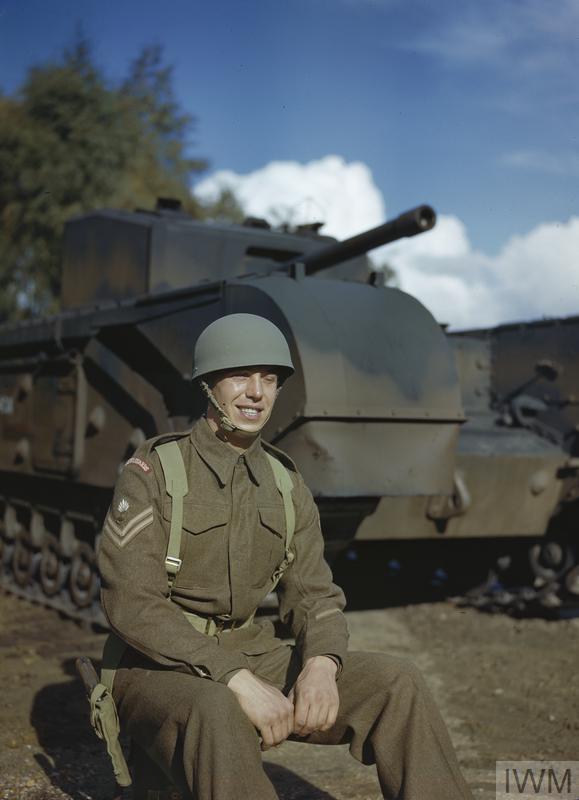

Good grief - second picture down once graced the cover of a very old Airfix magazine from way back when; I think I was still at school!

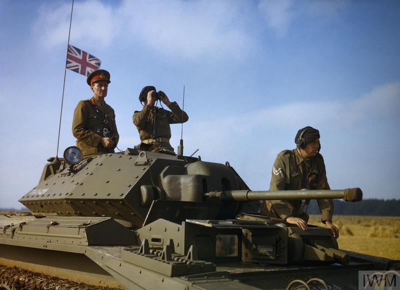

The last pic shows General Sir Bernard Paget, as CinC Home Forces I think.
Good pics all round.
Reference my last, and Google being my friend, here it is:

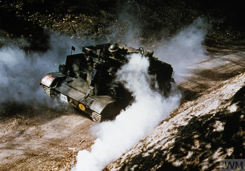

Found this Universal Carrier for more reference
and a close up of the Crusader in the earlier photo
The first pic (Churchill?) and the one of the Universal Carrier look like they are SCC-2 with green . (Or black maybe.) Hey, side question … did the Poles use the standard Brit black tank berets or did the use different head gear?

I agree that these are excellent photos. However, relying on them (or any other wartime colour images or film) as ‘accurate’ colours is dangerous.
Colour film is more difficult to process than monochrome film and also more sensitive to exposure or processing errors. In addition, the chemical dyes embedded in the film render colours in different ways, depending on the film manufacturer and that can impact on what the colour looks like in the photo.Film stock back then was also less stable, so that meant a greater risk of variation from batch to batch.
These images are generally providing a very ‘rich’ range of high contrast tones which would suggest that they may have been taken with Kodachrome film stock. If the same photos had been taken with Afga film stock (as the Germans generally used), the blues would have been rendered paler and that would alter the apparent colour of the vehicle.

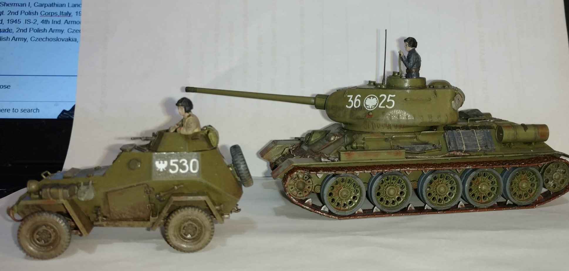

Got decals from Toro Models. Planning on Humber from 1st Recce Regt., 1st Armor Div., 1943. Dingo II, 10th Mounted Rifles, 1942. Cromwell, 10th MR, 1944. Crusader AA, 2nd Tank Regt. 1st Armored Div. , 1944. (when were these built? SCC-2 or 15?) , M10C Achilles, 1st AT Artillery Regt. 1944. Sherman I, Carpathian Lancers, 2nd Polish Corps, Italy, 1945. Sherman Ic, 4th Armored Regt. 2nd Polish Corps,Italy, 1945. T-34 obr 1942, 1st Armored Brigade, 1st Polish Army, Poland, 1945 .IS-2, 4th Ind. Armored Regt. 1st Polish Army, Berlin, 1945. T-34/85, 16th Armored Brigade, 2nd Polish Army. Czechoslovakia, 1945. BA-64B, 27th Self Propelled Artillery Regt., 2nd Polish Army, Czechoslovakia, 1945. (BA-64B and T-34/85 WIPs. Still need to weather a bit more, do some final touched. )
