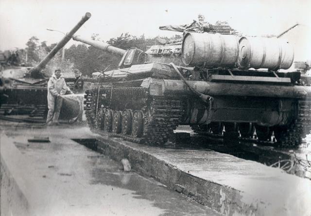

They are not always done so precisely, especially non-Russian tanks. For example, this tank (photo posted by @Frenchy on the Ukraine thread):
This log is off-sized, shows definite bends in it, and still has some bark still on it.
