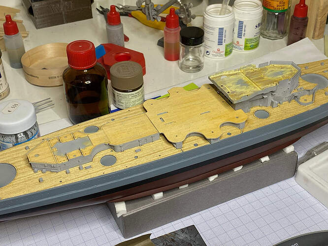

Ok, so as promised, here’s a little update. I actually found some time to spend at the workbench this weekend, getting back into the build and manly doing small stuff.
But first of all, propulsion installed:
The fit of the kit is really excellent, this was the smoothest alignment of shafts, propellers and rudders I can recall in a build!

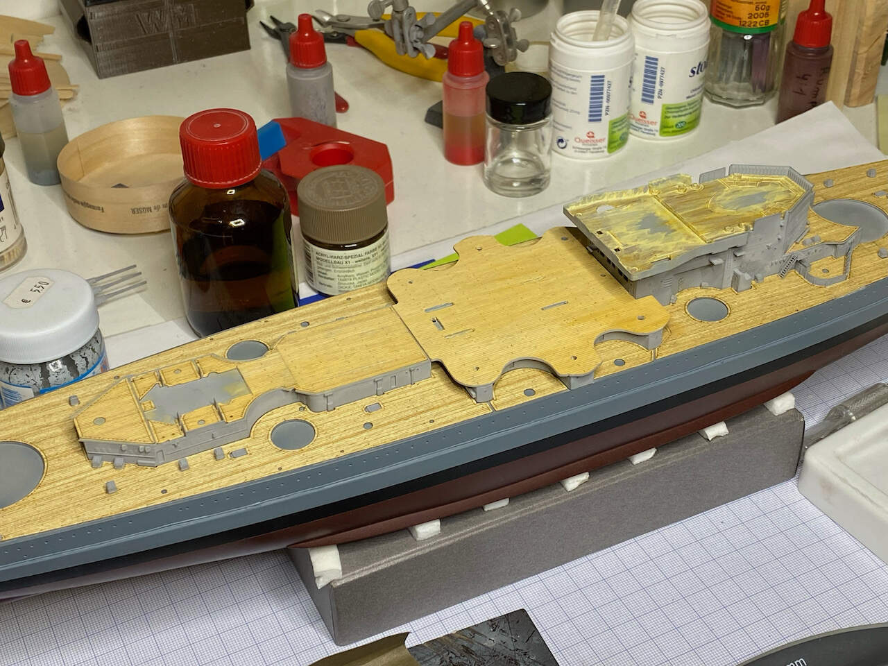

The rest were ammo boxes, doors, scuttles and other stuff, needs all touch ups, partly another layer of paint, but that’s not a problem.

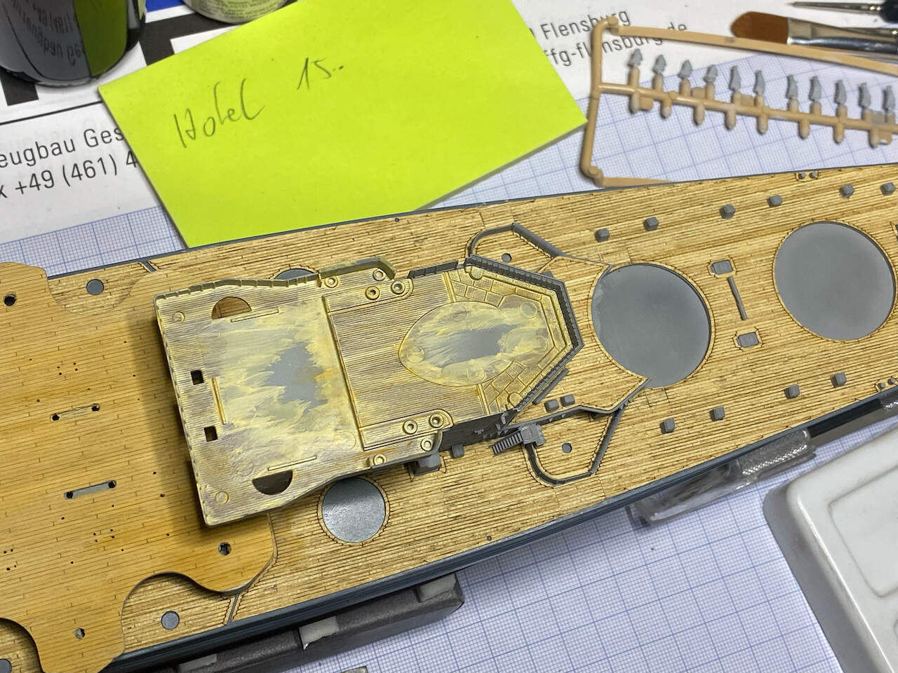

No wood provided, so I started with a coat of ‘flat earth’, will lighten that, needs much more yellow, too, and some oil. It should end up somewhere near the wood colors of the decks.

Nice progress on the props Jan,
It is always a pain when you don’t get a all the wood you need, nice bit of texture in the base coat on the bridge deck, will fit in nicely when you have it finished.
Hope you get to London ok, a bit busy at home next weekend so won’t get time to get over the Great British Beer festival this year, pity, I haven’t been since before Covid.
Cheers, Si
Hi Si,
thank you very much! Well, there’s more than one area I spotted where I need to improvise some wood. While I used the generic wood deck on the bigger parts of the deck, I don’t see a realistic chance in cutting appropriate pieces for those small and edged areas. Some paint will have to do.

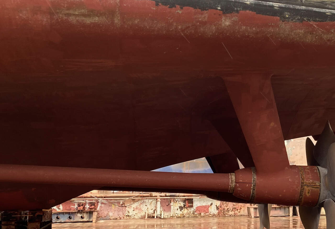

Very nice work on her props and Skegs. What gets up my goat are the Number of Ship Models you see and they paint the Shafts in an Antifouling colour instead of their natural Metal…Cheers Mark
I do mine in the antifouling because most reference photos I have seen show the shafts in that colour (granted most of the photos are post WW2 as colour photos weren’t common back then so very hard to judge shaft colour)
Well, that’s a very good question…to be honest, I don’t know. I did the shafts on my RN ships in anti fouling red, also. I read several references indicating that they were painted, but no color pictures clearly showing it.
I decided for the bare steel here mainly to add a little color and make it look a little more interesting, and some references indicate it could be true, but again no proof.
From a more modern ship well known to me I do know the answer, however that doesn’t necessarily mean it was like this in WW II, and actually, this could have changed basically during each and every docking period…
I appreciate your comments and thoughts! Maybe anybody has some evidence to proof the one or the other?
Jan
It makes sense to paint shafts with anti fouling - marine growth there is as undesirable as it is anywhere with the additional potential for sending the shaft out of balance. It may be that centrifugal force as well as scouring will make it less durable but I should think that they would be painted nonetheless.

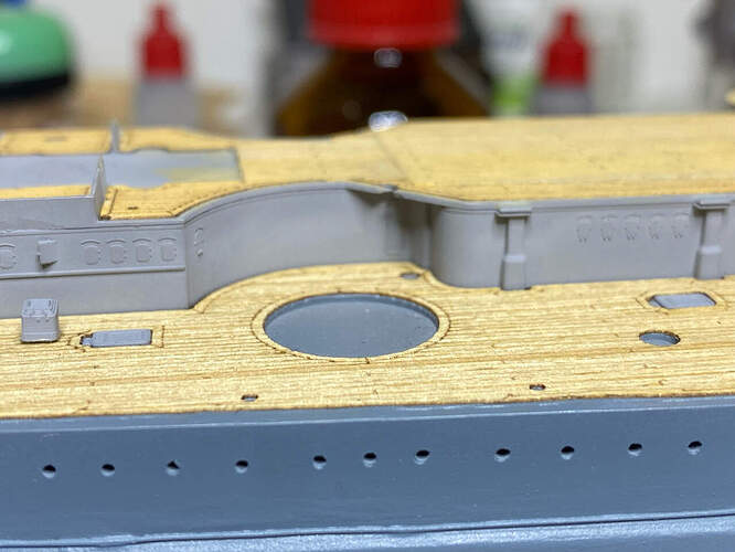

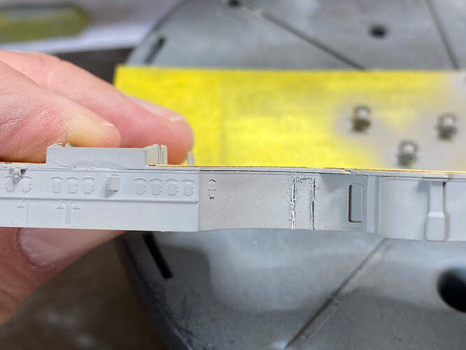

JJ1073 non dimenticare che la struttura di poppa del Gneisenau aveva un passaggio tra le due torri binate da 150 mm . Ciao da Francesco
Hi Francesco,
thank you for dropping by!
As I’m not speaking any italien, I asked google translate and was confirmed that you were talking about a passageway in the aft superstructure between the aft twin 15 cm guns.
I got your post I think, thank you and indeed I had missed that so far.
That area here has an open passageway on Gneisenau that Scharnhorst does not have.
I’m going to cut that out, will have to add a little wooden deck, but that should be not a major issue.
As references I have on that are weak (but clearly show it’s there) I am going with an estimate. Will cut this away and create the open p-way. Thank you for that valuable hint!

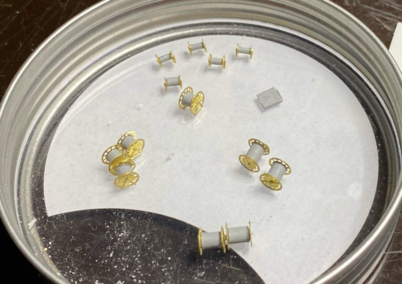

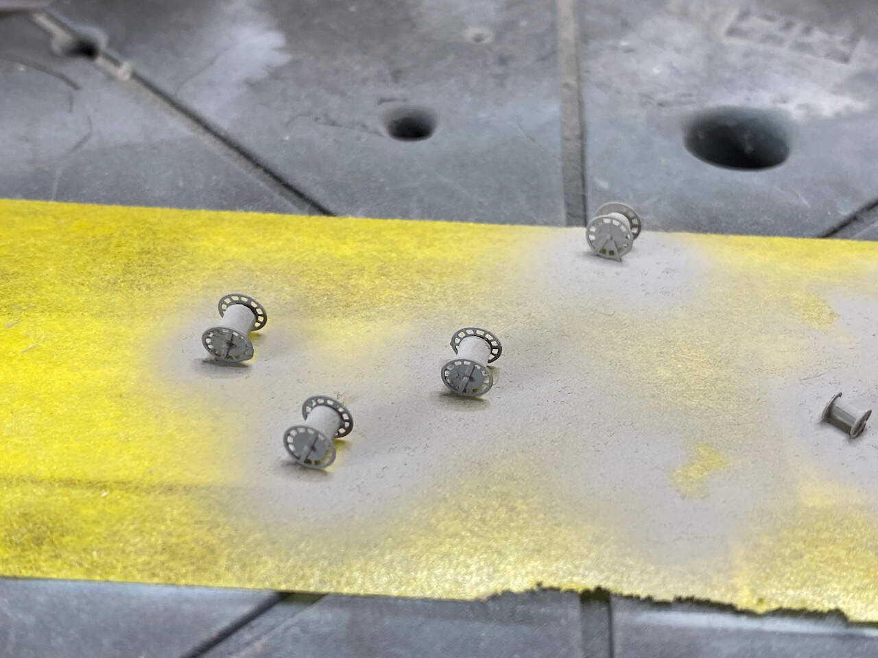

Cable reels, will add some thread to make them look a little more realistic.
And adding a little oil to the deck to create a little wood-like uneven expression. The areas in question will be rather small in the end, somewhat concealed and speckled with equipment, so that should do…
