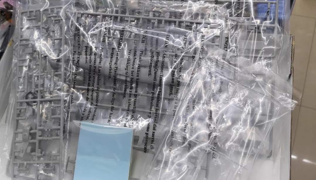

About a month ago, I planned to build an AS350 served in umbrella. But I failed to find an kit of the AS helicopter series. Then a decision had been done🤔: Dolphin in WWZ . The Dolphin appears many times in the film, in American black painting, WHO(maybe UNSC;the minister takes) white coloing,and Israel desert camouflage. Personally,I love camos,thus the Israel one takes the cake.
I planned to convert Z-9 back to Dolphin(enhancing the weapons). And I bought an unofficial decal(still in express transportation. I will start it tomorrow maybe😀
