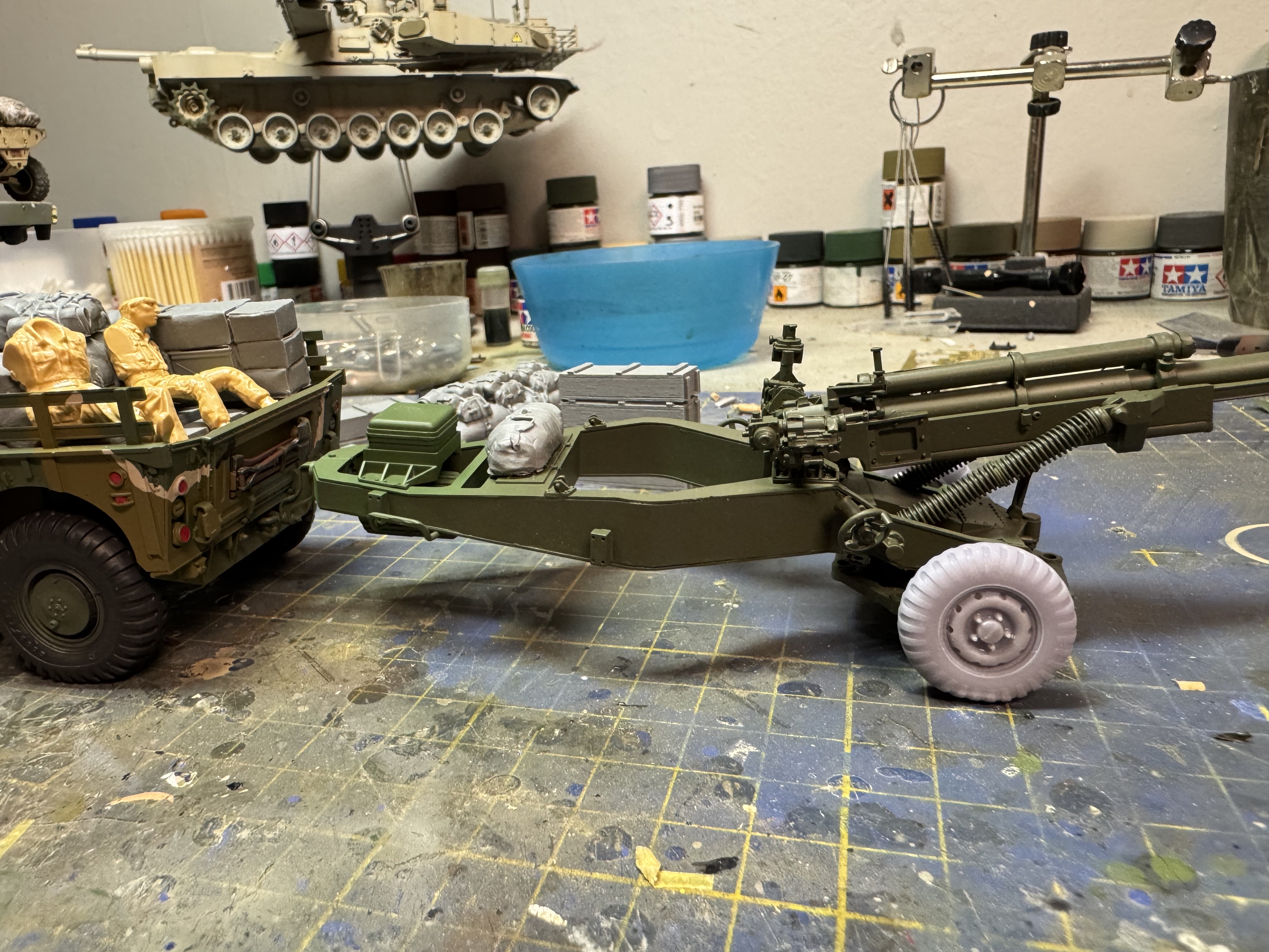

Inspired by Tankograd American Special no 3032 Carbine Fortress I´m building a M561 Gama Goat (Tamiya) towing a M102 Howitzer (AFV-Club) away from the drop zone after landing. (First picture from Tankograd).
But the “towing hook” on the M102 makes it to close to the ground, that would not work outside hard surface (last picture). Would there be another “towing hook” when used with M561? Any help and thoughts would be much appreciated.
Regards Freddy
The tow hook on the M102 was adjustable. It could be loosened, turned upside down, and tightened down in the new position so it could be pulled by different vehicles.
This one has the hook upside down.
Ah I see, thanks @HeavyArty ! So I just turn it upside down then! :slight_smile:

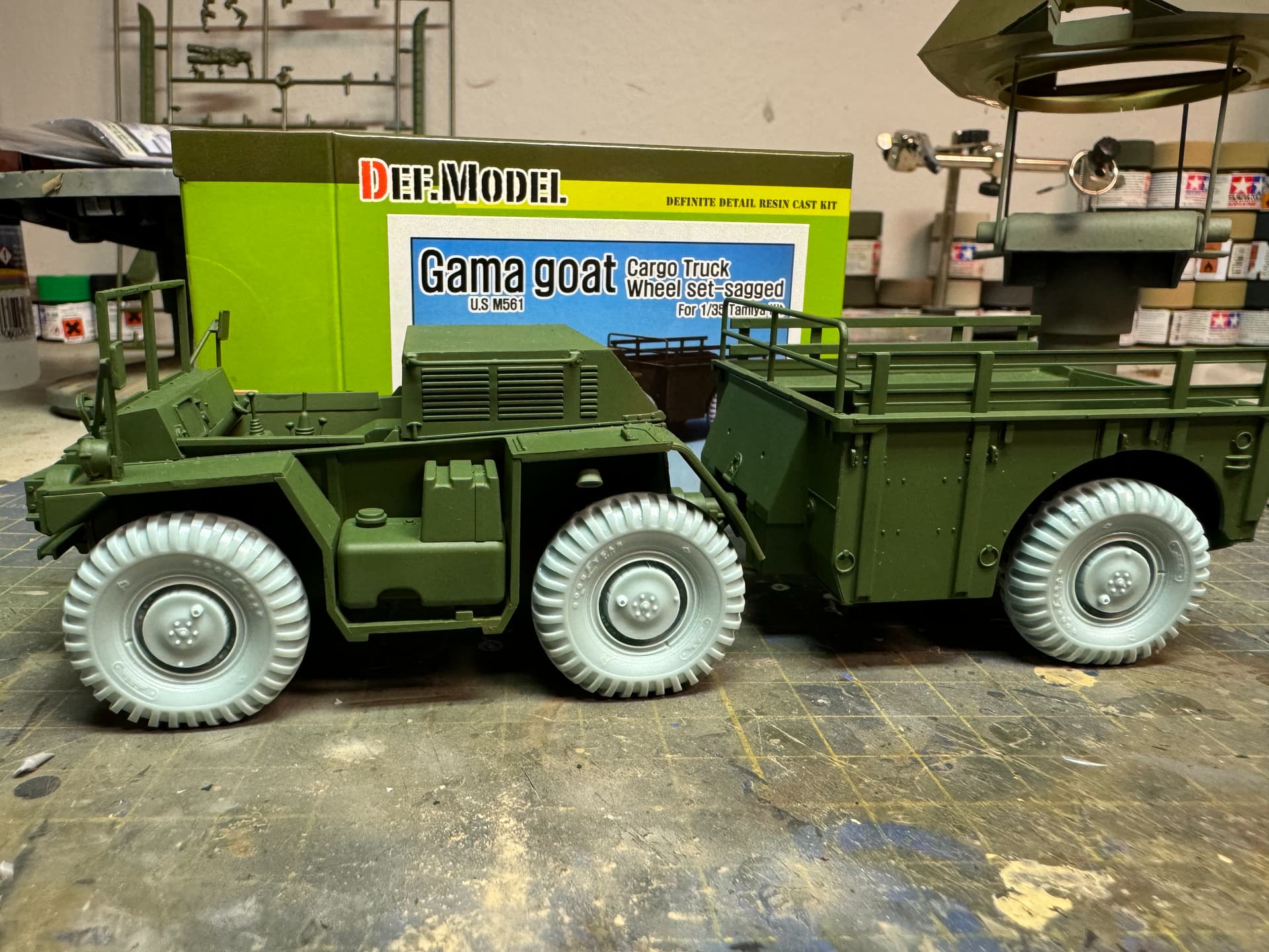

This one is back from the shelf. I finally picked up Def Models’ sagged wheels for the “goat.” Both the “goat” and the M102 are built and primed. I’m probably going to try to find some sagged wheels for the M102 as well. :slight_smile:

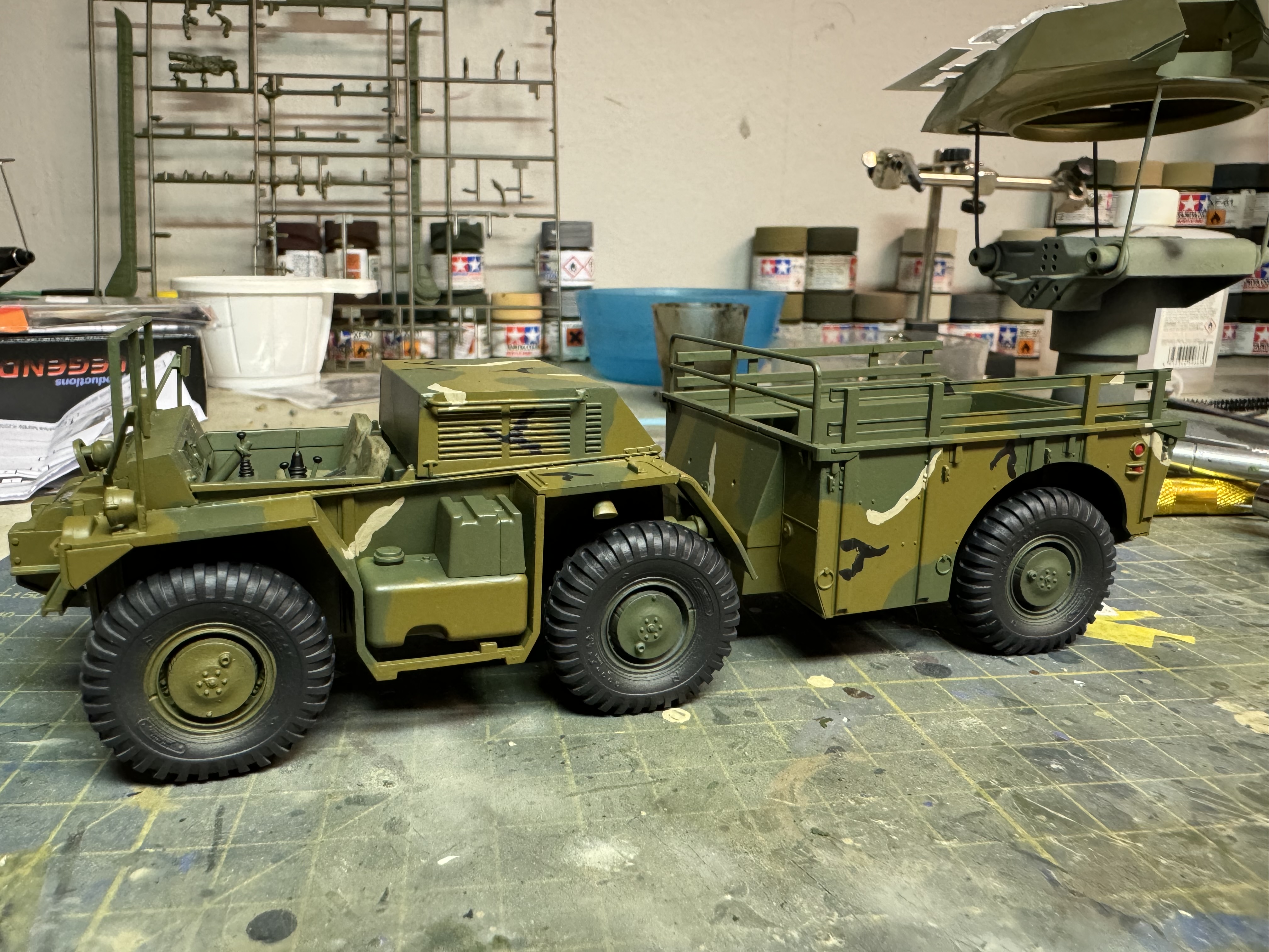

Made some progress today, camo and some detail painting. Discovered that I messed up the winch glueing it backwards but not much to do about that now :weary: Ordered 3D printed sagged wheels for the M102.
(The light makes the colors look a bit odd in the photo).

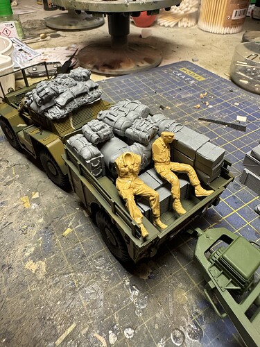

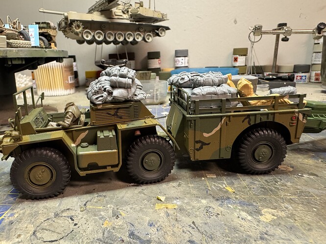

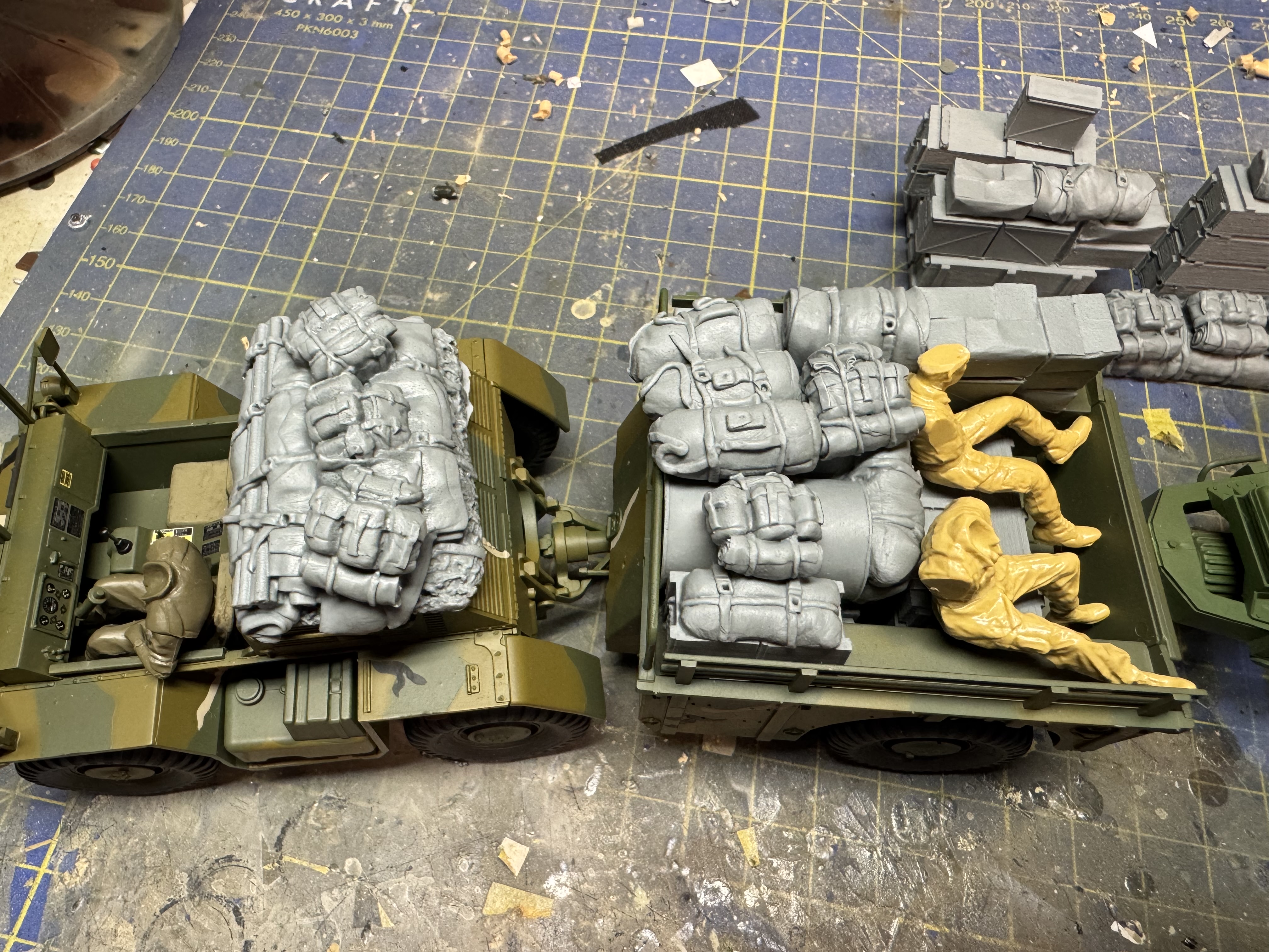

Testing out the layout of equipment and stowage. The figures will be modified to better fit their placements and positions.

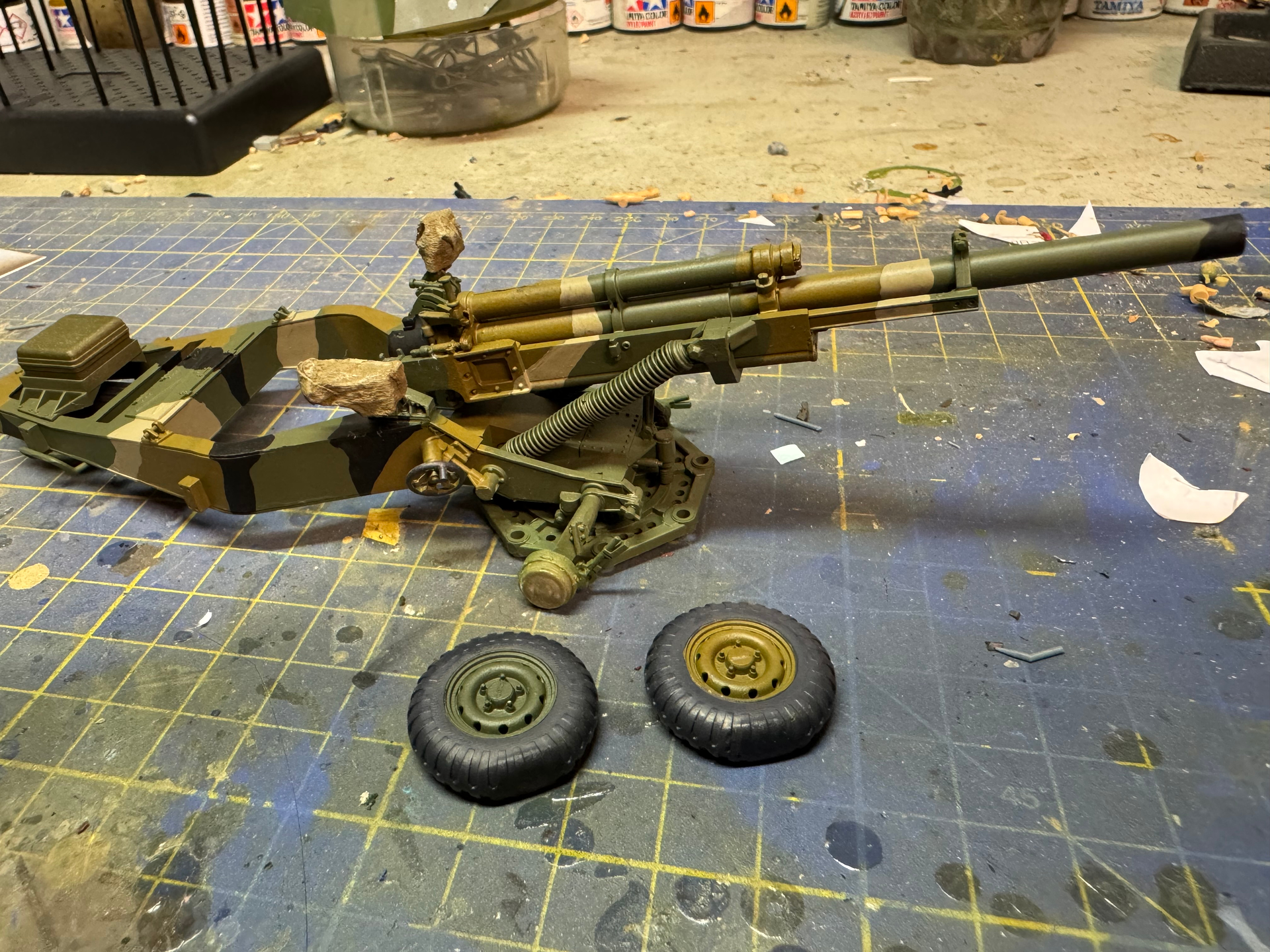

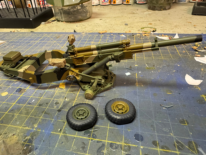

I’ve finally put the camouflage on the M102. Right now I’m having trouble attaching the 3D-printed wheels to the styrene body. Super glue doesn’t seem to work.
Any advice? :thinking:

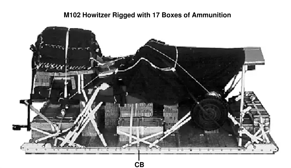

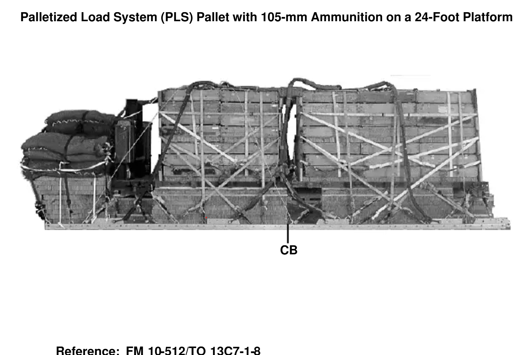

If you want to see how seventeen crates of 105 mm ammo were secured to the same palltet:
Extra ammo went on its own pallet. Not a PLS, bur you get the idea.
Epoxy. And if you can, grind some grooves inside the wheel to give the opoxy something to bite on.
