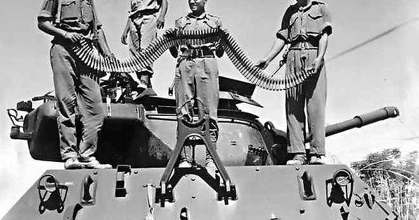

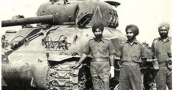

I’m planning on building either a M4 or a M36 from the Pakistani army
I’ve seen images of their tanks using duckbill tracks.
From most of the aftermarket tracks I’ve seen, they show the duckbills ONLY being added to the outside of the track but I have images showing them on the insides in the images below
M36 - duckbill on both sides of the track:
M4 - duckbill on both sides of the track as well:
So my question is how to modify the Meng M4A3 Sherman or the Academy M36 Jackson to put the duckbills on both sides of the tracks?
