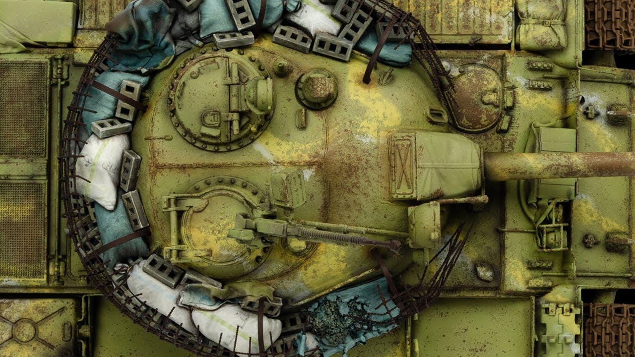

Another model done with the same technique:
