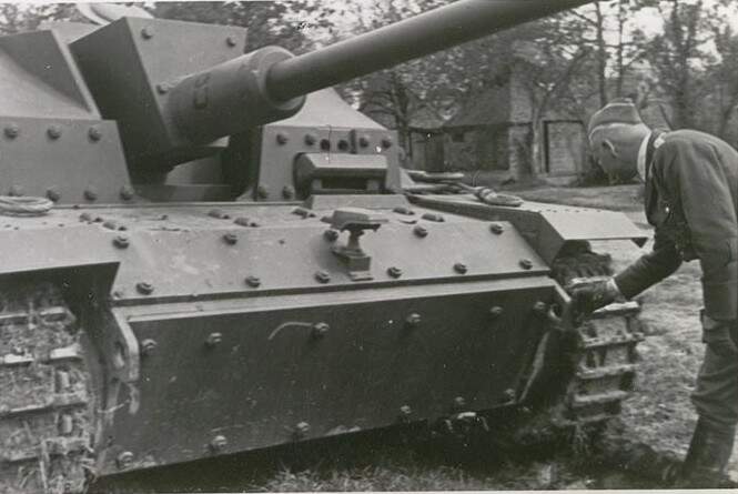

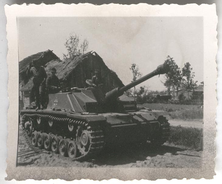

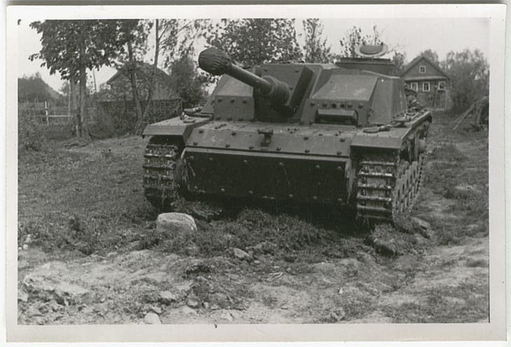

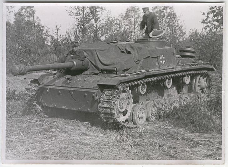

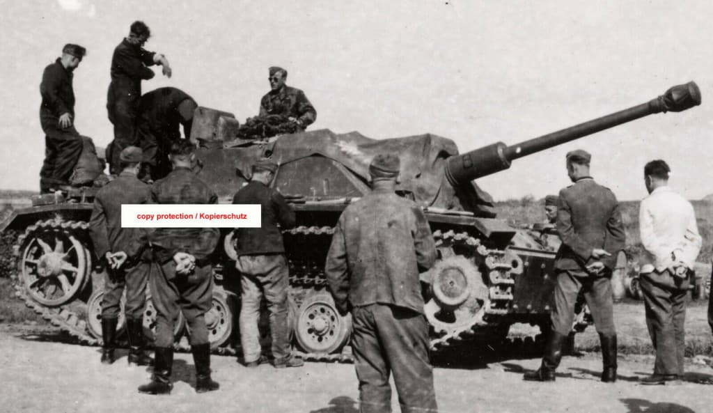

Here is one in Dunkelgrau.
The image above was stated it was from a Luftwaffe unit. Did GD also have the gray initial Stug lllG’s as stated in the paragraph or is this just folk lore?
The fenders are the crucial detail.
