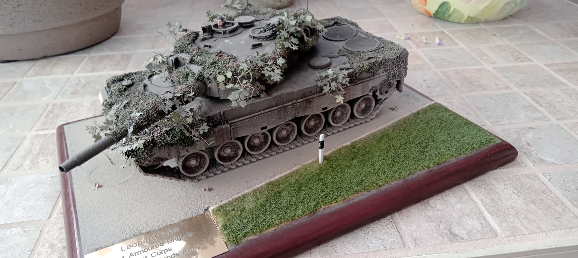

I have a feeling this might be the only specific Dutch Leo in town; it says “A3” but I’m not sure that it can’t be modified as necessary. I chose it for the markings and the specific Dutch-pattern smoke dischargers; it also comes with an FN MAG.:
I made a bit of a hash of the dischargers - they were a bit simplified - and didn’t angle them sufficiently, which partially explains the extensive camouflage and foliage perhaps(!)
This isn’t a particularly good pic - I’ll try and take some fresh ones; I was after a specific effect to replicate a tank on exercise:
The Esci kit is still readily available I believe on sites such as eBay. I’m sure it has its faults and mine was built a long time ago.

As requested – and I hope this isn’t seen as a thread hijack(!)
I was minded to portray my model as per the excellent pics in this book:
As I mentioned I messed up the angle of the smoke dischargers so really had no alternative but to camouflage it more than is shown (in the book):
Anyway, I got a certain effect perhaps.
I’ve just had to repair the MG, so a close look will probably show – the barrel had snapped off. I also note there’s a seam line on the MG’s top cover – what was I thinking of back in 2018 – when I built this one?
As you’ll note, and acknowledged on Carlos’ build, the details are a bit sparse; I recall I had to add tow ropes and somewhere along the line I must have acquired some etched covers for the radiator fans on the rear deck – they certainly need it I feel.
I really should have opened up the Gunner’s sight – there’s no way it would be on the prowl without them being open. It shouldn’t be too difficult to do if you wish to pursue that depiction.
The Commander figure was originally a Bundeswehr figure from somewhere; I may have acquired a head, I’m afraid I can’t remember.
I can’t remember what else I did save for the camouflage net effect using my usual method of gauze and used tea-leaves. The foliage is etch brass and takes a bit of work, but hey! I got the effect – more or less as I’d envisaged.

Thanks for the comments Richard; I understand what you mean re finishing: chipping? No - just haven’t gotten around to it I’m afraid. Pre-shading? Ditto. I do apply washes, and still dry-brush, and to be honest, that’s about it; oh, and copious amounts of mud, Tamiya Buff, and as you can see, cam nets and sometimes foliage.
One other thing: should you have the Revell Leopard 1 in your stash, it does come with a set of Dutch-type smoke dischargers, which I would have thought, would be easy enough to adapt to a Leo 2. Just a thought. In fact, they might lend themselves to scratching with a bit of effort (plastic rod, card?); you’d still need a FN MAG/GPMG but I think that’s about the only real big differences (I’m sure someone will now accuse me of over-simplifying - and I am(!)
