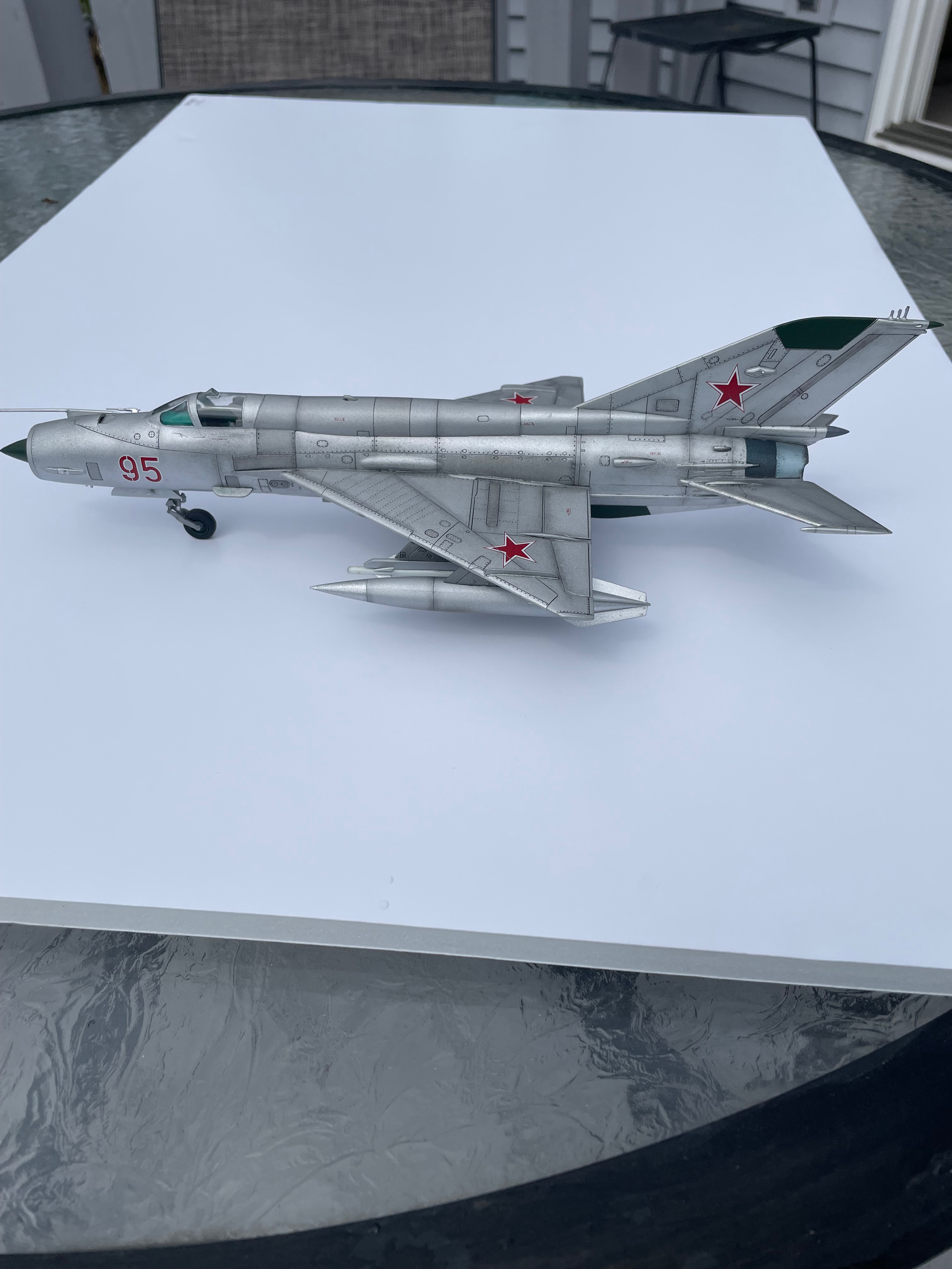

I don’t have any real experience with Alclad. I did one NMF using Tamiya acrylics on a MiG-21.
If you want which colors let me know. I can’t recall what the primer/base coat was but I know I didn’t use different colors as the base.
