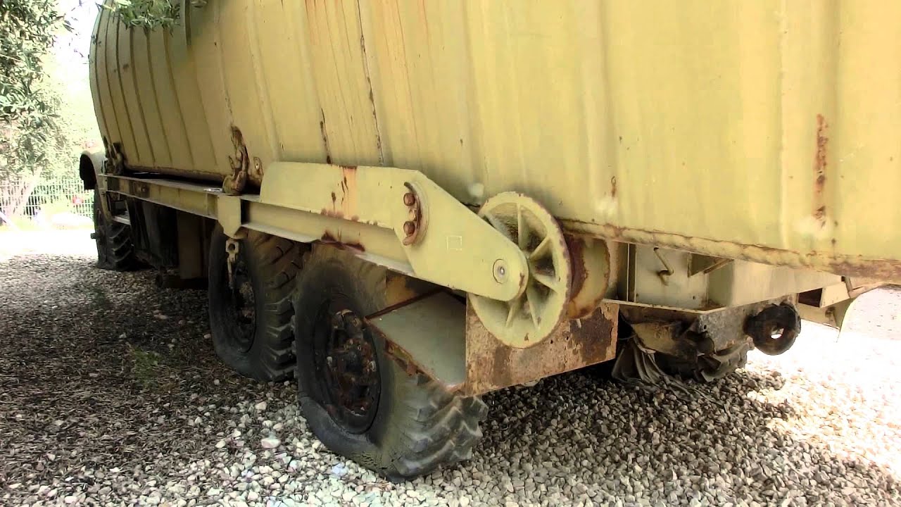

Hungarian truck and shore section in action
The shore end of a shore section, 1:72 model

From what i can gather they used river sections, i can tell if there is a shore section but id have to assume there was. I guess my questions is, how different is the shore section compared to the river section. It appears to be more angular and squared then the smooth boat/pontoon like parts.
and it has ramps on hinges.
side sections narrower
see photos I linked to in my previous post
