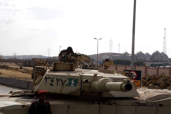

Egyptian M1A1 tanks.

Egyptian vehicles usually have a large number on the turret with a unit badge and number plates on the front and rear fenders
Have you figured out which kit can be used to build the Egyptian one?
I’d figure the Tamiya M1A1 on the low end or the RFM M1A1 - 1991 would fit the bill for the Egyptian Abrams. The tanks are basically downgraded models without the “Chobham” armor. These tanks are locally build under license.
The Saudi versions are M1A2S. So a base M1A2 kit from Tamiya or Academy will fit the bill, unless you want to build an RFM M1A2.
One additional element to add would be the unit mark to the left of the numbers. Probably paint it or custom make it.
is that a red and green flag with a white 7?
It’s not a 7. It’s the numeral 6 in Arabic.
Oh ok
Thank you for the clarification
