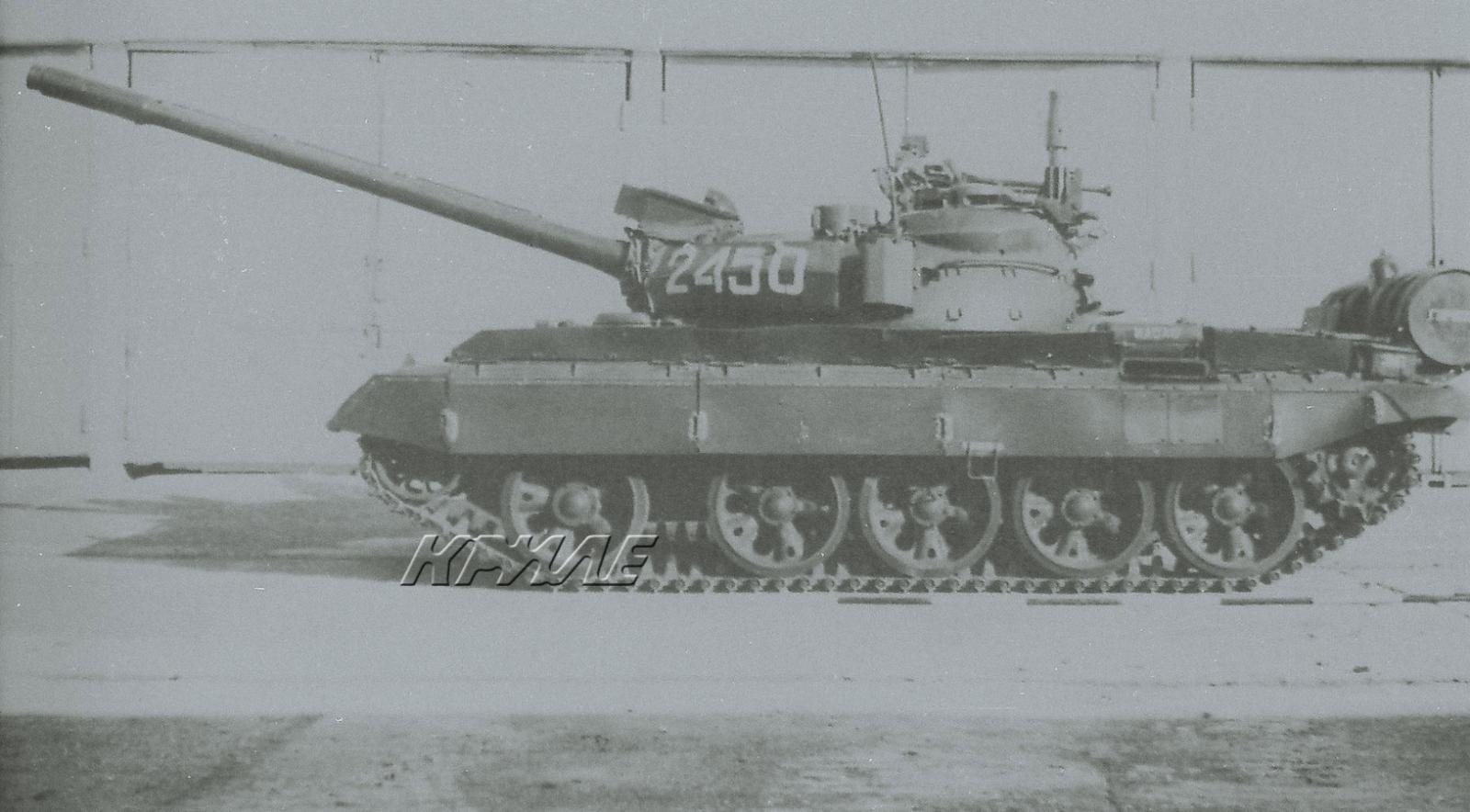

Hi All:

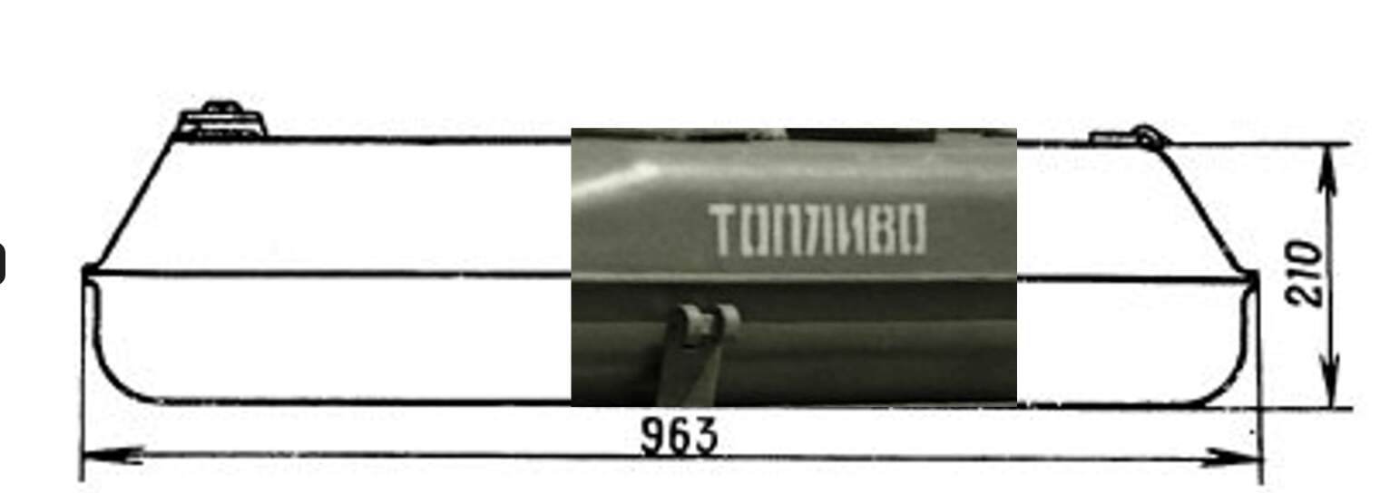

You may have noticed that Soviet tanks often had stencil markings on the fender fuel and oil tanks and spare parts and instruments boxes:
T-62 l.jpg (74.37KiB)
T-62 a.jpg (51.47KiB)
These were primarily on T-54, T-55, and T-62 base vehicles. Does anyone have examples of these or similar markings on German, Polish, Czech, Hungarian, Bulgaria, or Rumanian tanks? Obviously one could simply translate the Russian terms into other languages but my gut feeling is that the satellite countries may have used different terms than the literal translations of the Russian markings.

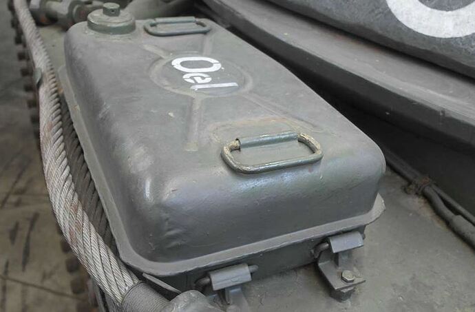

I have seen the fuel and oil symbols used on DDR NVA T-34 cylindrical tanks - DK for Diesel Kraftstoff - and on a Polish tank in the 1990s, “SUPEROIL ***”, (not fully readable) on the small tank above the exhaust port. The Soviets sometimes put the fuel symbol on the ends of the 200l barrels. (DTZ that I saw,but I suppose that DA, DL, DT, and DZ would also be possible.)

Now I get why you also wanted them in black :slight_smile: I could only remember seeing these markings in white (but then, I’m not overly knowledgeable on Soviet/Russian tanks and their markings).
“DK” ( Dieselkraftstoff ) marking on DDR tanks

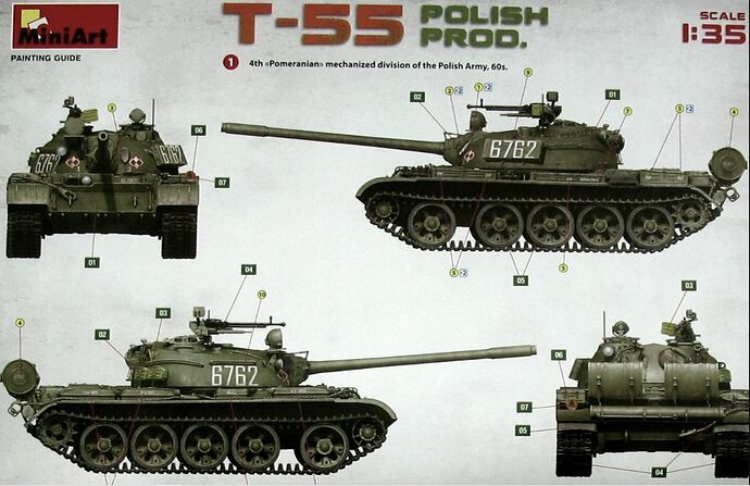

Stencil placement instructions for the Polish T-55

Too bad that the photographer didn’t stand an inch to the side so we could see if the stencil was “ÖL” or a simplified “OL”! :stuck_out_tongue:

Are you saying that the Miniart marking are incorrect to place this at the rear of the left-center ZIP box?

I would assume ÖL — no native German speaker would confuse the two spellings, and I expect German-made stencils to include Umlauts. Or, as H.P. shows, they would almost certainly add an E if no Umlaut is available (since this is what the Umlaut diacritic represents: an e after the vowel that migrated to above the letter in writing).

No, I’m not saying that. Like you can see in the link I posted I meant that this box has tools and probably spare parts connected to the gun, like the gun cleaning rod and the bore brush.
