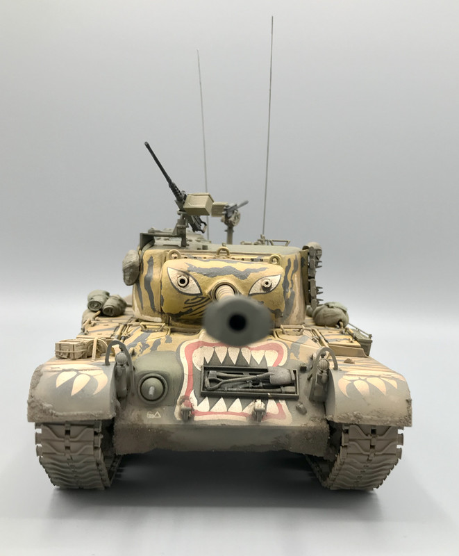

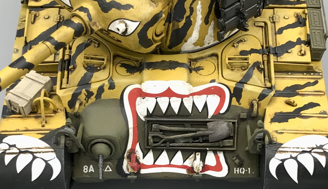

Here is a bit of my work… tools weathered by themselves, but the tank not yet. OD painted tools, with wear on metal and wood areas.
Then once the tank itself is fully weathered… as dusty as the surrounding areas
