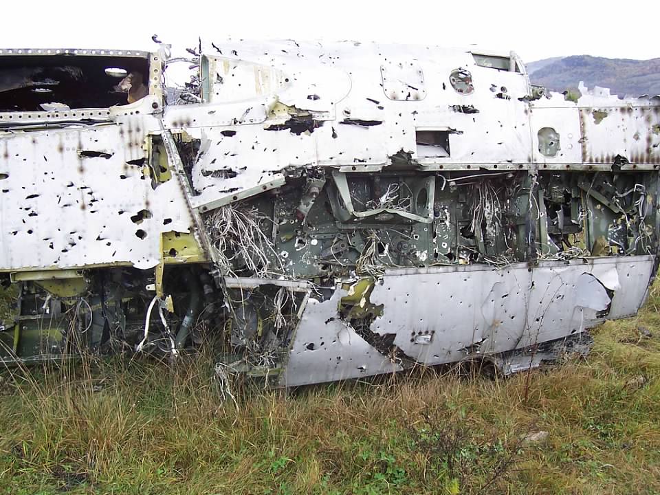

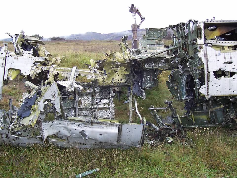

This wreck was a range target hulk that I came across in Bosnia. Per the date plate that I found, it was an F-86D that was sold to the Yugoslavs back in the day.
Anyways, aside from the cockpit area being in Interior Green, most of the rest of the interior was in Dull Dark Green
Area aft of wing
cockpit area and nose gear well/strut
