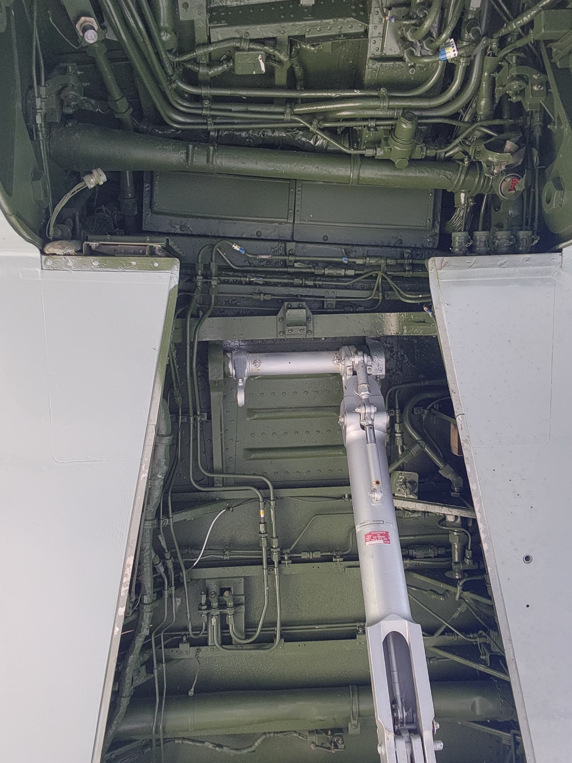

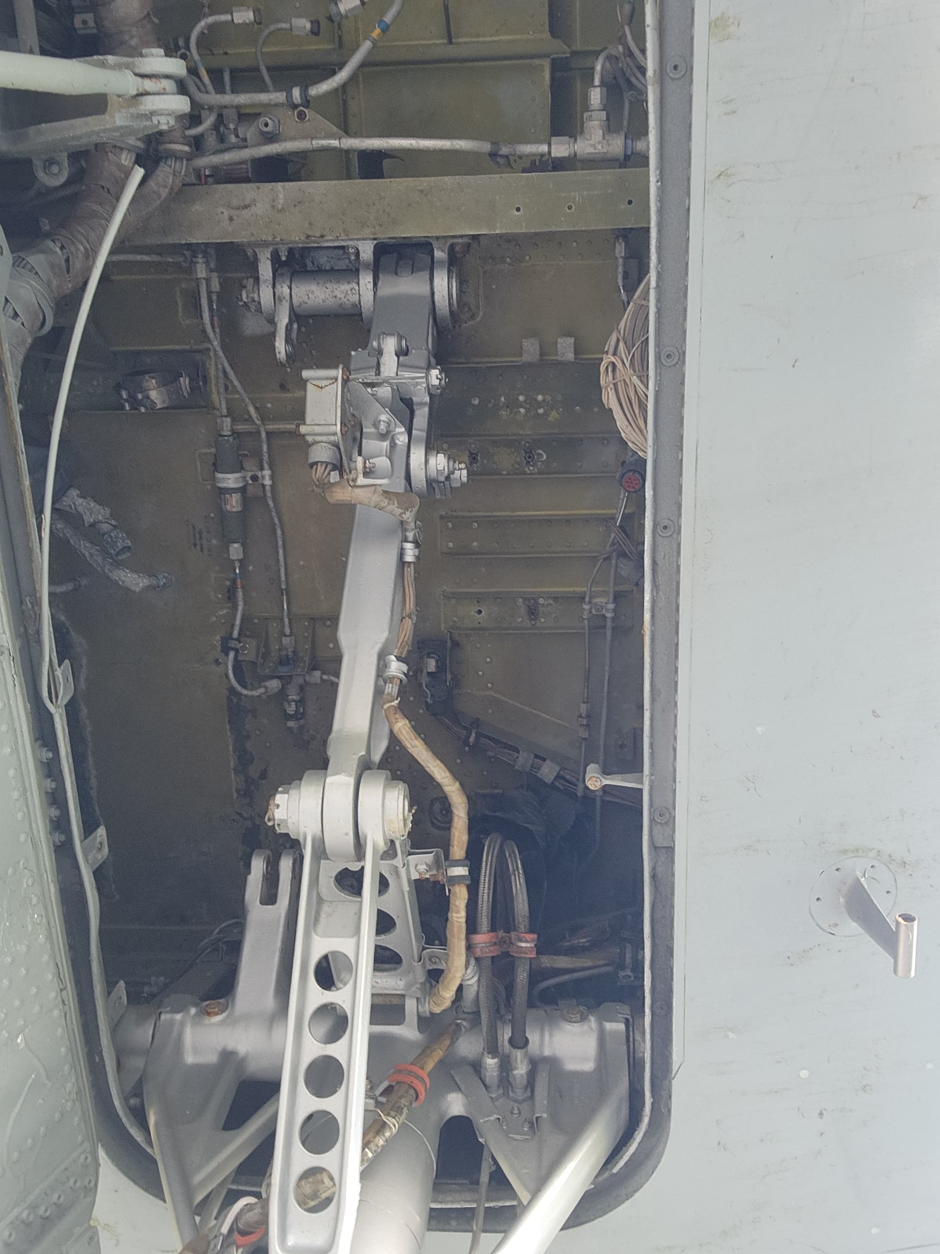

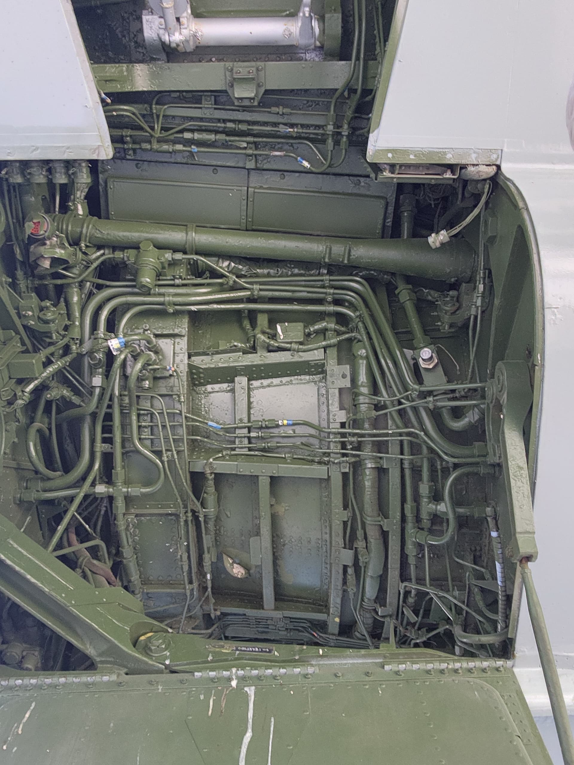

I have the 1/48 Trumpeter kit with resin upgraded wheel wells. I went over to McChord field today and photographed some details of their F106. The wheel wells were a dark olive green. All the hydraulic lines and the well itself. The landing gear was silver. So is this correct? If not, do you have a better set of color photo’s?

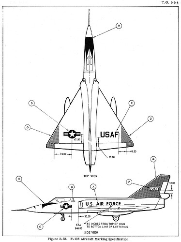

Here are the USAF specs
