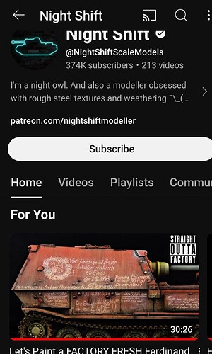

To me faded red often looks like weathered red oxide primer so taking a look at NightShift - Red Oxide Ferdinand maybe of interest.
