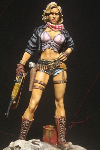

I appreciate that oils are the classic medium for painting figures, but I exclusively use acrylics. If metal, or resin, I prime with white first. Do a complete coverage with a medium tone flesh color. Then build up really thin applications of lighter tones to forehead, nose, cheekbones, jawline, and chin - any raised areas. Then do increasingly darker tones for eye sockets, sides of the nose and under the nose, the area between lips and chin, and cheeks. Observe glamor, and make-up advertisements for shading. It takes a lot of practice.
This is one of my better attempts, and I’m still practicing.
BTW, that figure is 80 mm.

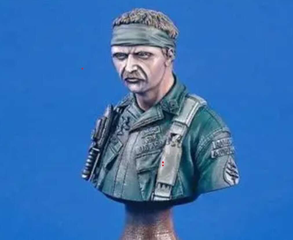

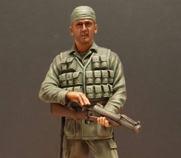

You can’t argue with success. That figure looks far more lifelike, and much better than anthying I’ve ever seen done by Verlinden.
Examples:
I find it’s usually around the frown lines where his figures turn into caricatures. And many are just not well blended.
Your first figure is very well done. The second one looks like a real goofy sculpting. :rofl:

That top figure is very well done, bottom one just needs some work.
Unless one is into sculpting, sometimes there’s not much you can do with paint to fix a bad sculpt.
Ah, but these are Verlinden’s figures as well. There’s no escaping it no matter how you look at it - Verlindin’s Tao was never mine.
