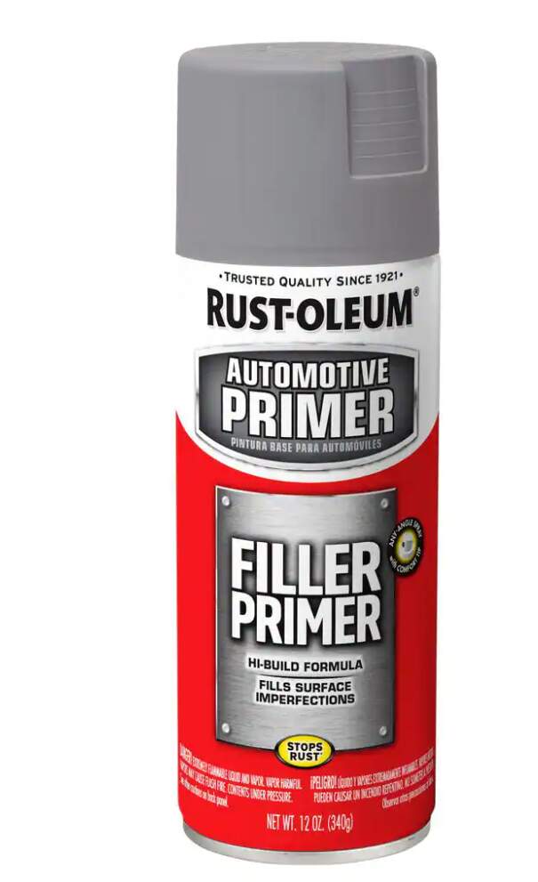

I use various Rustoleum primers. I believe some of them say self leveling or something to that effect right on the can.
Thanks for that. Happy to shell out c$50 for this but I was also wondering if any of the hobby primers would work.
I have heard that Mr. Surfacer can be used as primer and filler for these kind of small imperfections, but I do not have direct experience.
I have Tamiya primer. I use it for priming my locomotives as they usually have many different colored components. It seems very fine - I dont know how well it fills. Plus one can is 100ml.
A can of Rustoleum is 340g and costs about the same, and I know the Rustoleum works.
@ 18bravo. Which Rust-Oleum Primer? Can you be more specific?
—mike
Through my experince, an automotive filler primer will be your best choice. However, it may leave the surface gritting feeling and can only level the surface to a point.
