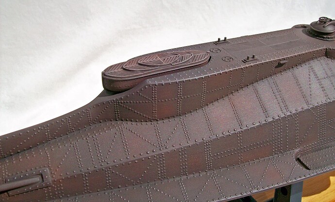

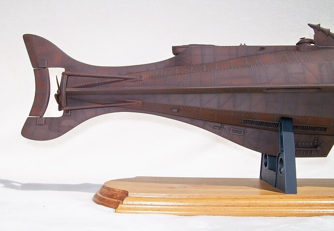

Fellow Modelers,
Below are photos of 31” (1/69 scale) Disney Nautilus from the movie “20,000 Leagues Beneath the Sea”. I bought the kit in 2001 from a company called Sci-fi Matters. It was advertised as “20K Submarine” and did not reference Disney, Nautilus or the kit’s designer Scott Brodeen. It is a resin kit with a few of the smaller parts out of white metal. The parts had great detail, but required a good deal of “elbow grease” to achieve a proper fit. A lot of minor repairs were required to fix scratches in the upper and lower hull castings. I wound up replacing over 1,000 rivets (with 5-minute epoxy) that were lost during sanding. The base color was mixed per the instructions (black/gray/rust) which created a dark chocolate color. After it was applied, various shades of rust were added with an airbrush and pastel sticks. Finally, it was dry-brushed with Model Master Light Ghost Gray. I hope you enjoy the photos.

Robert_Goldman-Thanks. There have been a number of very poorly done resin and vac-form Disney Nautilus kits issued over the decades. I know because I bought several of them myself and ended up throwing them in the garbage! Currently there are 16", 31" and 48" size Disney Nautilus resin kits available for purchase that are nicely detailed and accurate. However, since they are resin you will have to do the extra work that resin requires to get a good looking model-and shell out the money.

tomschry-Thanks! The Pegasus Nautilus has a lot of raised detail that is well suited to this paint scheme and dry-brushing. Please post photos when you build yours.
