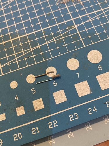

And with that I’ve had the first break of an item off the sprue as forecast by @brekinapez .
Break and solution;
I hope this kit isn’t a fighter. Although it has already thrown the first punch.
