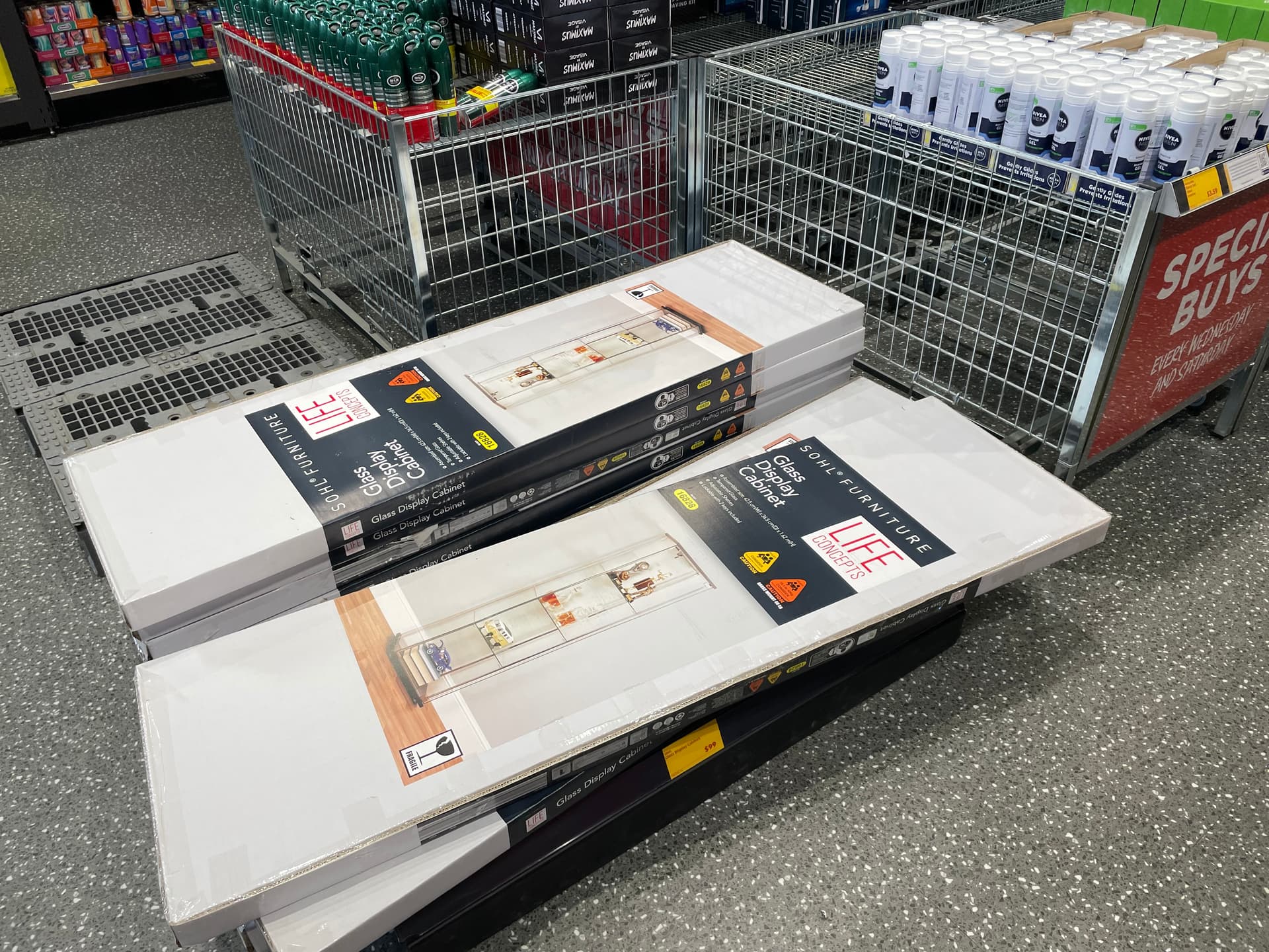

#01 - I bought my SOHL display cabinet at Aldi (Australia) but all the trendsters on the internet rave about the IKEA Detolfs:
