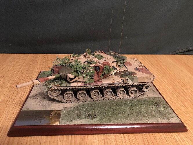

You might be able to get decent results using etched leaves from such as Aber for example. They do need a bit of work and I normally thicken up the “flatness” of the branches with Mr Dissolved Putty; they also require extensive twisting and even grouping/cementing together to ensure enough “mass” as it were.
Here’s a few shots of my MBT 70 and T64s using such a method; some of the images do betray the 2-dimensional aspect but those shots are those that are larger than the real thing in any case. You will get an effect of sorts, but it is laborious.

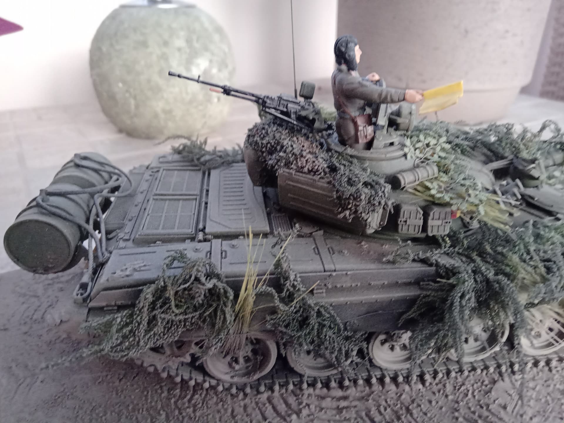

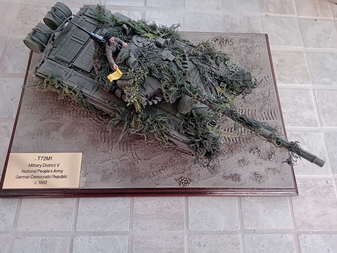

I’m in danger of over-egging the pudding here but here are a few views of an NVA T-72 with a mix of camouflage types; I’ve used etched leaves, paintbrush bristles and real plants (moss) to try and get that fully camouflaged look. The inspiration was from a picture in this book, showing some T-72s fully scrimmed up barrelling along a track.
I used stretched sprue to depict the wires along the hull sides then just glued the camouflage material onto that. I was hoping the moss would depict something akin to fir branches but upon the application of paint it just curled up, however, I obtained an effect. I believe the answer when using real plants is to process them using diluted glycerine; I plan to try this at some time in the future
