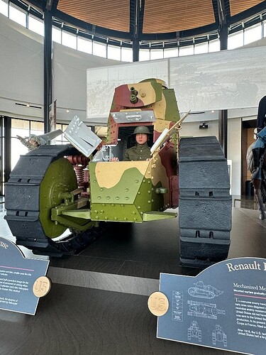

Q: can the dome on the top of turret cupola on the FT-17 be opened like a hatch? I found a photo of then major Patton posing in front of one that seem to show it askew.

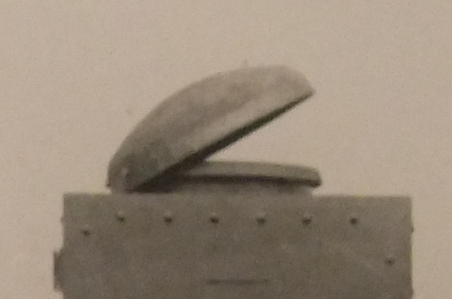

AFAIK this dome could be open. Some period pics show it damaged after combat…Maybe it was just an air vent ![]()

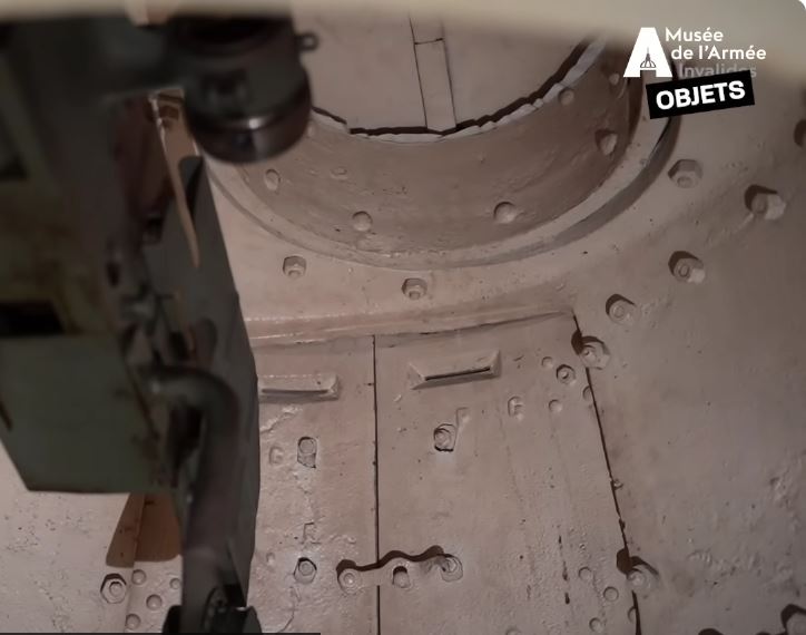

Interior view (no visible hinges though…)
I think the hinge is on the outside, in the space between the overhanging rim of the dome and the cupola wall

And what are the two “nubs” on the outside of the “lid” for that can be seen in Frenchy’s last pic? Might well be bolts holding a hinge under the overhang, I think.
The photo with the lid open gives me the impression that it’s hinged for observation only: with it open, the commander can look out over the top edge of the part with the vision slits, but it can’t open far enough to actually get out through the top. As Ken says, there’s a door in the rear of the turret for the commander.

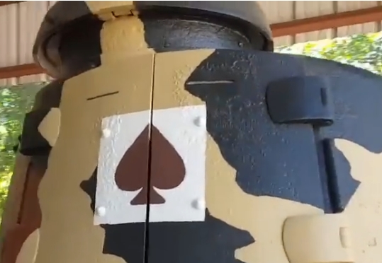

The hinge can be seen here.
