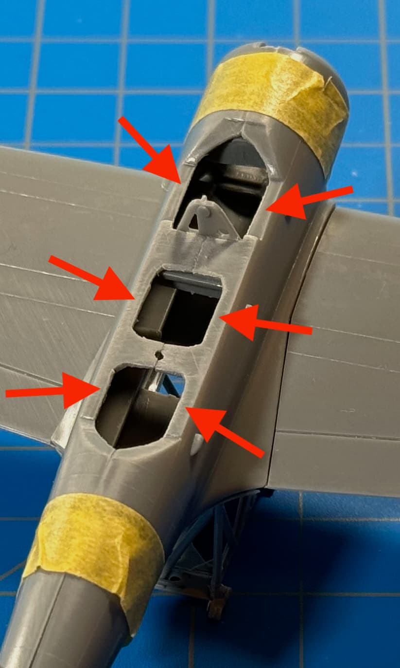

Newbie to aircraft modeling here.
I’m this far along with the build…
I was thinking of trimming these thick edges and perhaps adding some faux cockpit detail before joining the fuselage halves together and before attaching the canopy. If all goes well, the canopy will be opened-up (see reference image).

Thoughts? What say ye? TIA.
—mike
As I recall, you have a aftermarket canopy, correct? Then I would probably trim as the canopy is most likely thin/thinner than the kit canopy.

Yup, aftermarket canopy is in the mail. Ryan, that’s a great link — just the kind of references I was looking for! … Time for chop-chop! :hocho:
Thank you, sir!

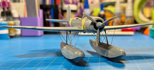

Went for it… :hocho:
Thank’s again for the input!
—mike
Already looking better. :+1:
Those look much better! Nice work!
