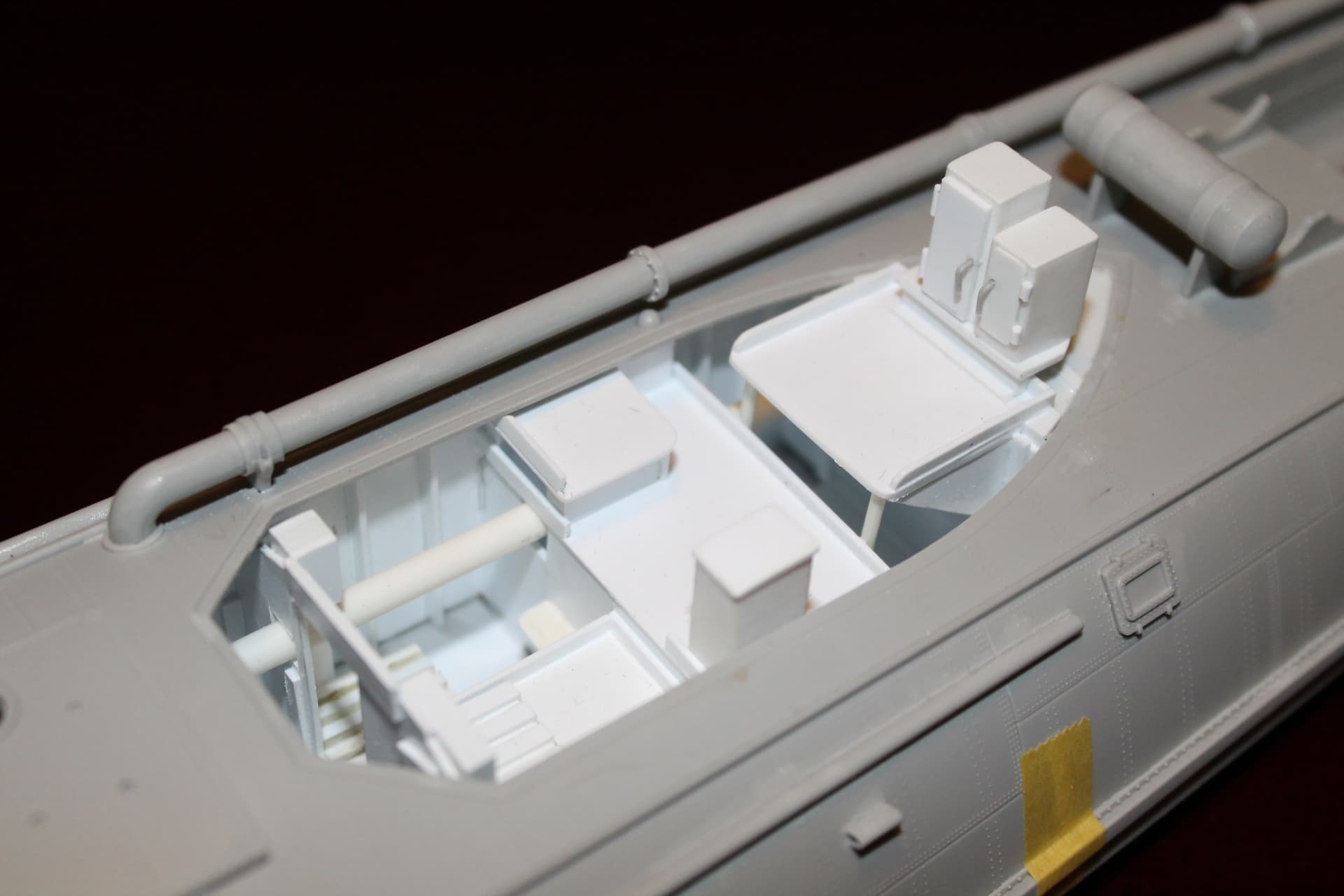

I had started the Merit version a few years back and found references few and far between. I picked up one booklet and that had few pictures of the interior. I cobbled one together using what few images I could find. But I make no claims as to accuracy.
The layout is generally correct, but I did have to use a bit of artistic license for some details. Hope this helps a bit.
That looks good. ![]()
Thanks for the information/photos.
Glad to help.

Good looking interior.
