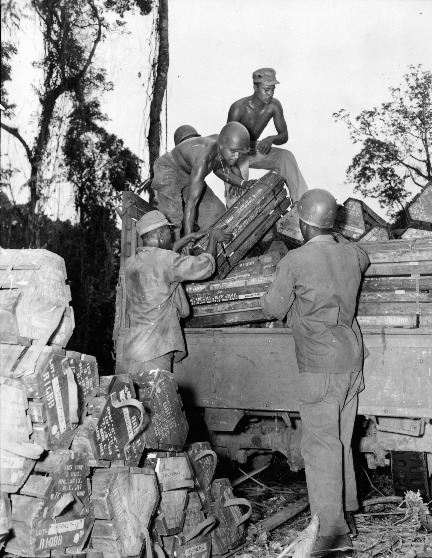

Can someone identify this truck in use by the 93rd Infantry Division ? This division had used the Chevy.
Not exactly a lot to go on there! My guess would be a CCKW based on the attachments on the axle - a Chevy would have had leaf springs visible in that pic.
Also, it has a Timken split axle as fitted to half of all CCKWs, with that big flange around the diff. Chevies used an axle similar to the “corporation” axles on CCKWs where the casing was a single piece with the rear face a separate part for access to the diff gears. So it’s a CCKW in that pic…
Banjo axles.
Yup, that’s he nickname for the GMC corporation axle!
