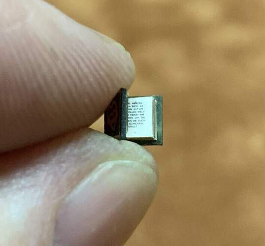

This scale makes my eyes hurt and my hands tremble. Reminds me of this when I think of the work you are doing.
Time for the Coke can scale before I move along.
Thanks for that photo, Sprocket - it is so easy to forget just how small 1/700 scale actually is…! ![]()
