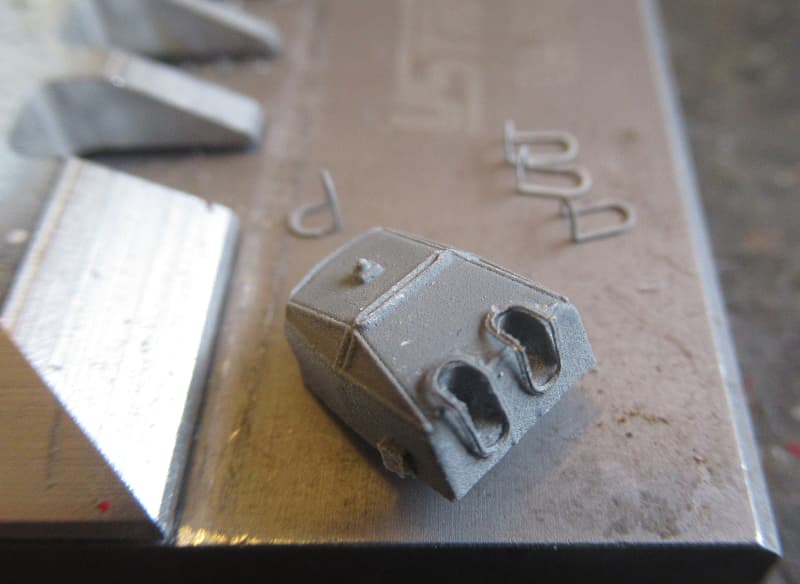

the secondary armament now, the guns have pe canvas frames around each trunnion, bent to 90’ then adhered and pushed flush against the front of the turret

overview showing all six secondary turrets fitted.
