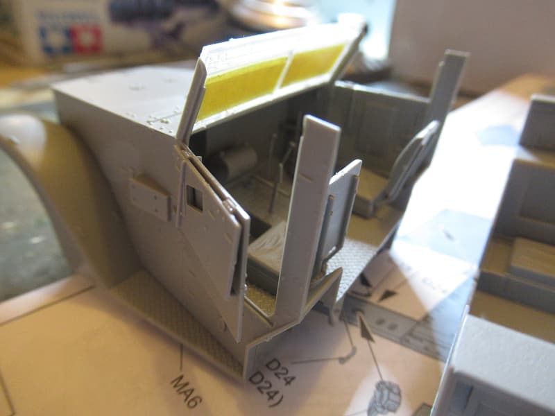

drivers door left half open in the rush to abandon the vehicle under fire.

Chassis to body test fit. I’ll leave these dry fitted for the time being as painting the two apart will be a lot easier.
Progress looking good. One thing though – your windshield piece is glued too high. Its upper edge should meet the top of the side posts. See my pic below
Outstanding build. You’re really dodging all the bullets on this kit and doing it right. That’s the way to get it perfect - gluing the body together off the frame. This is going to finish up into a fantastic model.
There are issues, and I’m sure the windscreen piece part E1 are the same for this and the M16,
However, these small bulges at the foot of the piece suggest wiper arm swivels that rest on the bonnet edge preventing E1 from being mounted lower down, unless these bulges are superfluous, and I can trim them away.
Took E1 out again and it has a bevel on the bottom edge, when I reversed it it fits far better, so I had it in back to front.

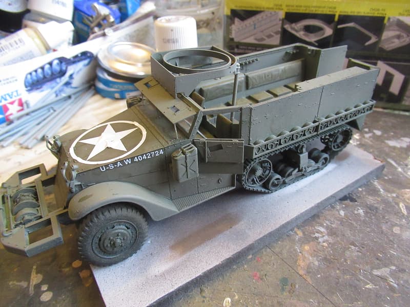

so far the winch cable and chain, both provided in the kit. Nice touch by DML.
Painted in white primer, I can’t fit the supports for the front visor as the windscreen masks are still to be peeled off.
Looking good.
One observation: The headlight and guard positions should look more like this. HTH.
Image for reference only.
—mike :hammer_and_wrench:
Thanks Mike.
the turret fit isn’t that great, it wants to mount too high on the windscreen so that it slopes to the rear, the Bonnet decals are a wait and see, I may still use a mask and spray one.
The decal next morning, as that hasn’t done it’s job, I’ll be scraping that off and preparing a mask to spray a big white star on there.
a spray painted one will look superior in every respect, Later, for now this Halftrack and the five Germans are going into the to do box, as there is a 25 pounder Field Gun calling me from the stash.
