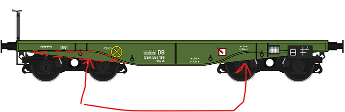

Compare with this image:
That wavy line (marked with red at the left end) is the original lower edge of the SSkra waggon, the reinforcement has been welded on to the old lower edge.
They don’t have to be based on older rolling stock to be reinforced, Just like to one in the B&W photo above.
OK,
what I meant was that one type (SSys) was built back in WW II with a heavier frame (the models you showed)
another type was built lighter (SSkra)
https://forums.kitmaker.net/uploads/default/original/4X/3/7/9/379085900d282844415dbd2723f38727422a9983.jpeg
and these were later reinforced, call it modified if you like, to get a higher load capacity.
Clumsy sketch by Butterfingers:
The red line is the original lower edge of the SSkra
