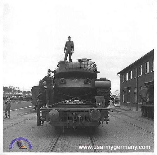

Frank Rolin and Bill Pitkin inspect an M-48 tank loaded on top of
an SSys 55 flat car at the USAREUR Transportation Center at Rhenau, Germany.

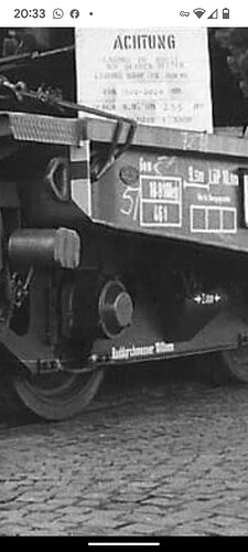

From the little research, I have done, the only visible change, would be the change from oil bearings to grease on the wheel hubs.
No oil filling port, for modern ones.
Old.
Modern.
