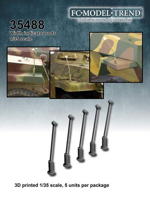

If you mean the width indicators like these, then as has been said, the Kubel did not have them.
If you mean another vehicle, then yes, there are AM Parts available:
