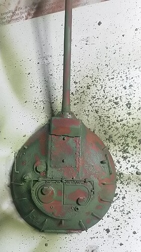

Yes, I use salt for chipping.
Very pleased with the result.
