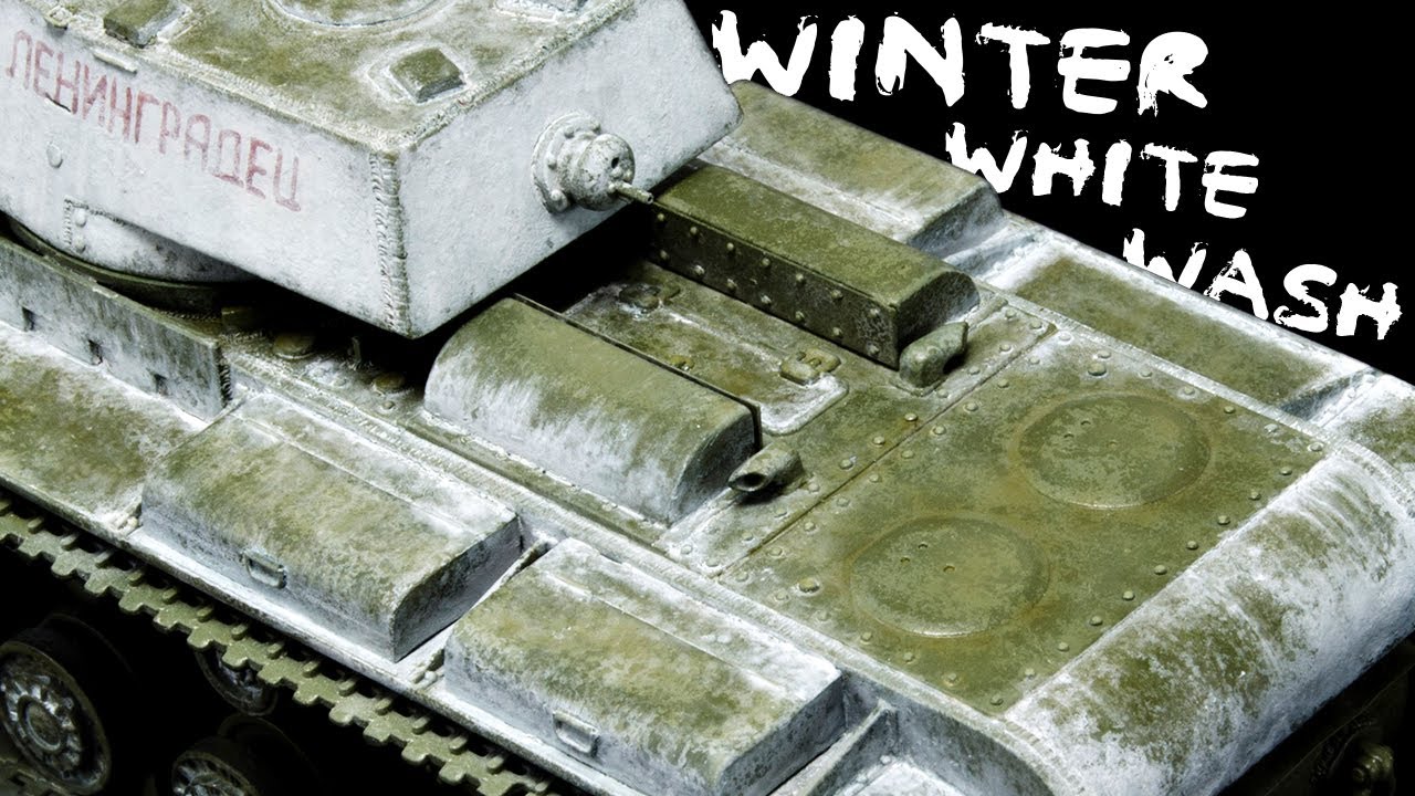

This might help you

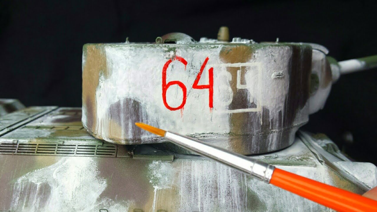

For added whitewash fun, AK makes a washable white paint that you can slather on after for a more drippy look.
