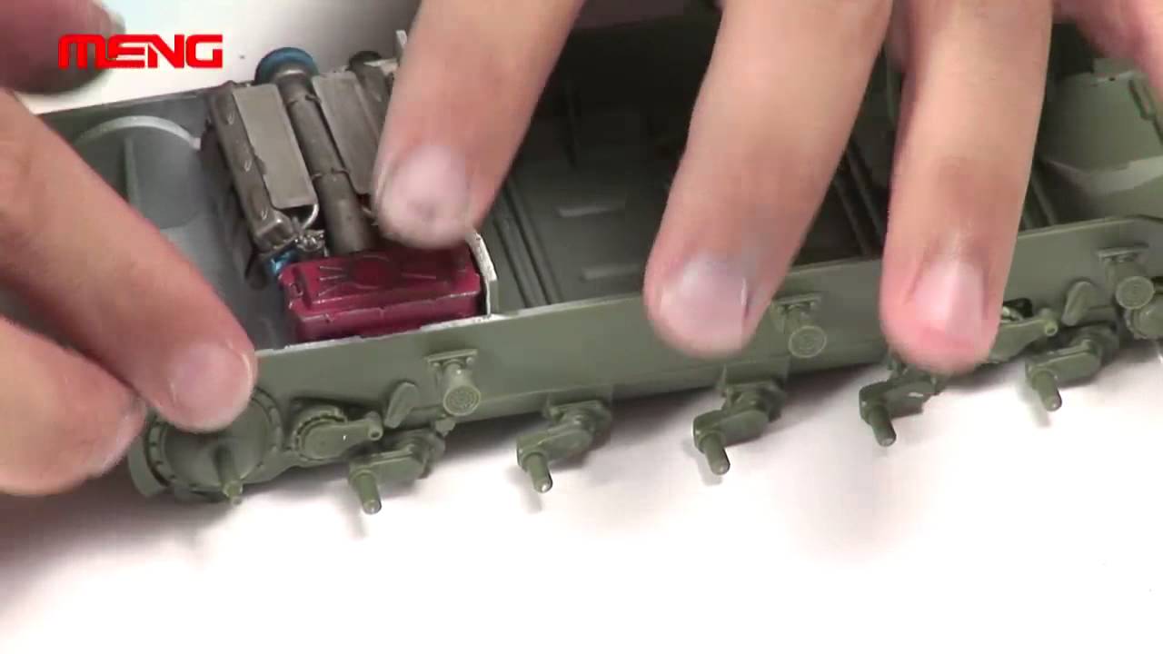

Engine is completely assembled…
And fits into the compartment without problems.
By looking at a few details; the previous builder was no slouch and was doing a really good job until he stopped and decided to quit this build…
Lower hull is there and complete.
all wheels contact the table; that’s good.
