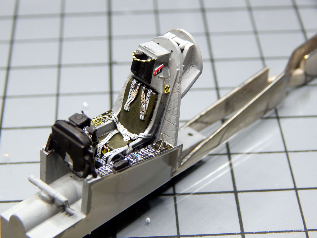

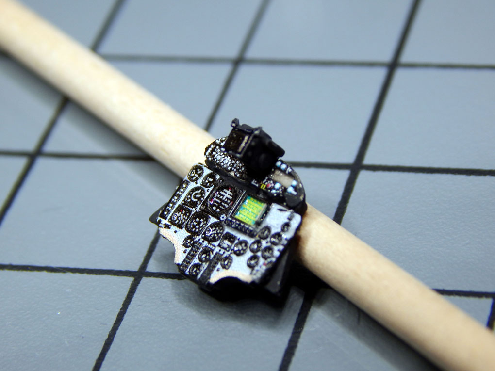

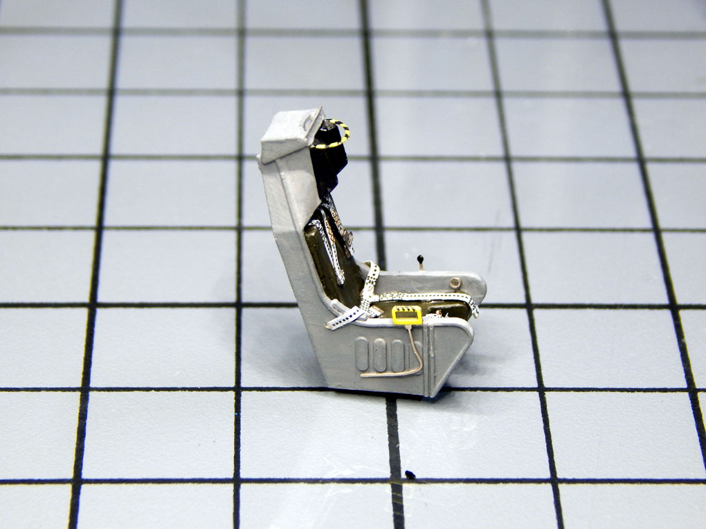

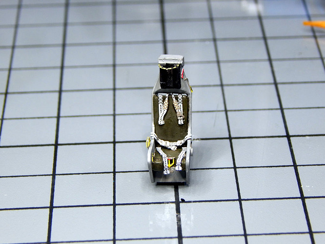

As usual the first section to be built is the cockpit. The ejection seat was the first to be tackled. The kit seat is six parts but the photo etch detail set has twenty five parts. After removing the kit levers and handles I replaced these with the photo etch replacements and painted the seat. I added the seatbelts and warning placards to finish off the ejection seat. The instrument panel was sanded down smooth and the photo etch sections were installed. I used clear gloss paint for the gauges and displays to replicate the glass faces. For the cockpit tub I sanded down the side panels and replaced them with the photo etch ones. The kit pedals were cut off and replaced with the photo etch versions. The control stick, instrument panel, and pedal assembly were installed completing the cockpit. I then prepared the inside of the fuselage for the cockpit area.

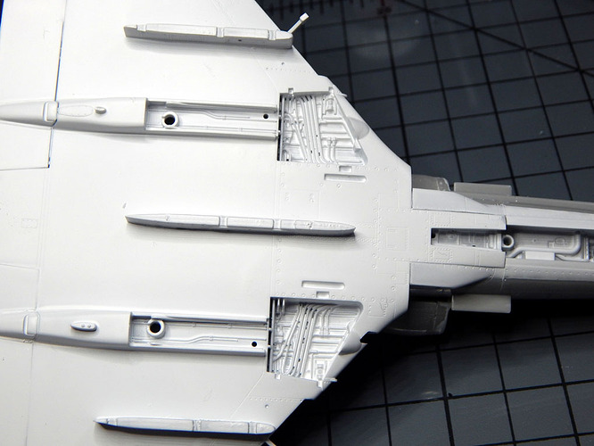

I still need to detail the nose wheel bay and the rest of the inside of the fuselage and engine area before I can close up the fuselage. I am hoping to have the fuselage closed up by the end of the week.

Nice! The only thing missing from the seat detail is the “headknocker” lever pulled down to safe the seat on the ground

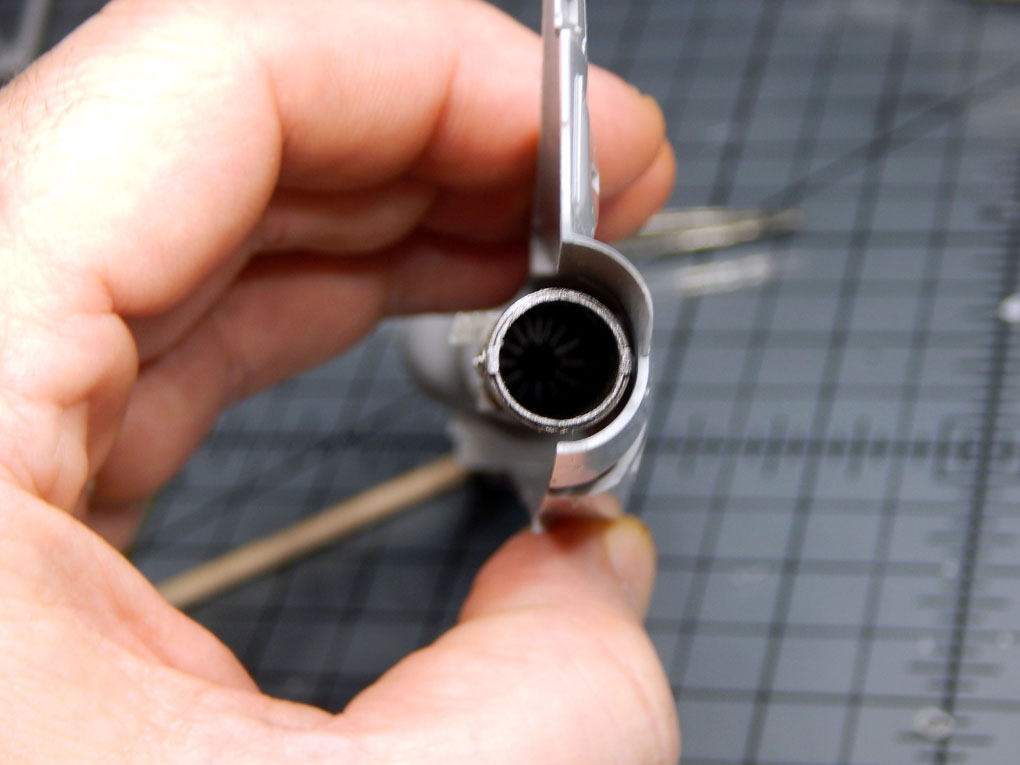

The second week of the A-4M I assembled and painted the intake and exhaust. These were then mounted into the fuselage along with the cockpit tub. The fuselage halves were assembled and the intake ducts and nose cone were installed. The nose has some antenna pods which were mounted. On a side note I added 0.4 ounces of weight inside the nose cone so the aircraft will sit correctly on the landing gear when completed.
I then assembled the main wings and the hard points on the underside. The wings and the fuselage were then masked off. For the nose I scanned in the painting instructions and scaled the nose section to match the model. I then made a template for the curves on each side and trimmed the kapton tape to replicate the correct curve. Once aligned I then painted the underside of the fuselage and wings with white. After the paint dried I installed the wings to the fuselage.

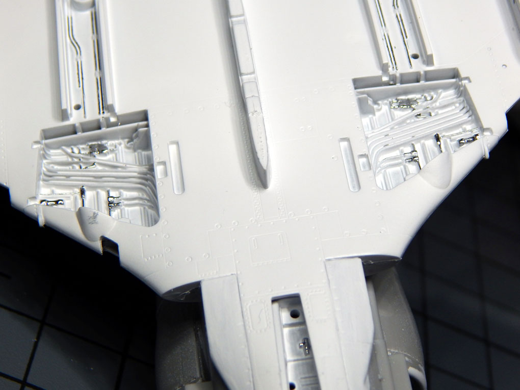

I am now detail painting and adding some more details to the main and nose wheel wells for the landing gear. I am hoping to finish the wheels wells and to detail the landing gear before the Thanksgiving holiday.
