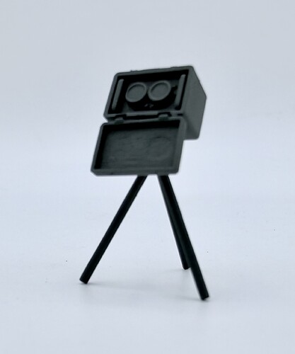

I am building the Dragon Hawk Missile kit and have reached the painting stage. One item in the kit is stumping me, since the directions are no help, and I can not find any reference photos, the remote firing launcher control unit.
Does anyone have a photo that shows colors of this item, particularly the internal faceplate? Or do we have any former Hawk missileers here who remember the colors of that item?

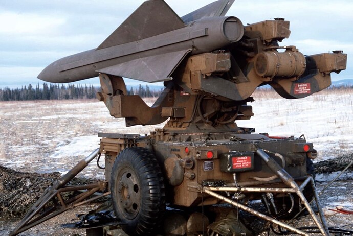

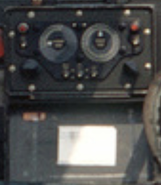

Here is my guess on what you need.
That looks to be the box with the red label on the front of the trailer in the photo below
But the set up looks quite similar, so Iโ€™ll say close enough for government work. Thanks for the photo.

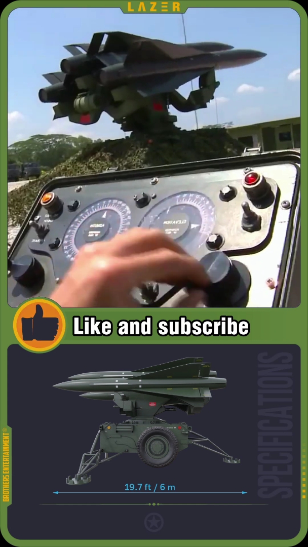

I got a screen grab from a random youtube video.
That kinda looks like CGI or a video game, but thank you.

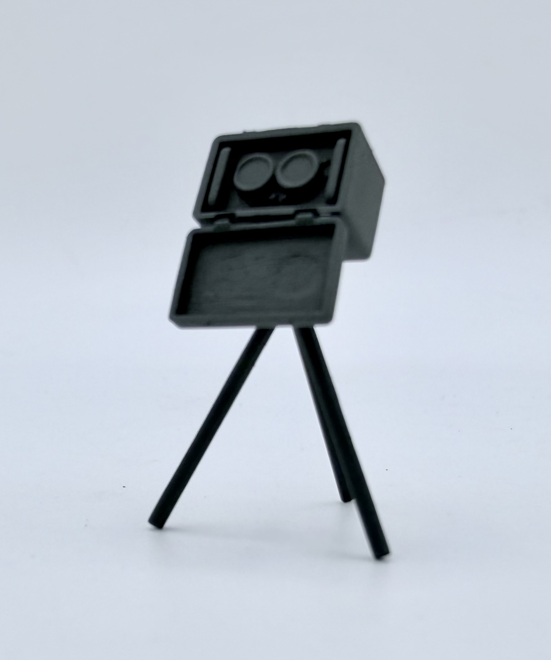

This:
is not this:
The AFV Club item was discussed here. Whether the DML part is supposed to be the same as the AFV Club item and they messed it up or itโ€™s supposed to be a different item is unknown.

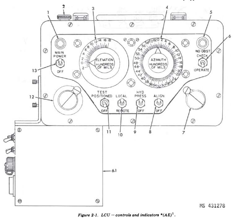

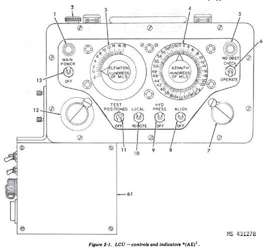

Additional info on the AFV Club item.
(Item 6.1 is the Communications Unit, mounted in a different arrangement.)
